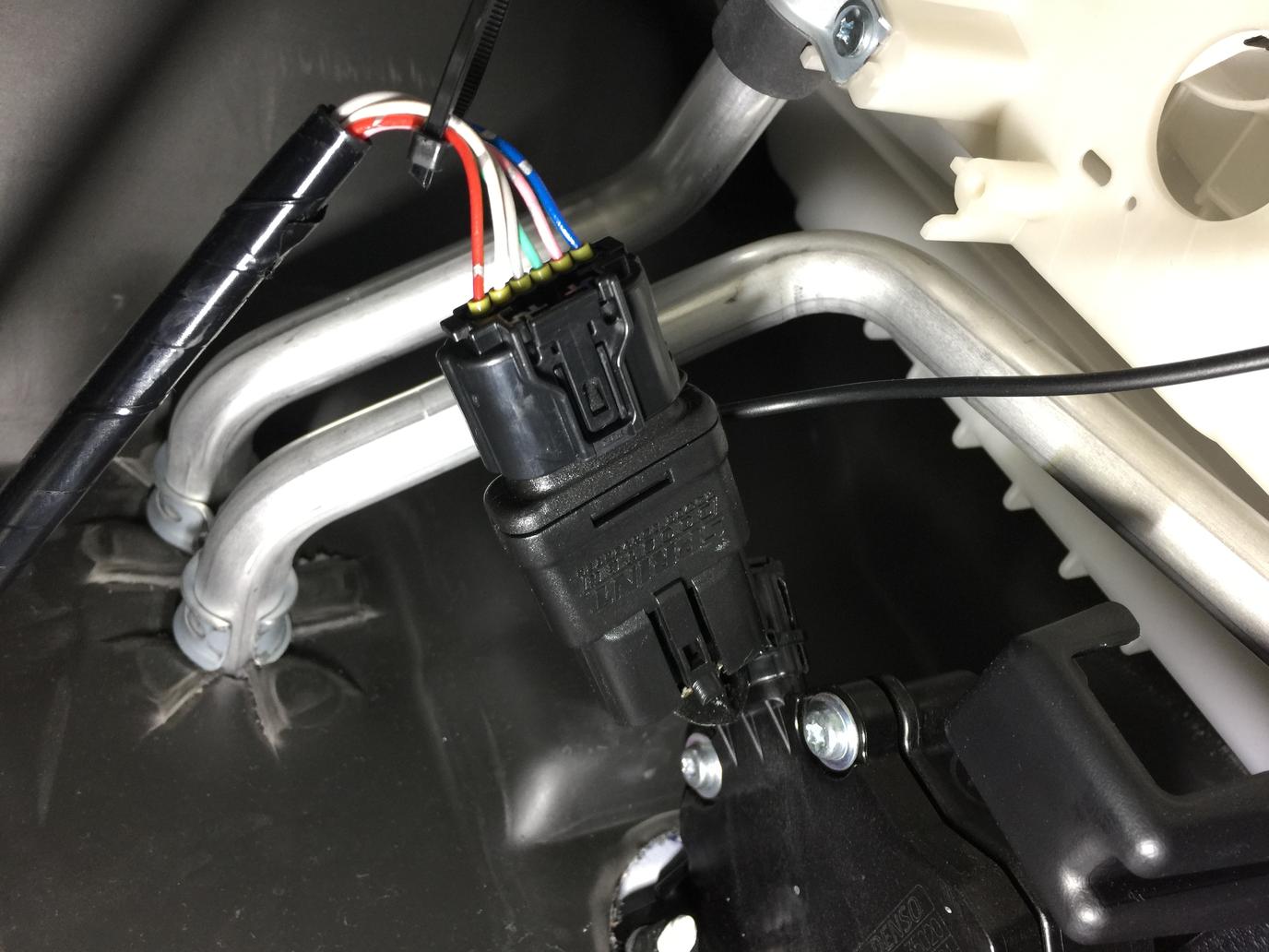

Quick question... how do you disconnect the harness for the accelerator? Looks like the clip is on the back side but I'm not sure what kind of clip it is. Couldn't tell by touch.

It's a bugger to get off, if I remember correctly it's a center release. You have to squeeze it pretty hard, took me a few attempts.
Still can't seem to get that mofo out.
A better look...you push down on the very edge closest to the wires, this will raise the center "clip" enough to clear.
Perfect - thank you! I tried snapping a pic with my phone earlier but it was a tight fit on the right side of the pedal and i couldn't get a good shot. Ill give it another try this week.
