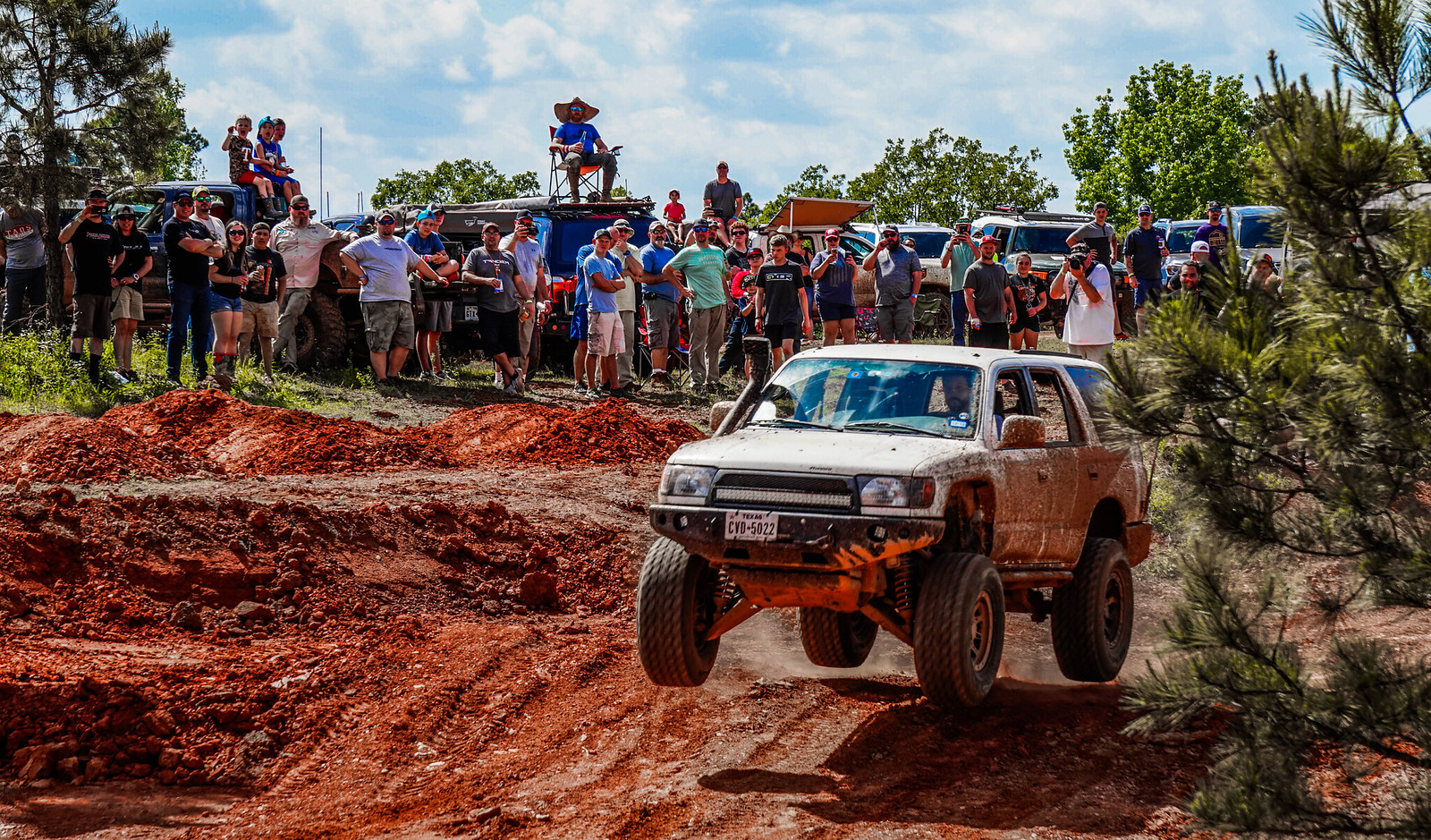

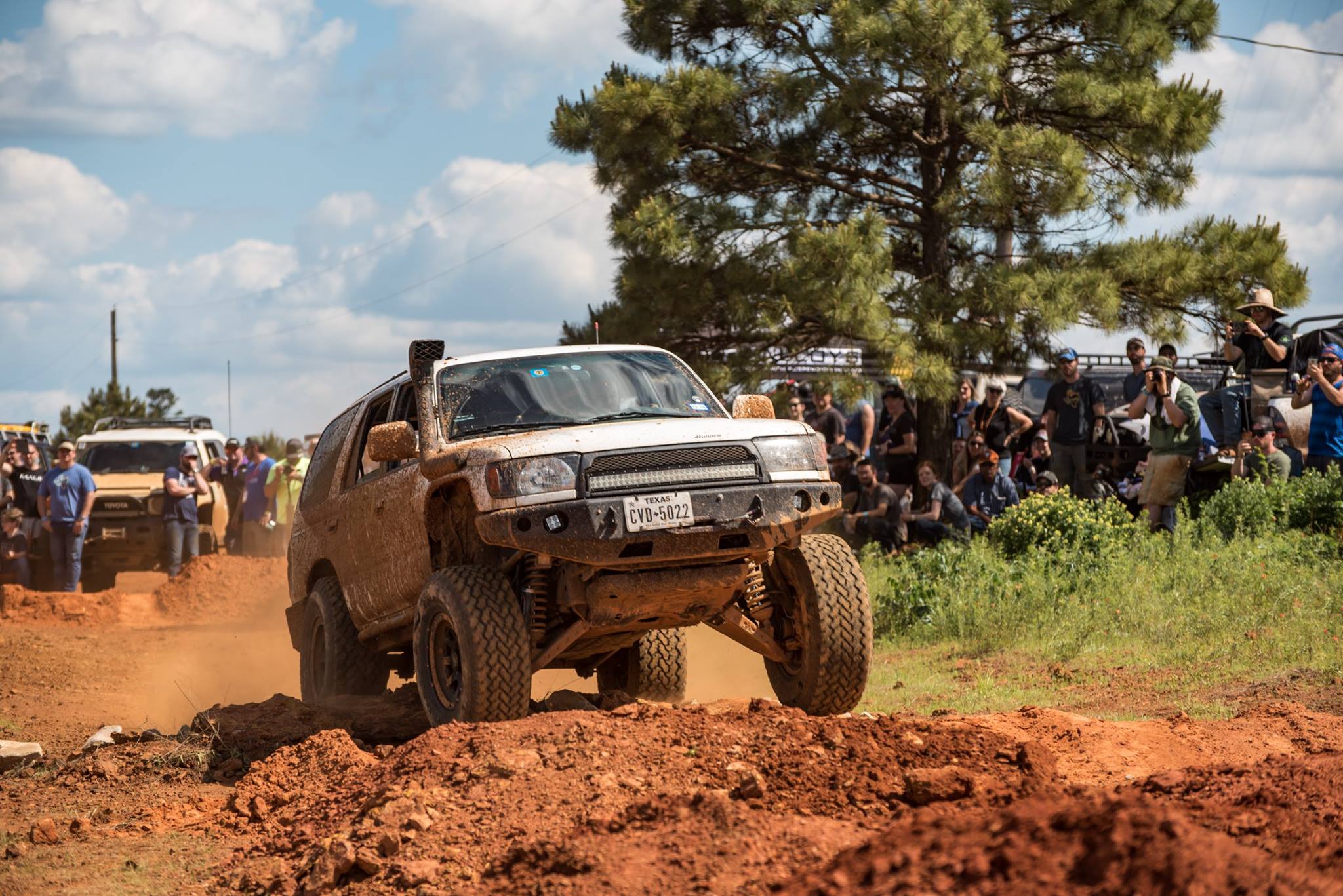

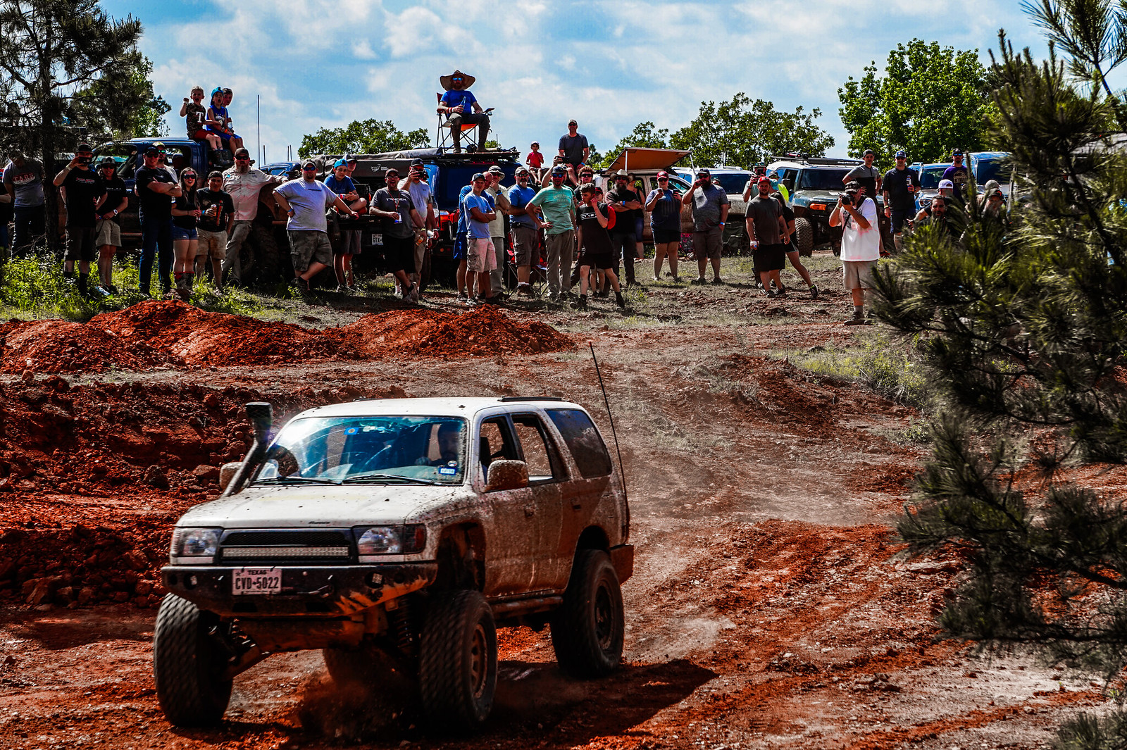

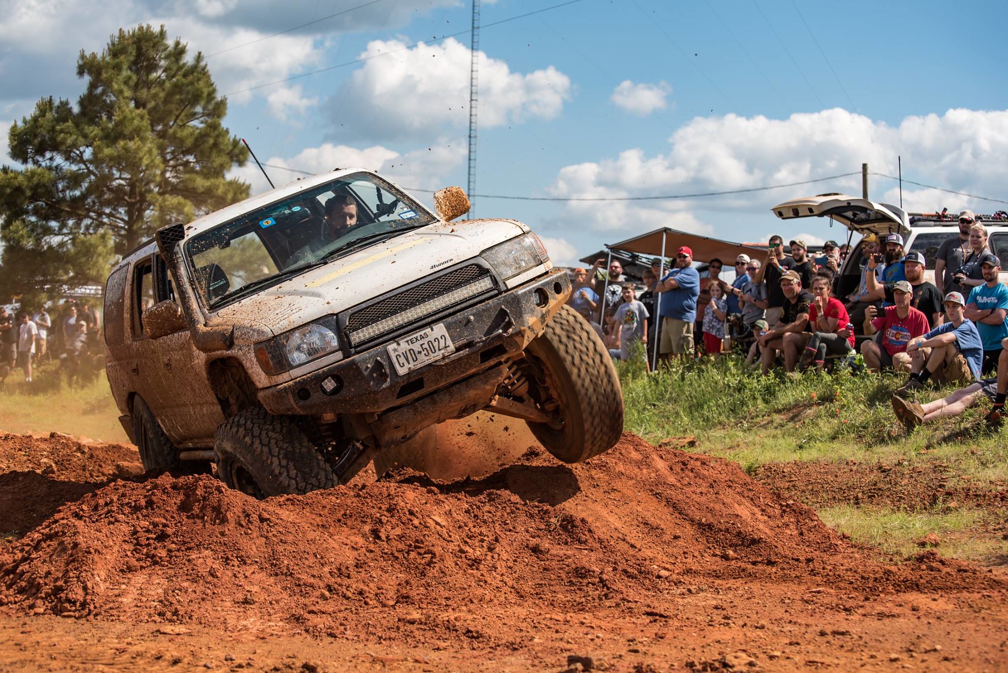

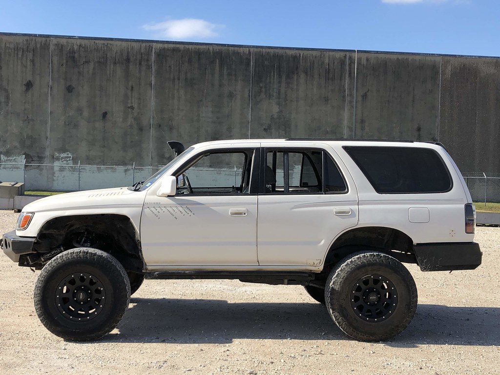

This first fun race was a blast! The 4Runner earned a solid 2nd place, with the final time 0.2 seconds behind the winner. :guitar2:
Carnage:
1. One CV boot slid out of socket. That was ziptied back to normal (no tearing)
2. One Cam bolt adjusted during the moguls. Cam bolt was moved back to correct alignment. Still driving today with zero issues.
3. One Reservoir's mounts broke, but they were only zipties anyway (hadn't figured out a good spot to weld the reservoir mounts yet). Ziptied back on with no problems.

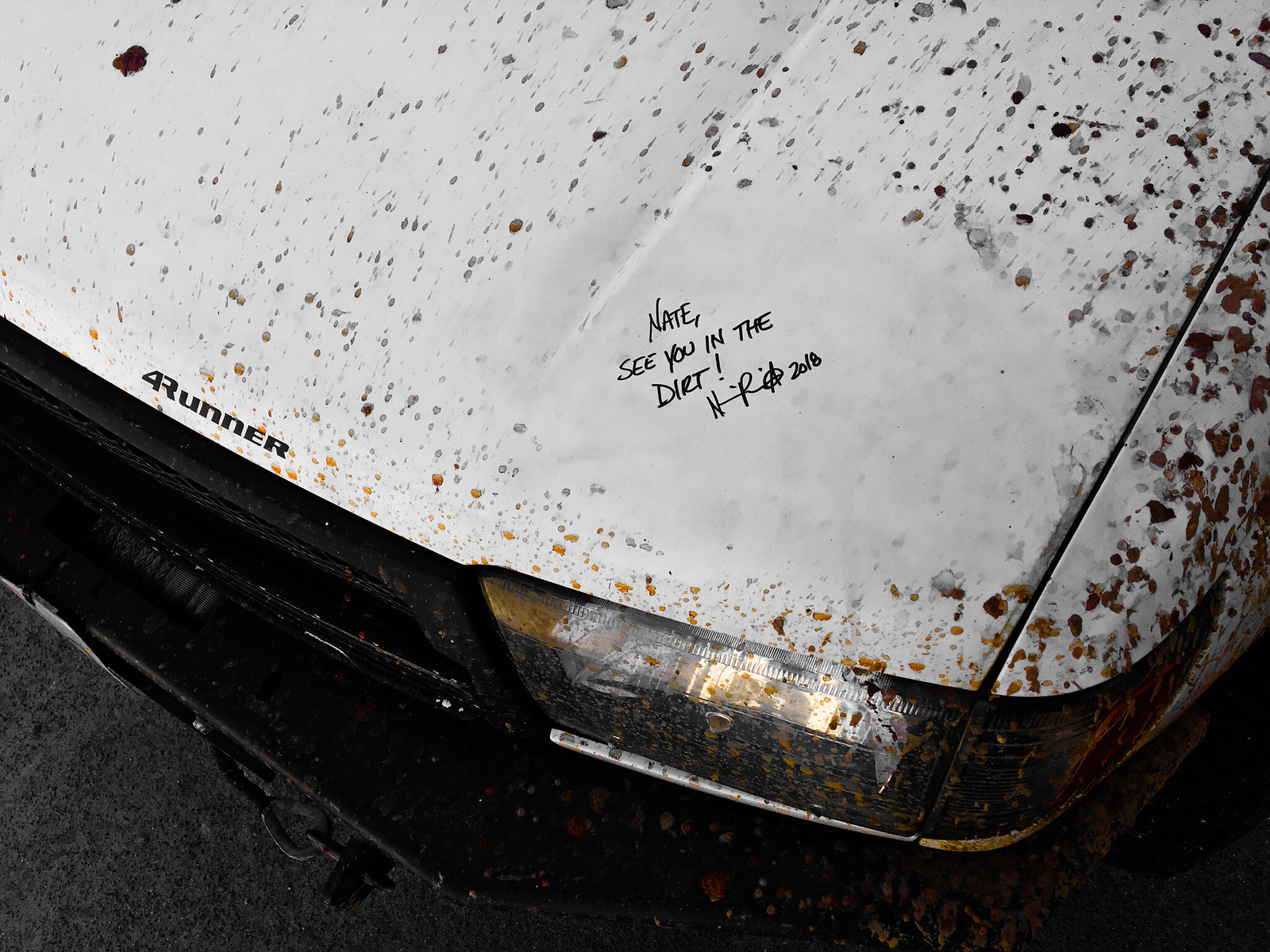

P.P.S. Nikki from Total Chaos signed the 4Runner! Heck yeah!

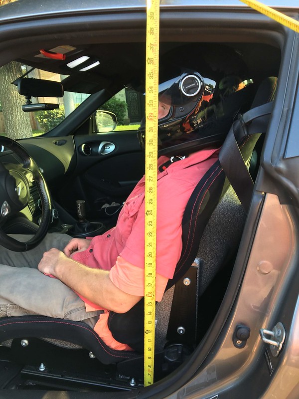

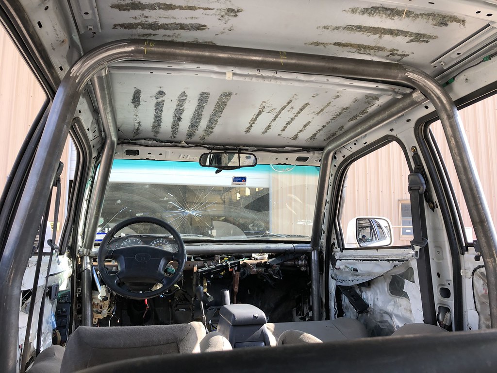

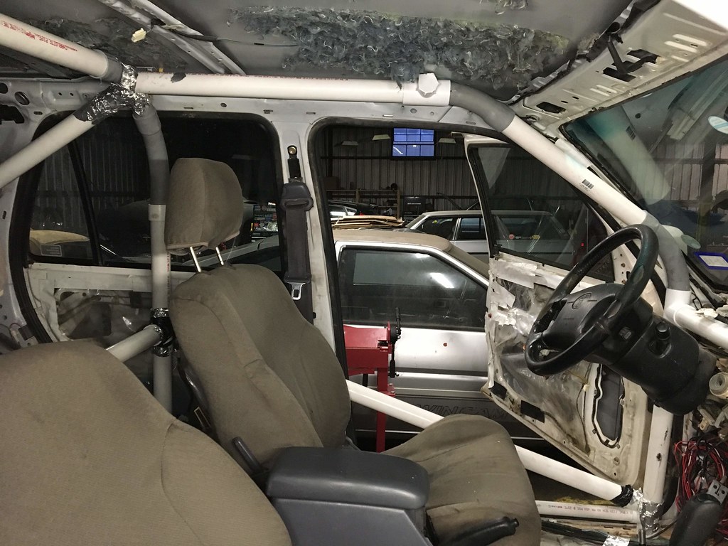

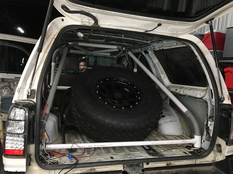

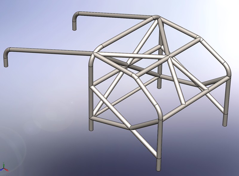

After the good feedback from Jambo, I am proceeding with the design of a roll cage. The intention is to have it certified to Score in order to race the Baja 1000. It's in its infancy right now, many diagonals need to be added, but PVC piping does a great job of simulating the bend radii required in addition to the tubing dimensions. The shapes will go right into a solidworks model for FE analysis and manufacturing.
That, and it's time to shop for race seats, so I'm trying to sit in as many brands and models as I can before going to be fitted for one.

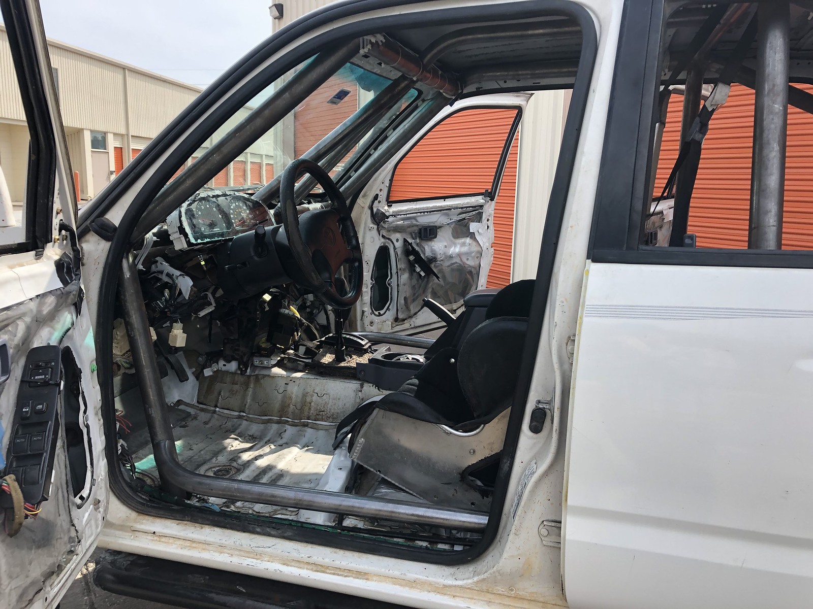

Here's the photos from fitup today.

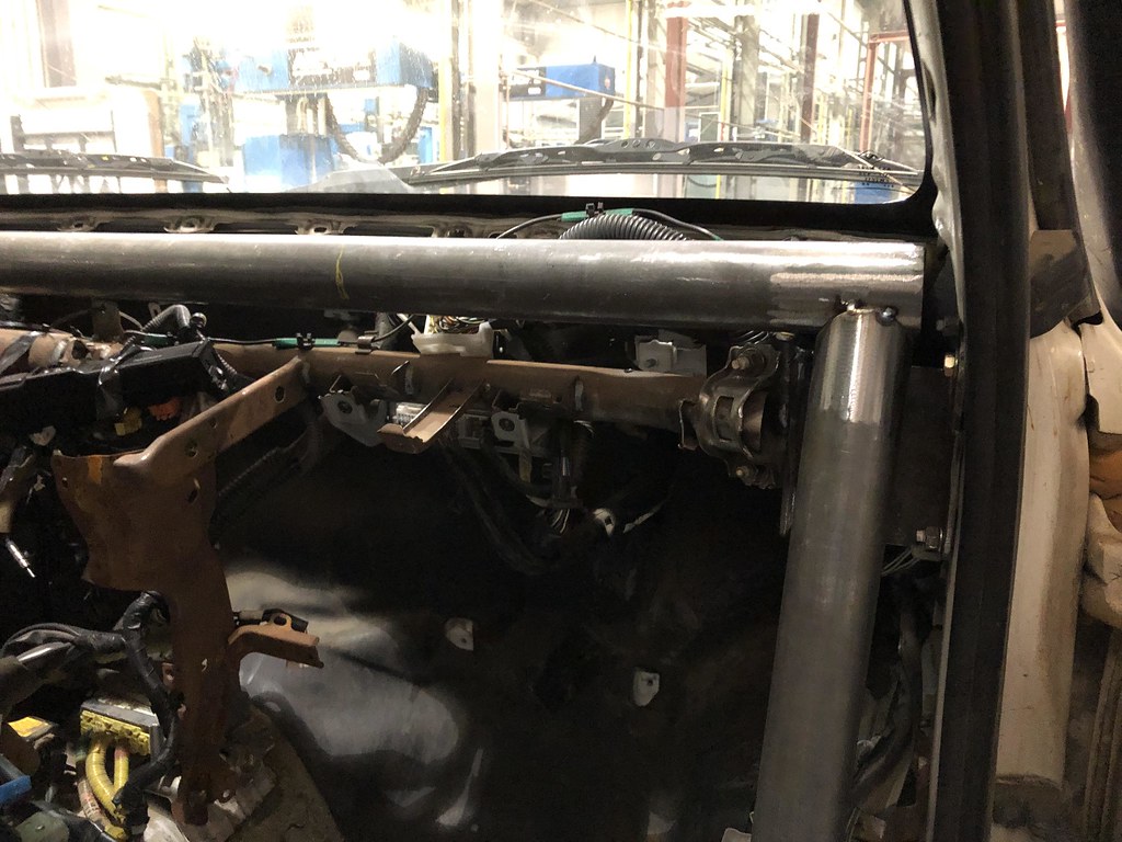

A Pillars and B Pillars tacked together.

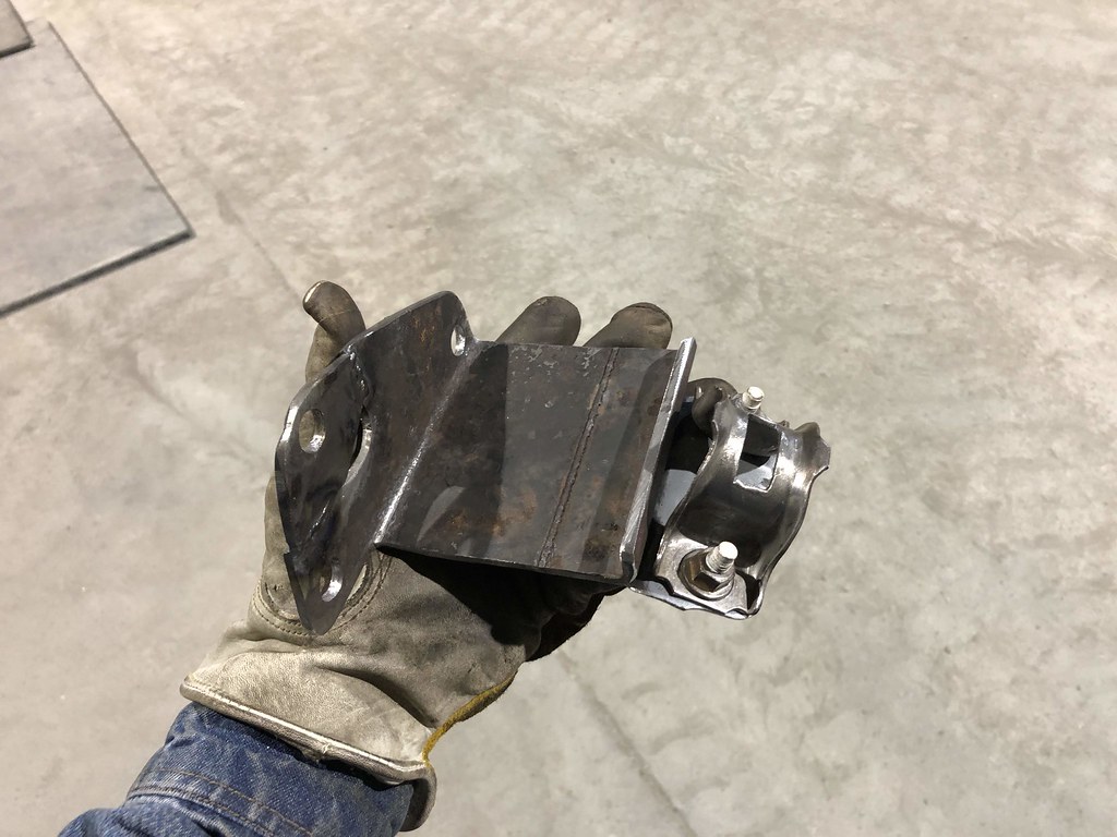

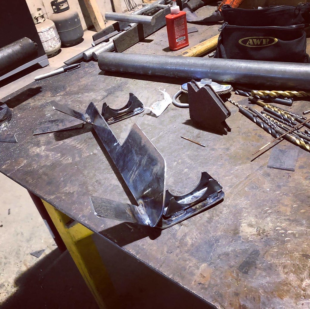

Made a offset mount for the dashbard's cross bar, so the front cross bar can fit.
Image of mount.

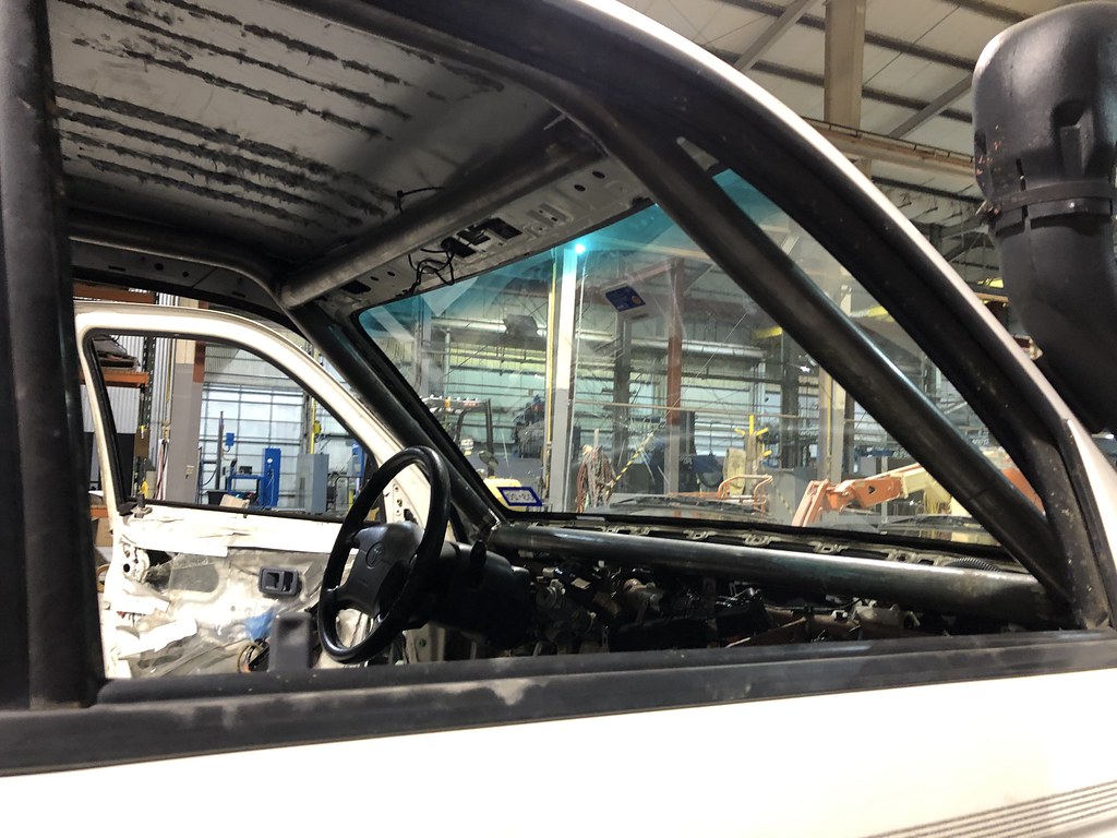

Current photo as of this afternoon.

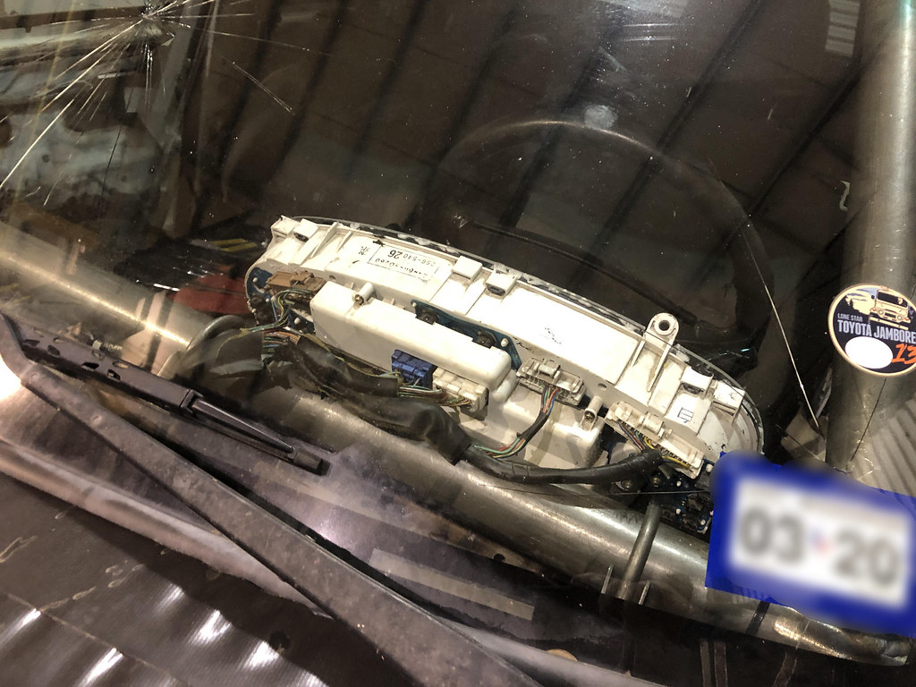

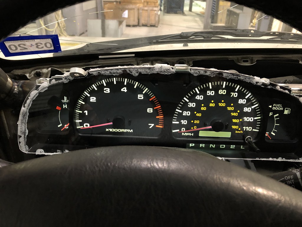

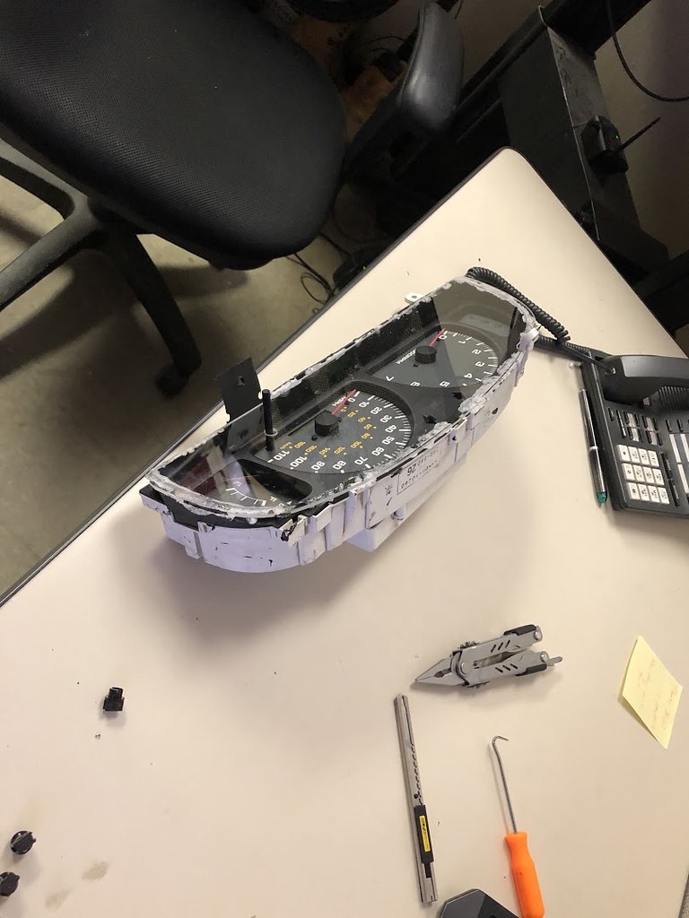

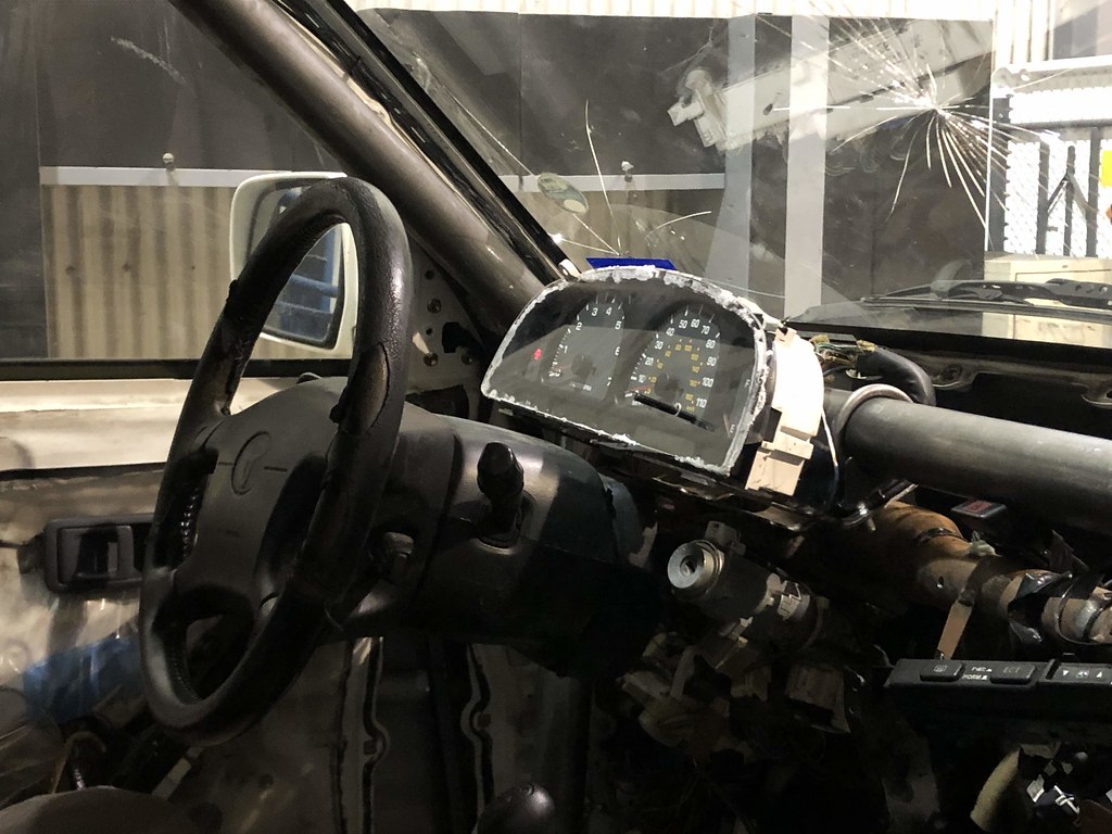

Since there's a cross bar in the front, now the gauge cluster needs a new home.
It's all really rough at this point, but I trimmed the black molding of the cluster, and glued on a plexiglass sheet. That way, it sits in a smaller footprint. Now onto mounts. I changed out burnt out bulbs with LED's in the meantime.
google photos don't show on the forum, you have to use imgur or another host, your build is epic btw :jaw:
Gauge Cluster Mount. I decided to make it bolt on so I could adjust it's position.

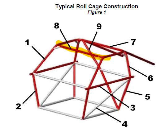

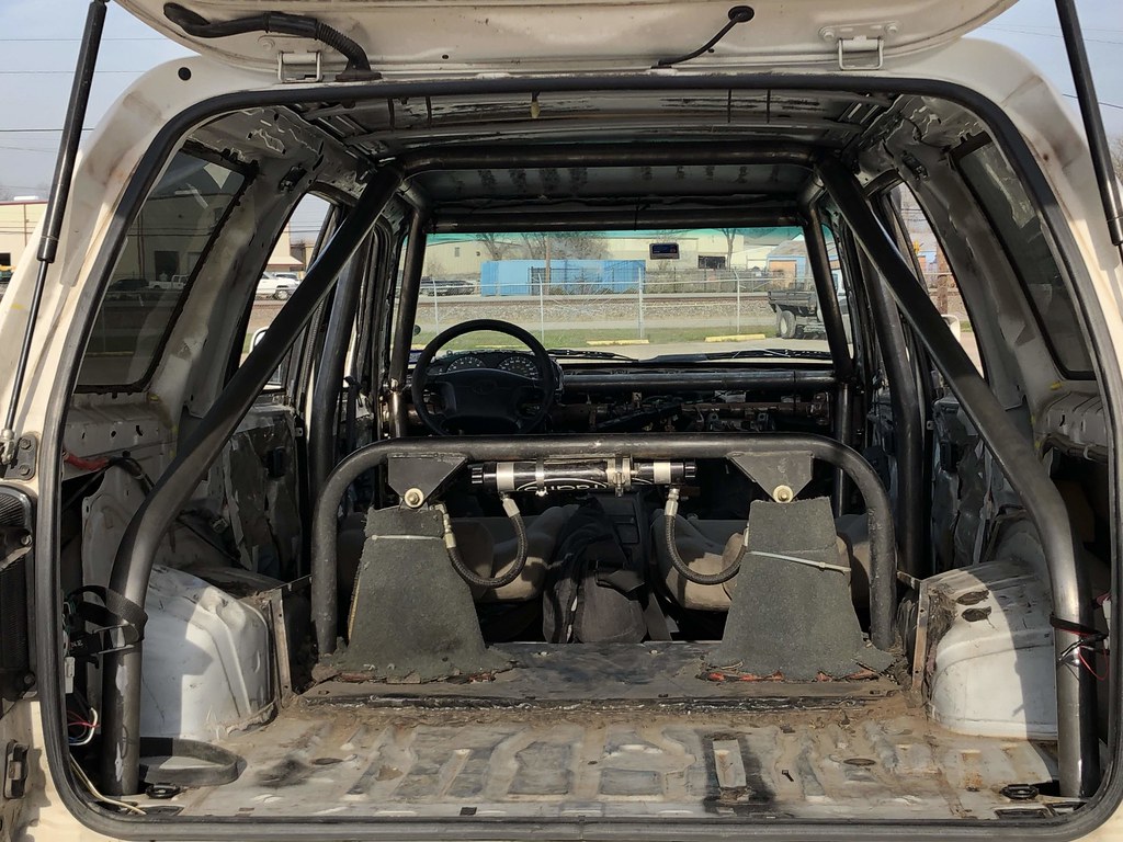

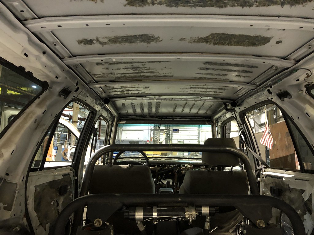

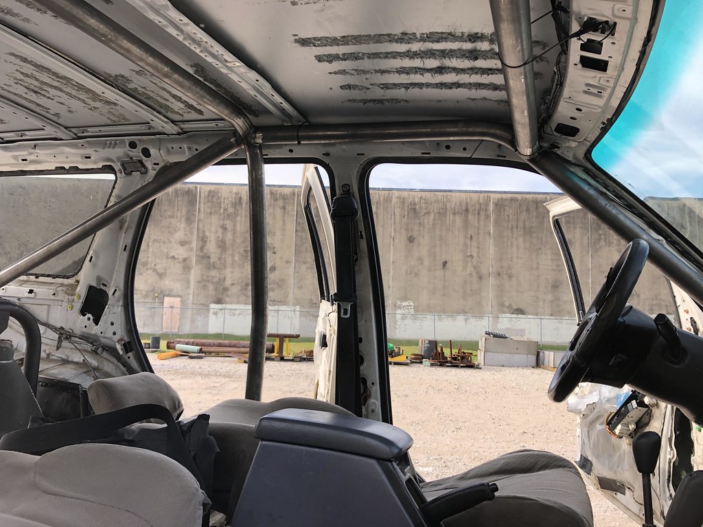

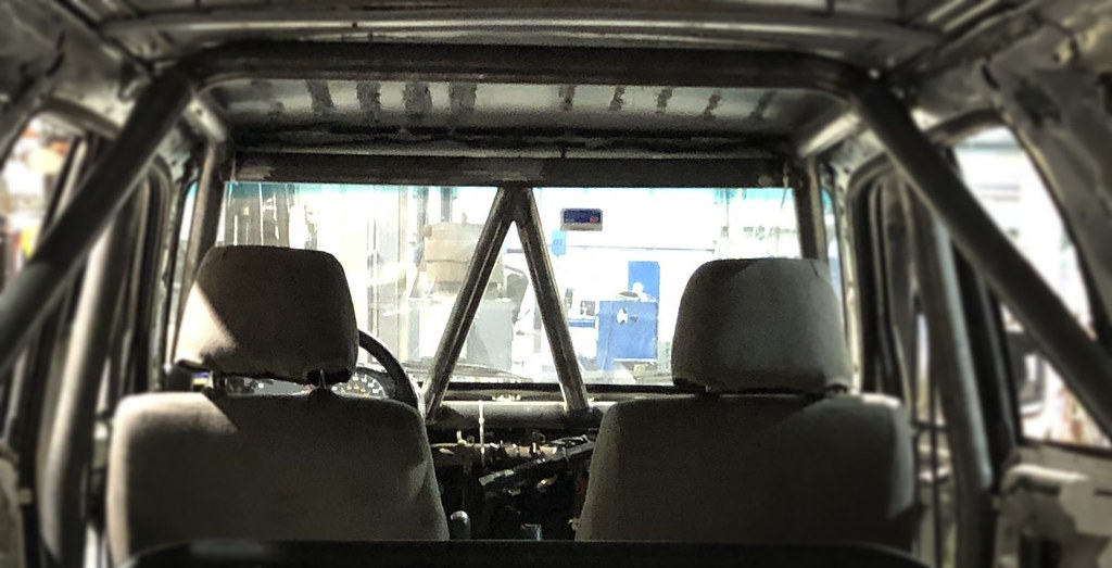

Tube #8 is in position.
Over the windshield
View From the rear

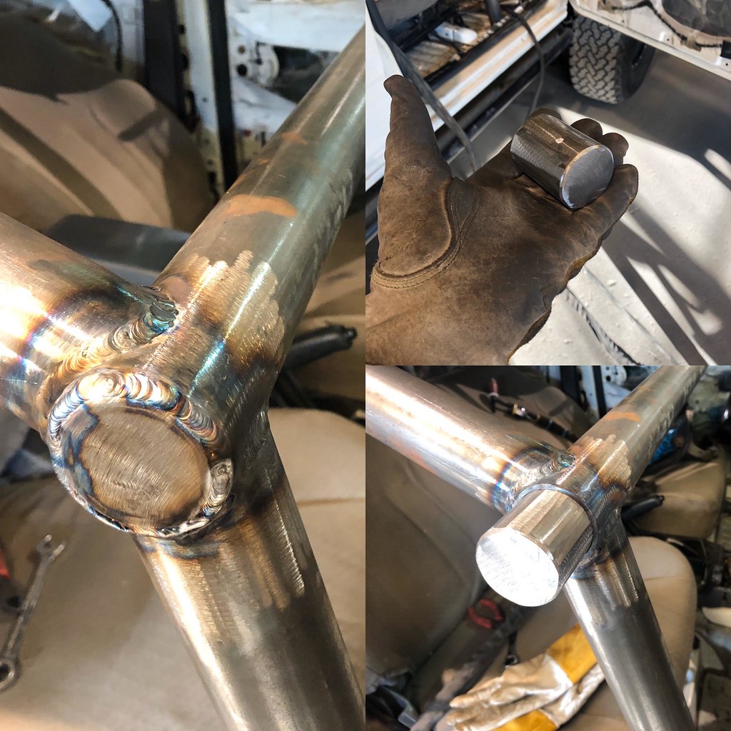

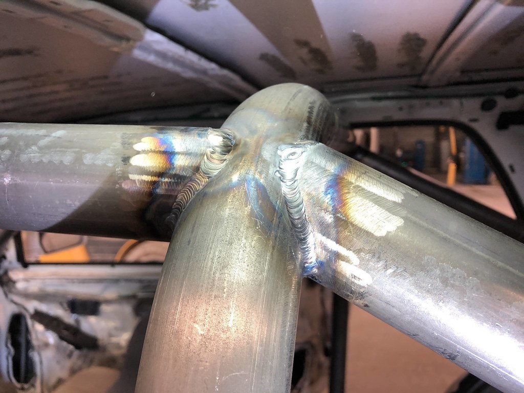

Joint of #1 and #2 tubing with tubing cap and crossbar.

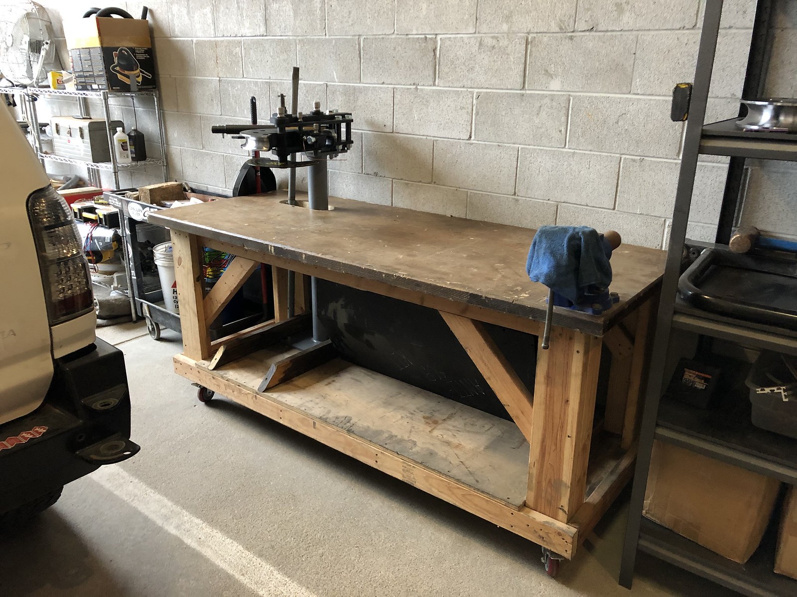

2. A Tubing bender has been ordered. More tubing needs to be bent. JD2 Model 32. Everything is 6.5" CLR on this one.

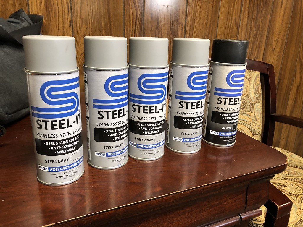

3. Weldable paint has arrived--Steel-it. Yeah, this weldable paint is worth the money.
Upcoming: Sourcing more 2" tubing. The warehouse was two sticks short, so I'll buy more of them once all this blows over--I have plenty of 1-3/4 for filler though, so I'll be welding up the overhead and rear areas until I can buy the 2".

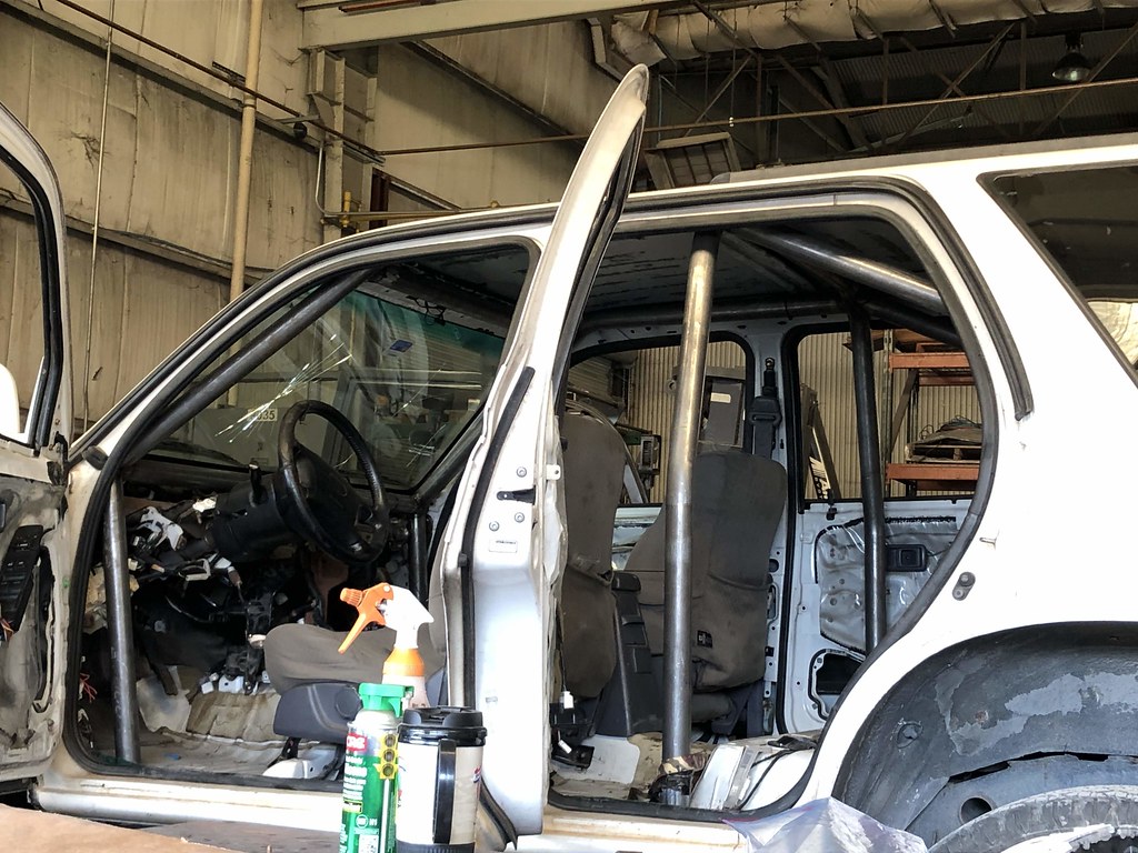

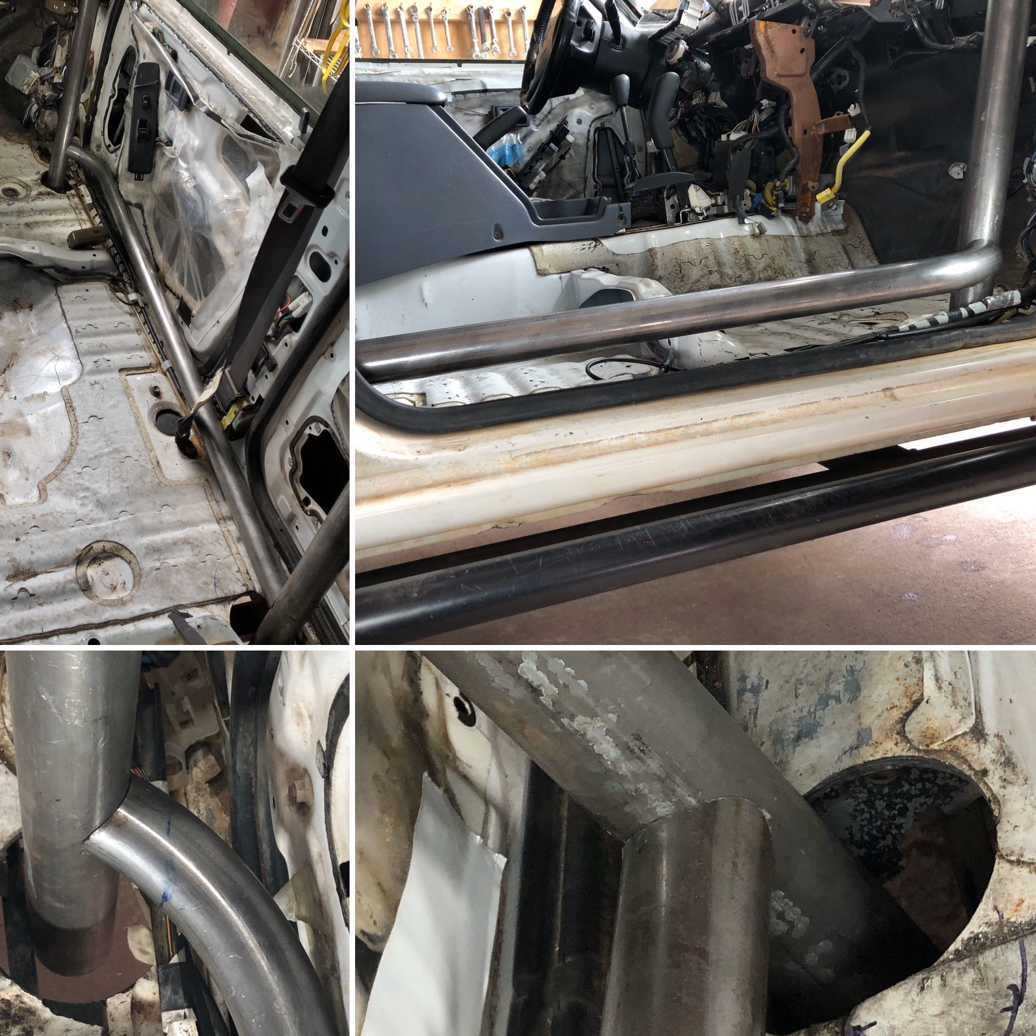

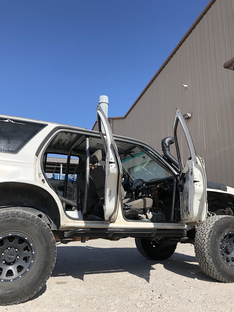

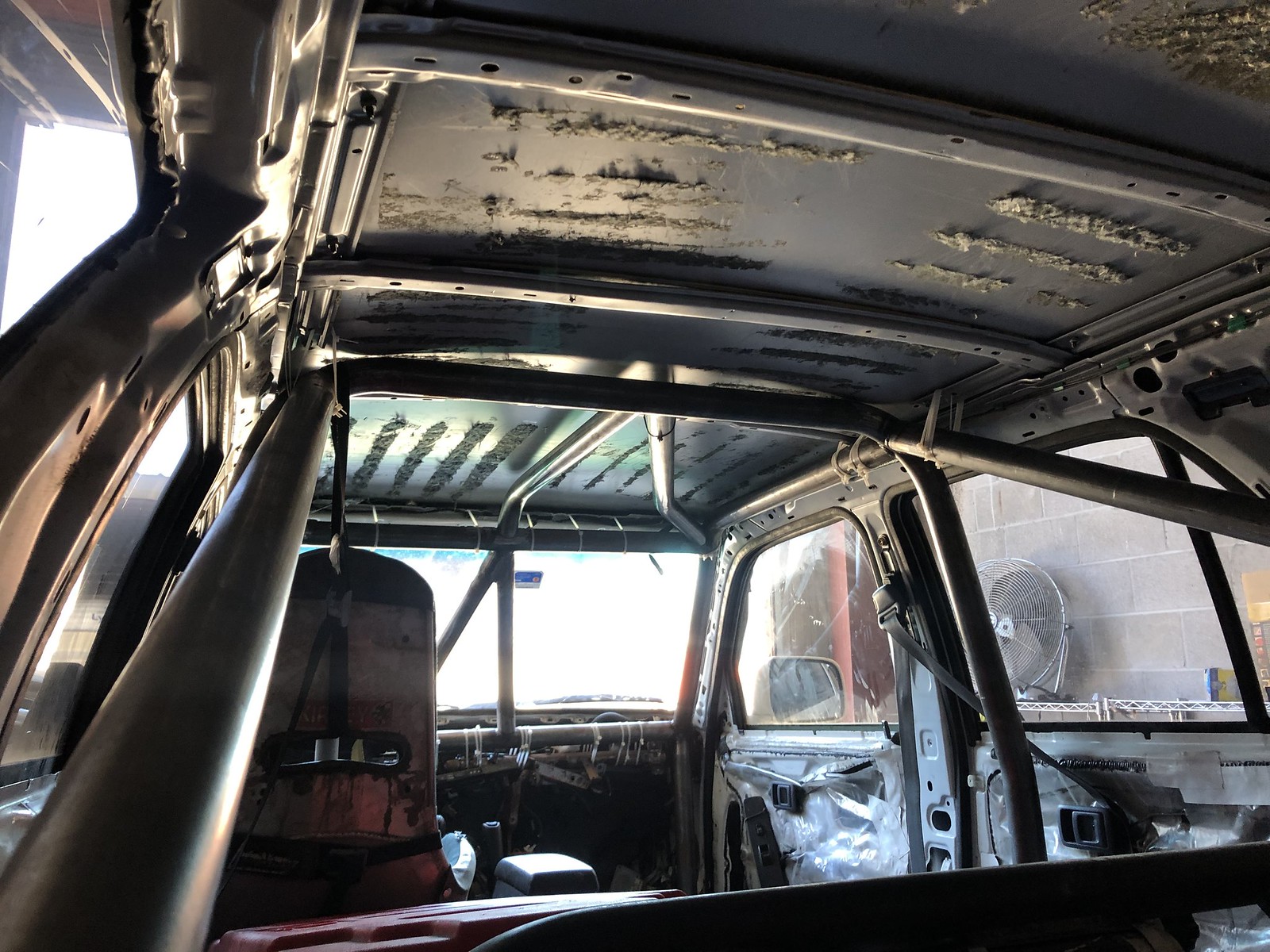

Here's some photos of the four new tubes that have been fitted.
Rolling Tubing Bender
Right lower Tube
Left Lower Tube
Center and Right Overhead Tubes
Upcoming is Left Overhead Tube and rear floor tube.
Where did you source the Steel-it paint? First look led me to believe it could only be purchased by the case at over $300. BTW... looking good man!
