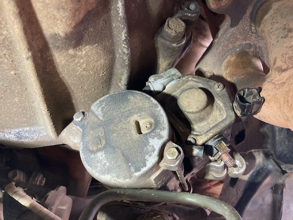

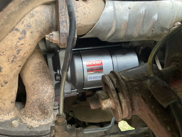

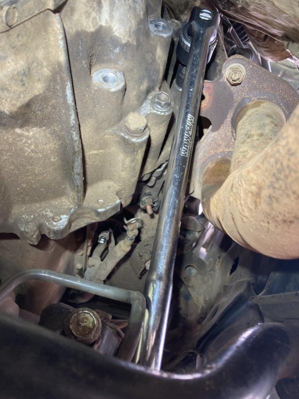

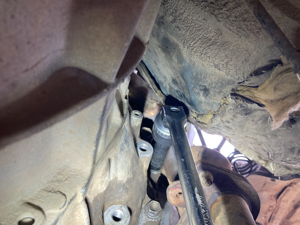

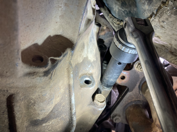

I did the starter on my 97 5-speed SR5 4WD a few weeks ago and didn't have to go thru the wheel well. It came out through the space above the steering rack - I had to flip it around first, and it was still pretty awkward, but seemed easier (and less scary) than squeezing it past the brake lines through the wheel well. I did undo the brake line bolts so I could get my hand in there to move it around.
I was also able to get a socket wrench (and later, a torque wrench) right onto the starter bolts without any extensions.

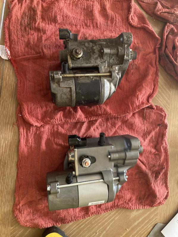

mtbtim, if you're reading this, thank you for all your videos! I was getting the click-no-start thing, so I took out the old one, intending to do the contact replacement as you showed, and discovered it was not the OEM starter. I changed the contacts anyway (they were pretty worn down), but then couldn't get the starter bolts to tighten once I got it back in. Seems I stripped the threads somehow on the old starter (despite going really slow & careful and tightening by hand).
End result: a shitty aftermarket 1.4kw starter came out...a new (reman) 1.8kw Denso went in a few days later. There's a pic of both if anyone is curious about the size difference. I was a bit concerned that the bigger one wouldn't fit - I couldn't figure out which size mine originally had. It's a manual, and it seems like those got the 1.4 at the factory, but mine was also sold in Canada and as far as I can tell had the cold weather package (meaning the 1.8kw starter). Either way, the one I took out was definitely not the original.
I don't know if this was easier because I have a standard rather than an automatic, just wanted to share that it is possible this way!
