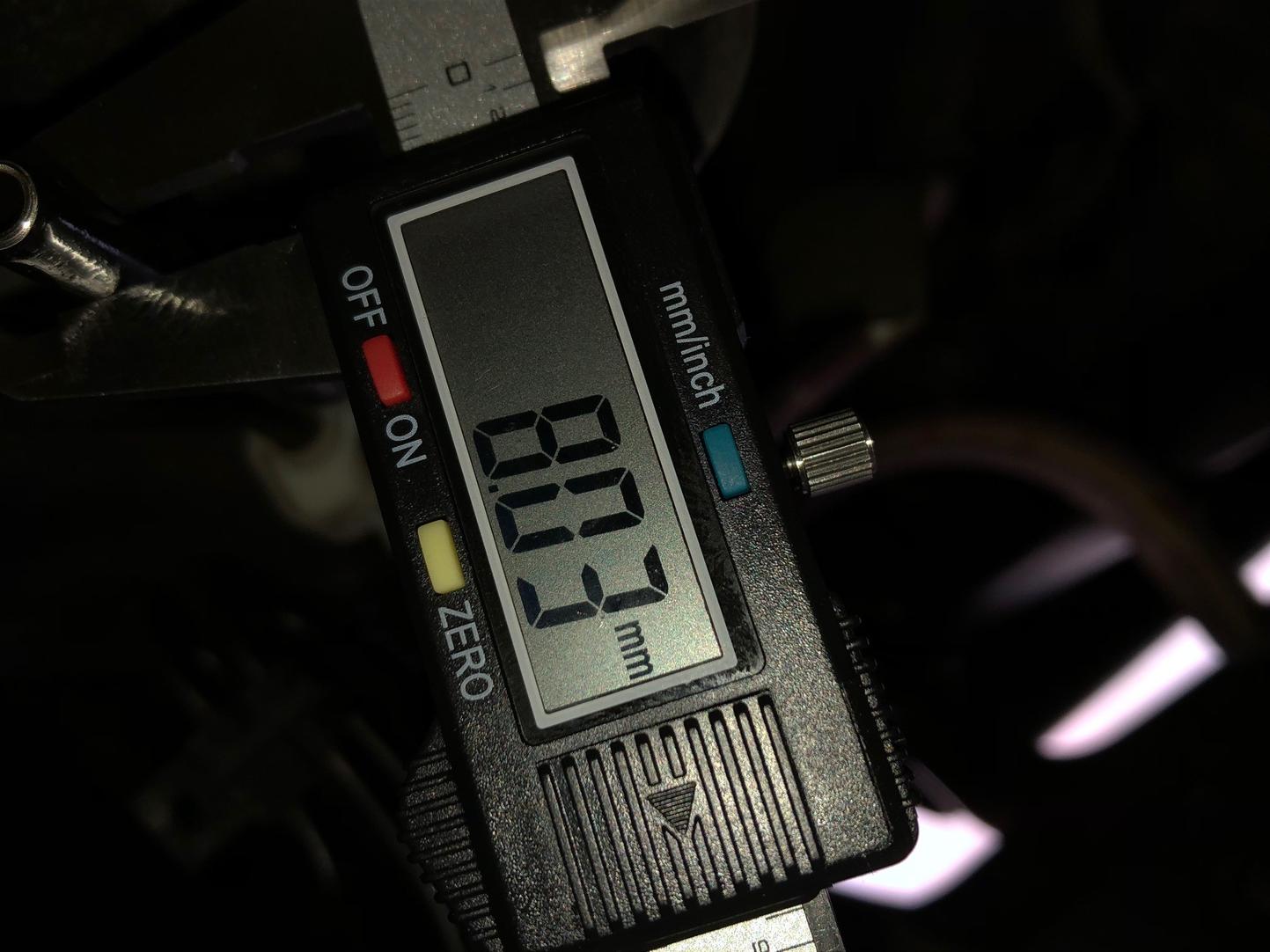

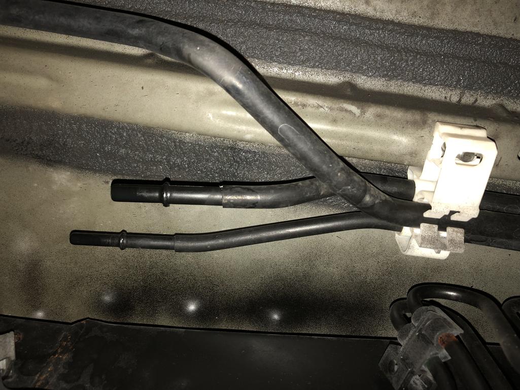

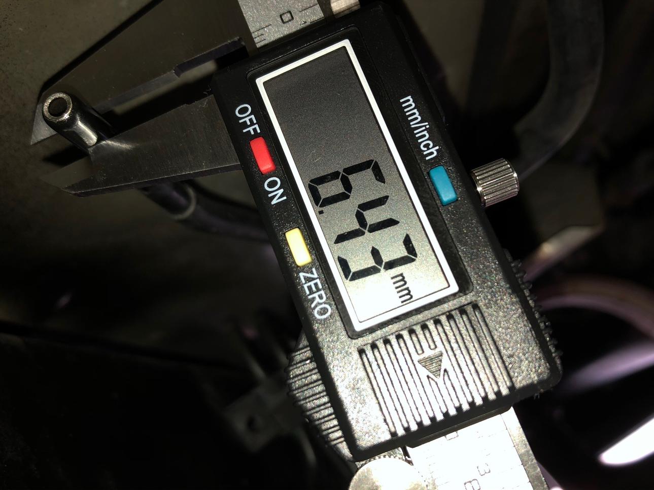

Does anyone know the diameter of these stock fuel lines running along the frame? I seem to have “misplaced” my calipers...

Okay, I literally spent hours with Aeromotive Tech today (Brett is solid) and here's the initial plan:
- Phantom 200 Stealth EFI Fuel System:
https://www.aeromotiveinc.com/product/phantom-200-stealth-fuel-system/
- Use ORB-06 to AN-06 Fittings for Supply and Return
- Run steel braided line from AN-06 to existing Supply and Return hard lines
- Use AN-06 to 6MM / 8MM Female adapters back to OEM Hard Lines along frame
We'll cap the vent on the Phantom (ORB-06 Port Plug) and instead run AN-8 from the fuel cell vent to the OEM charcoal catchment can (which should meets KOH Rules after a lot of routing).
The Phantom will drop in the cell (via 3.25" Hole Saw) and work fine with Alltech baffles. I'll then do a slightly larger hole in the lid of the cell to make sure it doesn't contact when sealed.
I also got a 10" Fuel Level Sender and Ohm converter from Summit that'll hopefully allow us to use our stock gauge (if not, we'll use aftermarket).
If anyone sees any issues with this system, let me know. Aeromotive had never worked on a 4.7L V8, so it took a lot of pictures and hours of diagnosing to figure it all out.
Now I just need to find 6MM and 8MM Female to AN-06 Male adapters...
