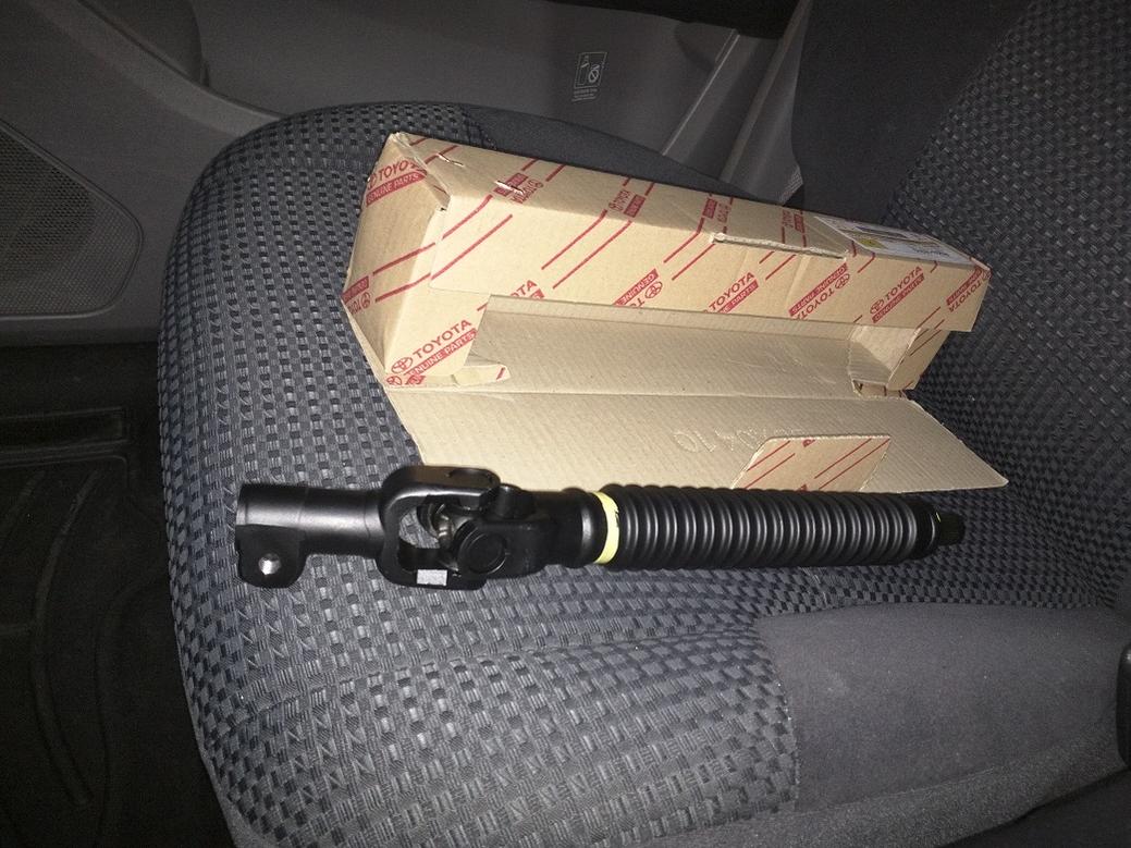

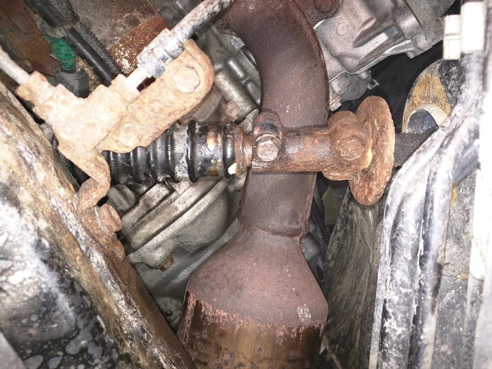

I got the part I ordered a couple of days ago and dropped off my truck at my mechanic yesterday in the morning.
When I went back in at the end of the day, he showed me a section that is on top of the shaft/Ujoint I bought that was rusted to hell (see second pic below). I basically had to leave without the repair getting done as he said he has to burn off that rusted clamp. So I called a local Toyota dealer and got a new one plus the two bolts and will be heading back to the mechanic tomorrow to get this fixed. The clamp plus the two bolts was about $50.
Mine was at least that bad and didn't need a new clamp. Only that lower bolt has to loosen, yours looks fine. Even so, the way oxy/acet cuts it's very easy to burn a frozen bolt out without hurting the metal it's bolting through, and plenty of room to work there. You guys should save your money and get a second opinion, in mine.
