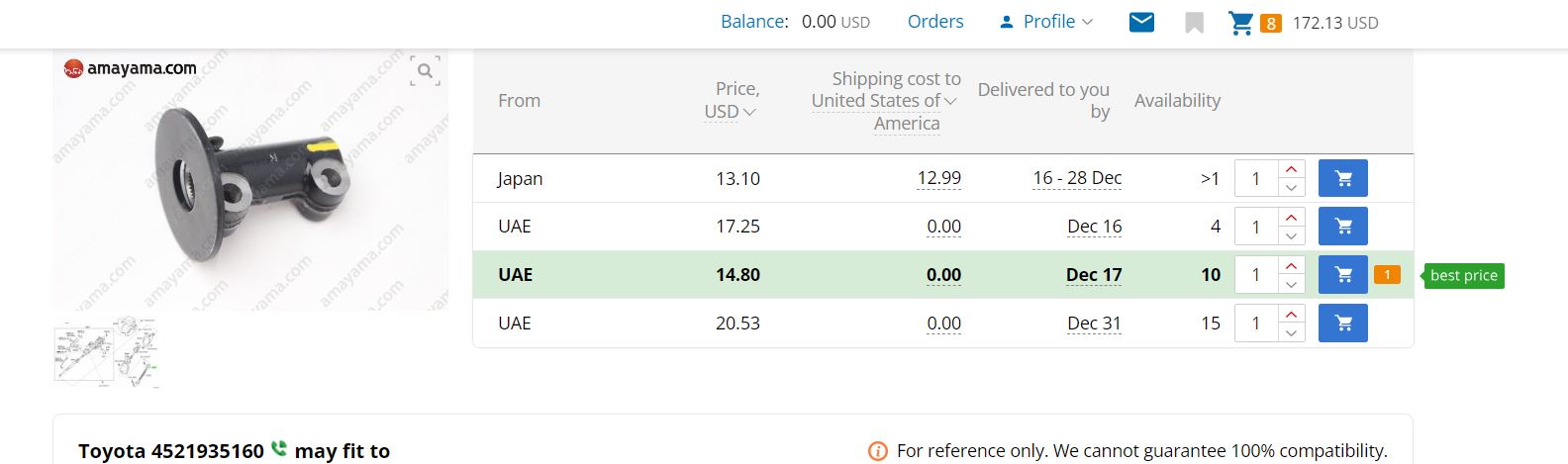

All great info, thx. I have the yoke in my cart and as well as the two bolts. I'm also replacing the intermediate shaft as well.
