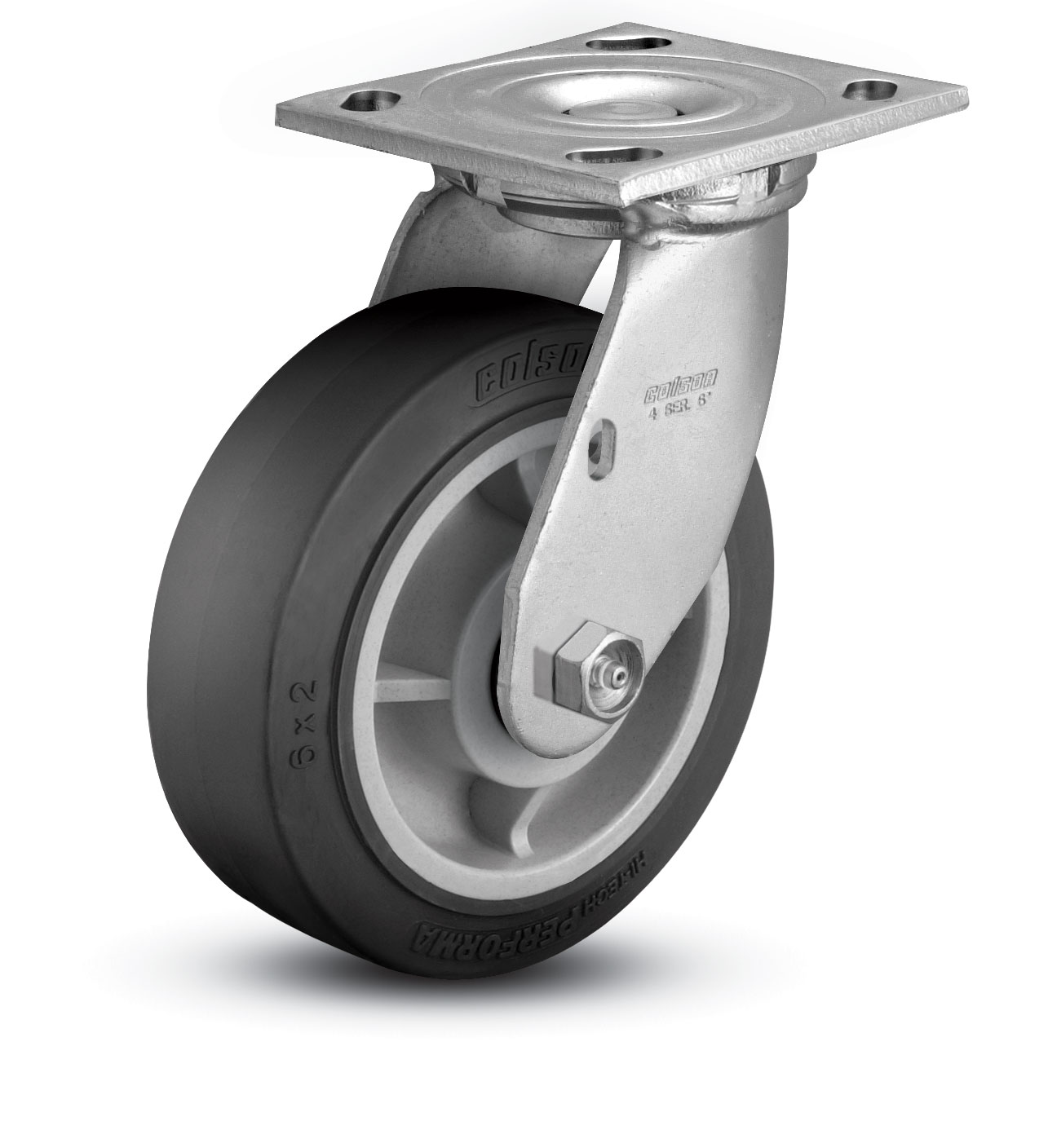

just figured out what the issue was. come to find out my right caster is shifted forward some how. they can not fix it as it is maxed out so i suppose i need one of those to fix my issue.. anyone have one of these hanging around?

I have...
