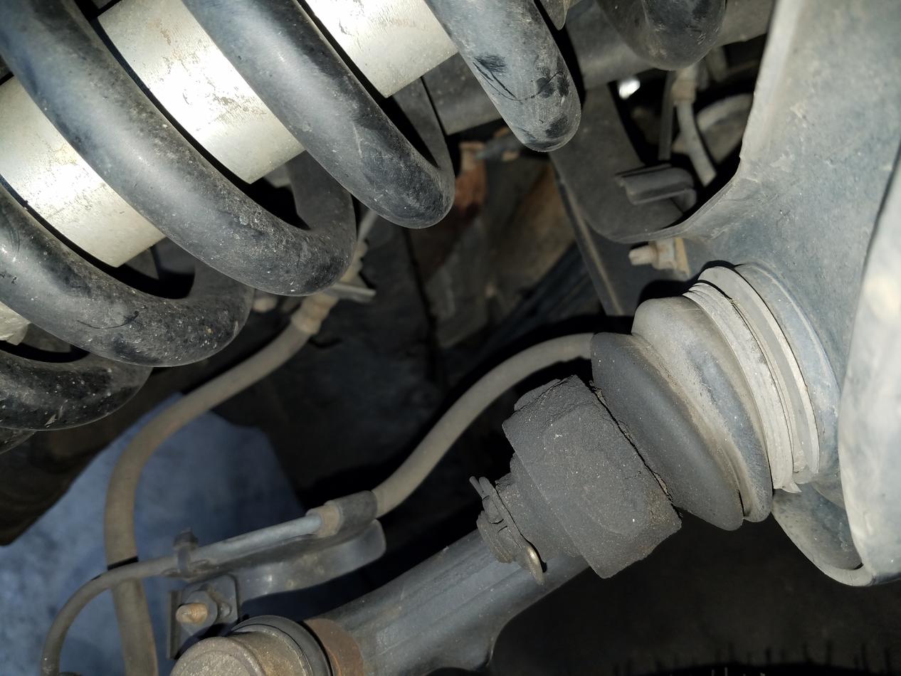

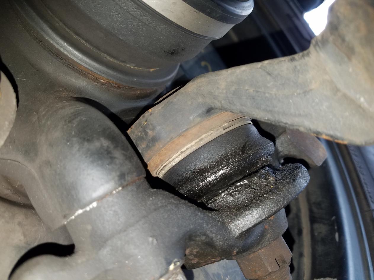

Here are the upper and lower bjs. The LBJ look a little icky. I had my mechanic check them for play a few months ago and he said they were fine, but again that was a few .months ago.

Sounds like 5100's on washboard to me! I had this complaint too and the only thinks I found to alleviate it were, slow down, lower tire pressure (as mentioned above), and/or move to nicer shocks.
Yeah I have not been as impressed with the 5100s as I thought I'd be given there popularity. They felt great for about 6-7 months, then now I feel they are mehhh.
