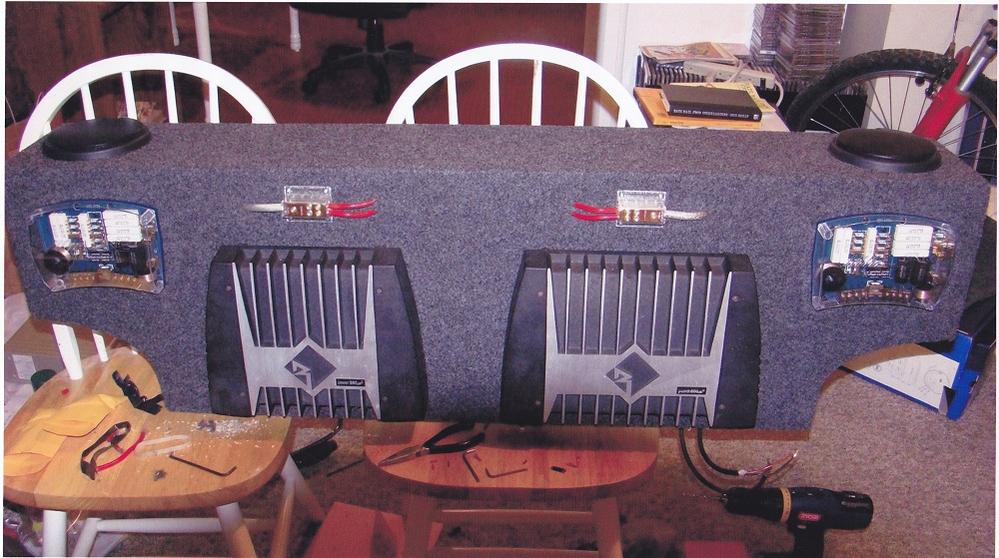

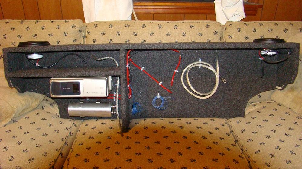

Just thought I'd share this, one of my odd little projects. For those with a lot of stereo equipment to install, this is one option. Yes, it cancels out the ability to extend your floor for long items (by folding the seats down), but if you've just gotta' have the tunes, it's one possibility. Yes, I probably should've boxed-in the small speakers, but I only use rear speakers for fill, anyway, so I wasn't too worried about getting massive sound from them--that was being handled by my 6.5" components in the front kick panels. I used the pass. side rear seatback for my access door to the disc changer, which gave it nice protection when up. My small sealed 10" sub box fit on the other side, tucked in behind the other seatback. Once in place, with the usual rear window tint, the components were practically invisible to those outside. The smaller components were the crossovers for the front speakers. All in all, it worked quite well--and the stereo sounded very good, too!

Pictures of it installed?
I'm afraid that was one of my brain-farts--I kept forgetting to get any, and when I sold the truck, the buyer insisted on keeping it (for extra, of course!). I would've liked some, too! It fit really well behind the seat, stopping just below the top of the seatbacks, and went all the way to the sides. The top speakers were 6.5"s, so you can figure the width from that.
Nice Setup. Good too see what others are coming up with. I'm working on the front door panels right now, but will be heading back there soon. What is the huge cylinder underneath the changer? Some sort of power conditioner?
Thanks for the compliment! I was just looking for a simple, compact solution for mounting all that hardware without cramming everything under the seats, etc., and had never seen anything like it before. The cylinder is a 1-farad stiffening capacitor, to aid the battery and stock alternator on the heavy bass hits. I'm curious to see what you came up with on the door panels--I'm planning on putting my next set of front speakers in there (the kick panel pods worked well for sound, but they're vulnerable to muddy boots, etc.).
