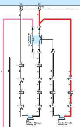

On the rear the wiring is a little tricky and the easiest way is to replace the speaker wires for the rear door and liftgate speakers. The factory wiring puts the signal through a relay that is controlled by the head unit when you push the party mode switch.

If I replace the head unit it will just be like party mode on all the time right?
Hard to say. Here's the schematic for the rear speakers and relay. The party mode switch goes to the head unit, then the head unit controls the relay. So which way is which is the question, that's why I suggest just replacing the wiring for the rear door and liftgate speakers.
