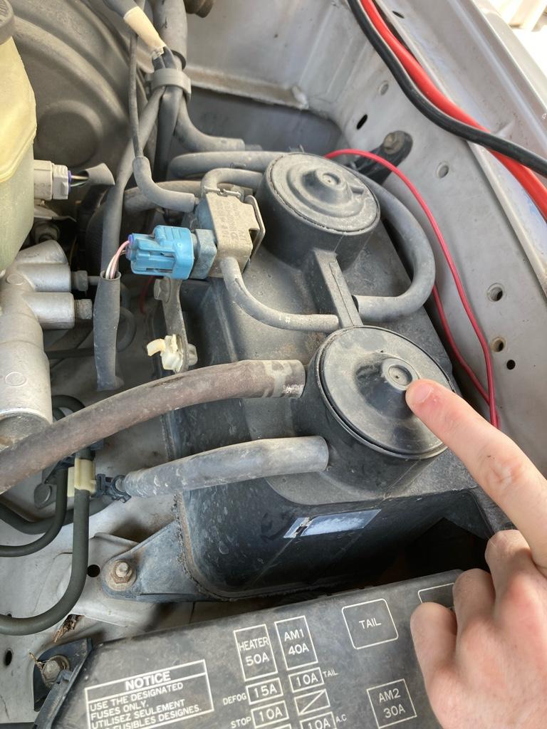

I’m hoping I can gain permission to post a thread about this buzzing issue I’m having. Seems like the sound is coming from the EVAP canister apparatus, but I need to get some more information.

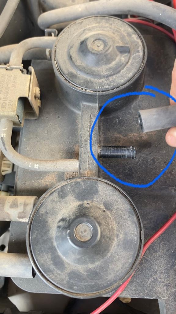

The next picture shows a hose which by disconnecting, completely eliminates the noise.
If I let my engine run for a few minutes and shut it off, pressure gets built up again enough for the buzzing to continue.
The buzzing continues even after months of having kept it in storage with the battery disconnected.
I just noticed today that by disconnecting the specific hose, the buzzing goes away.
What do I need to replace?
What are the causes of this?
How much will replacement of appropriate parts cost?

This is not unusual for the vapor canister to release pressure/make noise after engine shutoff. This is fairly well documented amongst the 3rd gen 4Runners.
I would not be overly alarmed, as long as your emissions seem normal, meaning they test within reasonable limits and so on.
The video was helpful, I could not tell that your engine was running, so all seems normal.
If this noise were to be constant -for example with the engine running, then you may have cause for concern.

The later model (but pre 01/02) evap canisters had a slightly redesigned section right there to eliminate the buzzing sound. It is/was some sort of resonance in the canister and doesn't affect function. I think there is even a TSB about it if you search.
