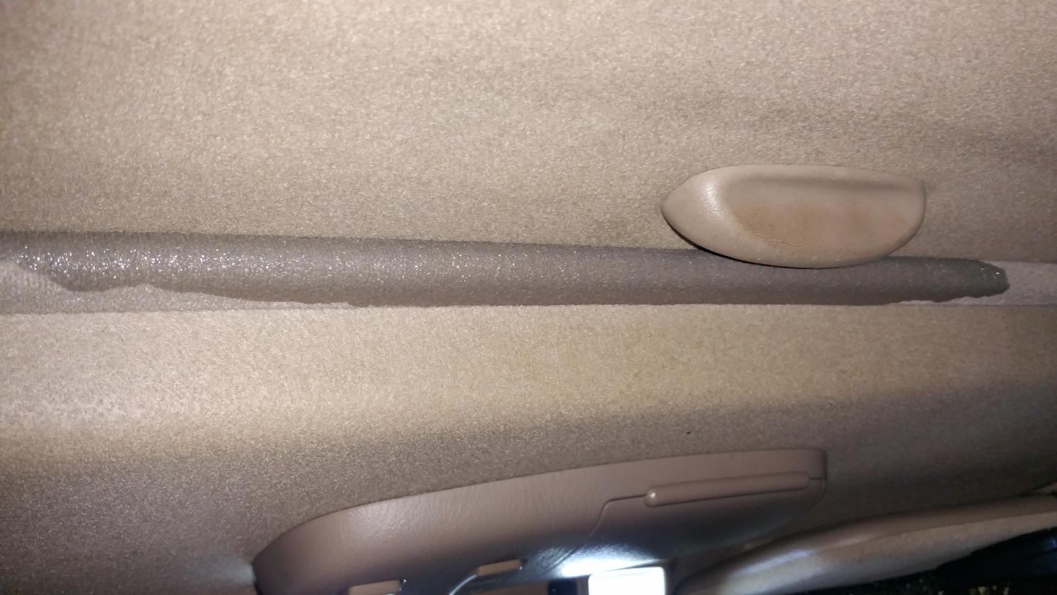

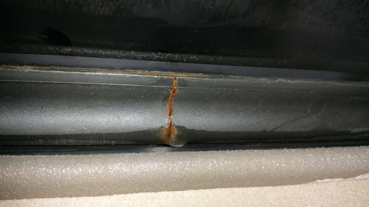

Hey all,
I knew that was gonna happen to me eventually.... Anyone else deal with this?
Is it as simple as ordering a new gasket and fitting it? or is this a dealership thing? Looks like a nice crack dry rot ..
Thanks.

Hey Guys,
I'll have a look around for drain channels... and the tubes while i'm at it... I'll report back when i find something.
Thanks.
If there's an obvious crack, I doubt even a properly working drain would help that much. The drain simply keeps the water that gets through the gasket from getting to the headliner.
Because the gasket is not watertight for some genius reason.
There is a rear drain on my 99. I'd assume there would be one on a 97, but i don't know for sure.
My sunroof was leaking when I bought it, and after a bunch of research (though I did not confirm in person) it sounds like the sunroof/gasket are all one assembly that has to be replaced at the same time. I just RTVd my sunroof shut to deal with it later.
This is true. You must purchase the entire glass/gasket as one piece. They aren't sold separately, at least not from Toyota. I don't know of any aftermarket options.
There are rear drains, I think they empty out near the rear quarter panels. Water SHOULD fall into the sunroof assembly channeling and out the drains. But the top side trim / seal has a small gap towards the hood, I'd try sealing that. You can pour water in the sunroof channel, will be evident if the drains aren't working.

I haven't found time to mess with it yet, but I'm just going to smudge a little black rtv silicone in there on top and bottom of the crack. I'd imagine that would stop the leak just fine and you'll probably never notice it's there.
I Know what you mean.... I assume that crack thats there isn't supposed to be there and so there for we get leak... tomorrow i'll go back to the dealer and see what a new assemble will cost me.. I'm guessing that if i seal up that crack the water will just find another path.. Like those drains that everyone is talking about.

It's supposed to leak into the channels then drain. That looks like a crack in the window housing, not the drains. Look for a crack in the window housing and plaster it with rtv. My drains plugged and my window hadn't worked since I bought the truck so I rtv'd the crack between the window and the roof.
I just bought a whole sunroof assembly from my yard for 50.00 from a 98 to go into a 02. It's easy as heck to change out. Involves about 2 hours. Philips and a 10mm, pliers I forgot. You may get one at your local yard for a little more. Definitely not 500.00
While you're there clean out front and rear drain line with soap and water and blow air thru them. Make sure you clean the drain rail before you connect drain line.

Sir I mean when if you replace the sunroof. Yours is shot, there's a crack that's not worth fixing.
Currently $601.61 from Camelback.
P/N 63201-35040
Is pulling one off a junker out of the question? Probably no more than 50 bucks for the glass and everything. I'm sure even if you had one shipped it'd be under 100 bucks. I paid 125 for a mint one for my 1st gen from a member here.
