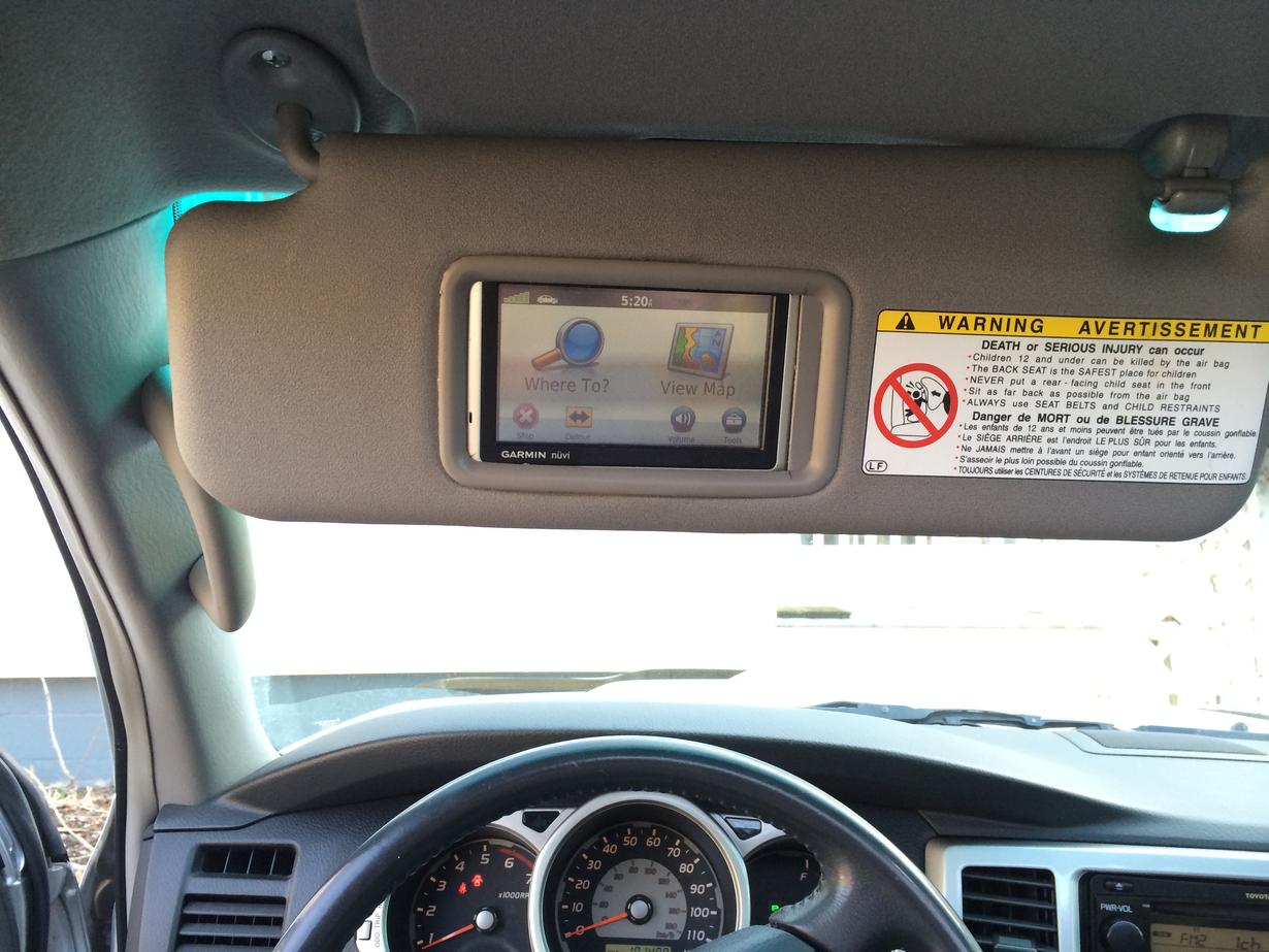

5-inch garmin GPS mod
So I upgraded from a 4.3 to a 5.0 inch Garmin GPS. Just wanted to show the results.
Upside: bigger screen
Downside: this is now a destructive mod. I had to cut plastic and vinyl to get it to fit in the existing opening, leaving a ragged looking edge to the existing vinyl. The solution was to fabricate a bezel using some plastic bumper repair putty--it dries hard, but remains flexible. It was a pain to do, but once I cut vinyl I was committed. The results came out okay--one day when I have more time I'll make a cleaner looking bezel. Sure wish someone made panel mount bezel for these garmin units (anyone have a vacuform machine?).
Anway, here are the results. Happy modding...

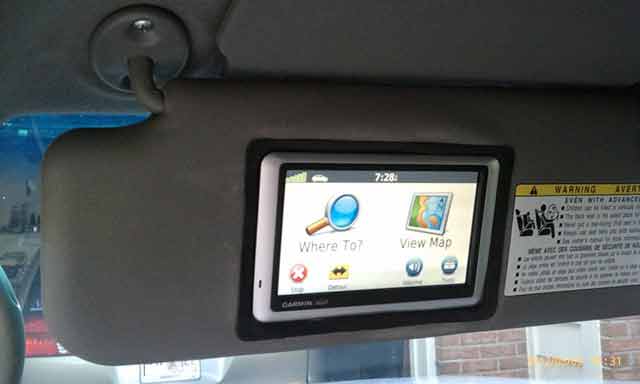

Sunvisor GPS mod complete
First off I want to thank [MENTION=47689]dpodo[/MENTION] for another brilliant mod as well as answering some questions I had along the way. A friend of mine gave me his Garmin Nuvi 1350 which is what inspired me to go ahead and give this a shot. Didn't find the need to cut the hole in the back of the visor for the speaker because the volume is pretty loud on the gps to begin with. Was able to keep the extended part of the visor by cutting it down so that it was out of the way of the cavity left by the mirror and then just cut 2 notches to keep it from sliding all the way out. Took me a few attempts to modify the usb just right to allow the gps to sit flush in the visor. I used the link below to short out pins 4 & 5 on the usb so that it would allow the gps to go into navigation mode and not get stuck in PC mode.
Garmin Nuvi GPS Power Connector pinout diagram @ pinoutsguide.com
