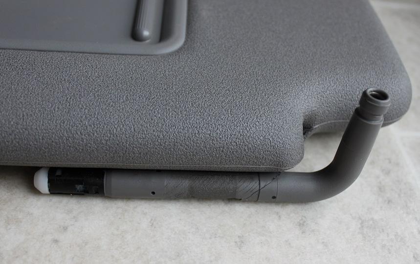

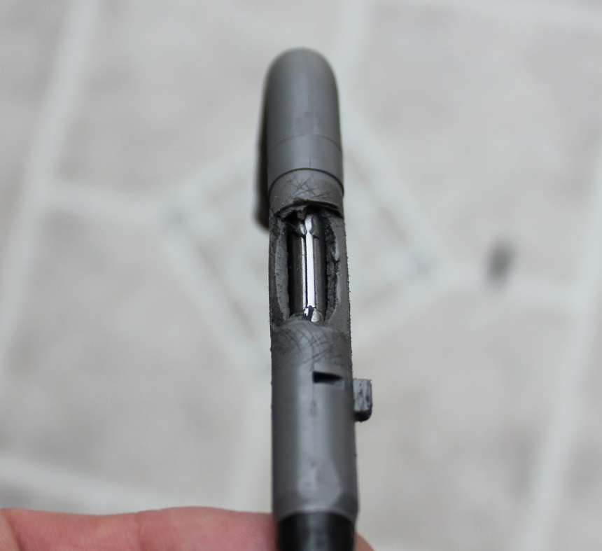

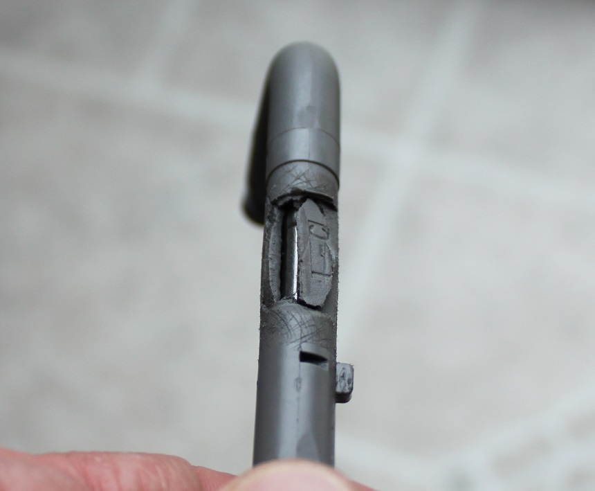

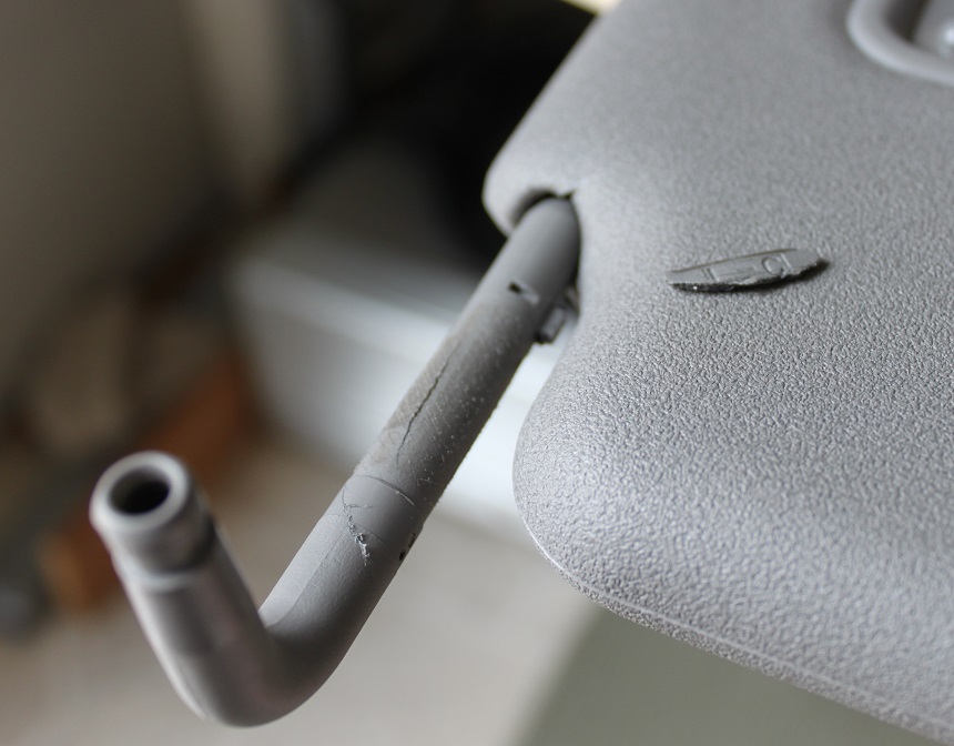

If any try to take it apart, there is a groove that needs to line up. Top 2 pics show alignment.
The plastic just blows apart after awhile. I scored it with an Exacto knife to try and get more friction, didn't really help much.
Maybe able to get creative with some epoxy? Rebuild/remake the flat spots.

Pull it apart and look at it.
Be nice if you/we could just buy the little "L" shaped part.
After thought...if you pull it apart and wrap the broken section with electrical tape...or what ever, it might hold...until you wear through the tape.
Needle nose type plastic clip/clamp and clip it to the secondary visor when not in use. Think I got the clip at Harbor Freight or it may have come an in assorted plastic clamp package from Walmart, your results may vary...previous owner had used valcro.

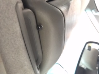

Sun visor fix
This is what I did to hold up my visor. The visor folds up barely missing screw head. When pushed up fully, extend pull out visor over top of screw! I even spray painted the screw brown. Hey, it works.

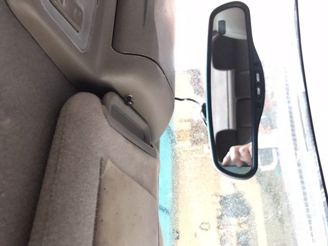

Visor fix
Here’s another pic before I painted the screw.

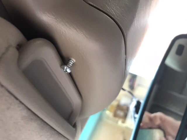

Visor fix
Here’s a different angle...
