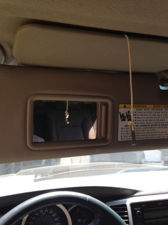

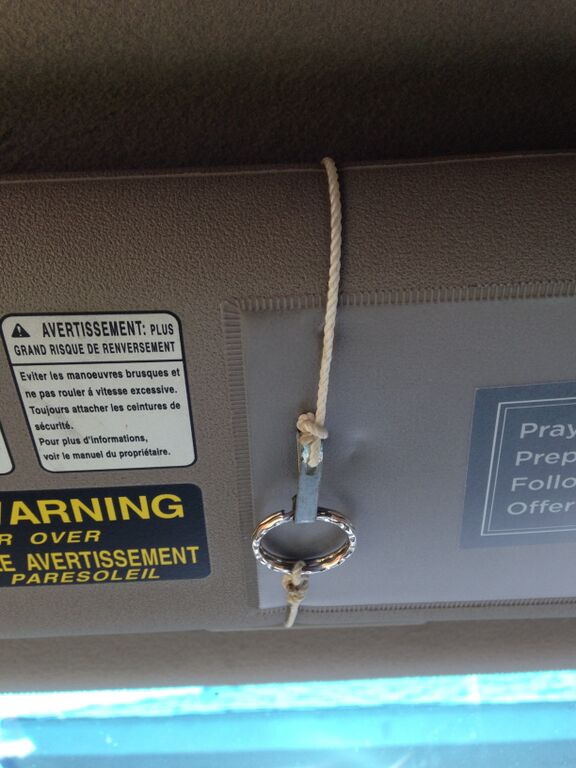

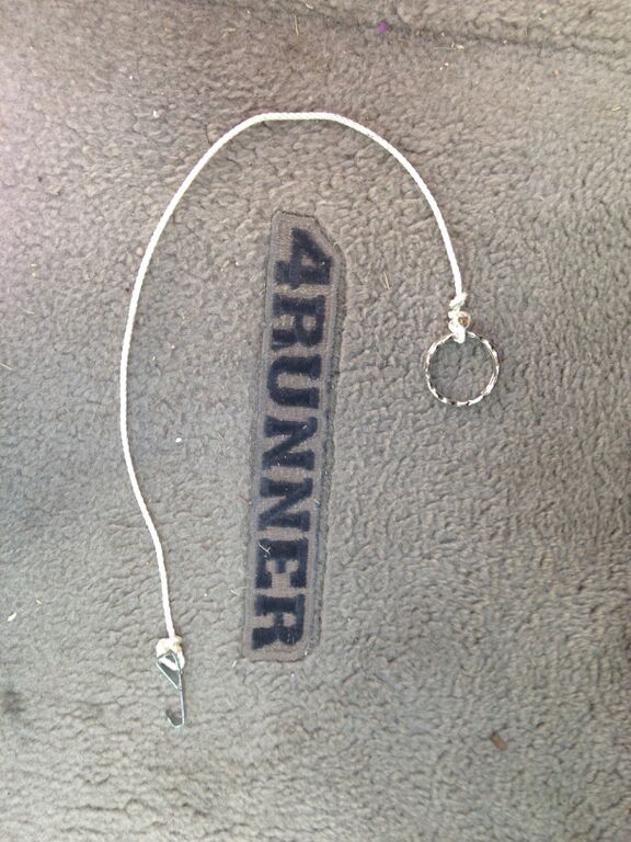

My Fix
My mom drives a 4runner and was having the same issue described here. After trying velcro and attempting to take the visor apart (neither of which really worked) I came up with another cheap/easy solution. I tied some string around a keychain ring and a picture hook to make a loop that could be hooked together to support the visor. I wrapped the loop around the second smaller visor as well to help hold up the larger visor. She likes the fix and the appearance doesn't bother her. Better than having the visor in your face!
