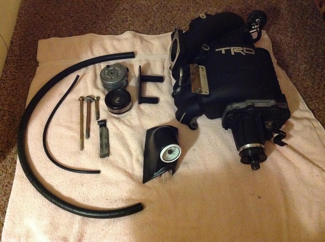

Hey all, bought a 2nd gen supercharger and have been looking over threads and the install instructions and can't quite figure it all out. Do the 2001 and up have to use the IAC check valve? How about the 3 way vacuum T?(I don't have vacuum actuated diffs so idk) Heres everything I have, minus the belt(on order), gaskets(plenum and throttle body on order), spark plugs(on order) and having the two small brackets made along with the drivers side mount spacer. Please help, can't seem to get the answers I'm looking for.

So you will need the following items to install your supercharger:
(4) Socket Head Cap Screws, 8x1.25x65mm & (4) 8mm washers (these attach the throttle body to the supercharger)
IAC check valve is required and cheap.
You will need a T for the boost gauge tap in and for the evap to 4wd vsv line. The evap is 5/16" I believe and the vsv is 1/4". Any parts store or home depot will have that fitting.
BTW, here are the install instructions. It will show the hose routing instructions for your year 4runner. http://www.customtacos.com/tech.old/files/v6_supercharger.pdf
Overall install isn't very bad and can be done in 3-5 hours pending how fast you work.

So you cannot use the stock throttle body bolts?

IDK. I kind of assumed you could, but they might not be long enough? Ill leave this to question to someone to answer. [MENTION=53337]SCRunner12[/MENTION] maybe?
No you can't. The stock throttle body bolts consist of two long bolts and two nuts. The other two bolts are built into the throttle body and cannot be reused. Those 4 bolts can be found online pretty easily. I have a link on my work computer. I'll get it tomorrow.

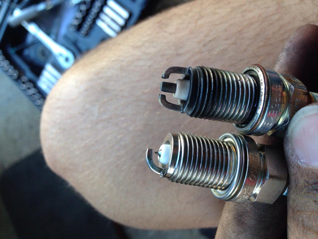

Haha free is always a nice price. So far, I'm only about $200 invested in my supercharger build. Probably after selling the gauge and buying a new one I'll be around $250 I think. Also, do the IK22's need to be gaped or are they pre gapped correctly? If they need gaping, what is the gap?

They need to be gapped.
0.43
Hmm, I've read a few sources that say .32. That's what I did and I haven't had any issues yet. Maybe some of the other guys can chime in.

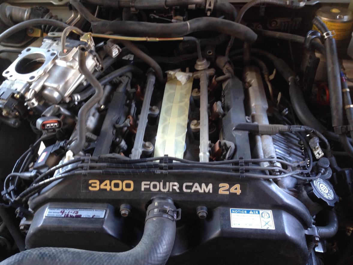

Ya, more info would be great! And from what I just read, supposedly you're not supposed to gap irridium plugs cause you can damage the tips?? This seems logcal because they are such a fine tip on them...? P.s. I may be in the middle of my install as we speak...just maybe. Lol

You can gap them, just don't use the coin shaped tool or you would mess up the tip.
<img src="http://image.circletrack.com/f/enginetech/ctrp_1001_engine_spark_plugs/25479557/ctrp_1001_03_z%2Bspark_plugs_engine%2Bgap_tool.jpg" width="900">
you get a gap tool like this one, so you dont get close to the tip. this is just some picture I got from google.
