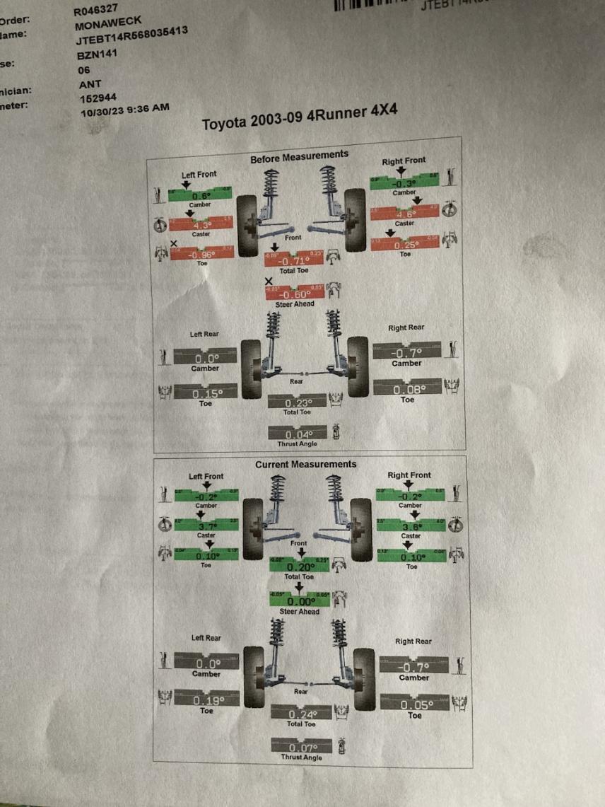

I will post a picture of my alignment sheet after work. My suspension has settled a bit since and I will be doing wheels and tires sometime in June so I'll likely get it aligned again at that point for good measure, but I was able to get great numbers even with a regular "chain" alignment shop. (all I could get for a next day appointment)

Looking forward to seeing what you came up with. About to pull the trigger on these. Not sure if I want to go with the offset ones or regular. I think I’m leaning towards regular because I haven’t had issues getting the alignment I want (usually shoot for 3.5-3.7 caster with jba ucas) worried if I get the offsets then I’ll have too much caster?

I was also worried about having too much caster. I pulled the trigger on the double offset ones and couldn't be happier. I also have JBA uppers, love those too. Likely you'd be able to get the same numbers with the standard LCAs but I don't know for sure. I do know that the SuperPro lowers give you a lot more adjustment room because you're not "maxed out" for lack of a better term.
Here's my alignment sheet, I asked for "between 3 and 4 degrees of caster":

Perfect! I guess double offset it is! Thanks for verifying that for me!

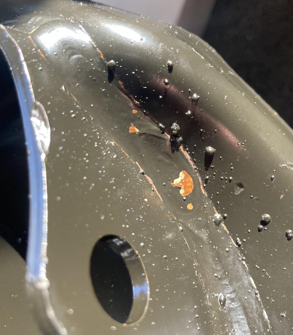

Just wanted to update this with my experience of purchasing superpro offset lower control arms. I received my package and opened it and noticed some rust on both of the lcas. Contacted super pro and they’ve given me three options 1. Is to exchange them, 2. Is a $100 off if I choose to keep the ones with rust on them, or 3. Return for full refund. Bummed that there is rust on the new lcas I am happy to see that they stand by there product and are willing to help me out.
Yeah I'm leaning toward sending them back because the spatter is quite bad on them. I asked if they could look at the replacements before they send them out to me and they said they would double check them.
