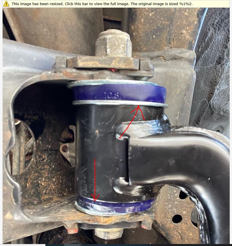

this has been a great thread on the Superpro arms and bushings.
I'm curious, kindly take a look at the pic below and tell me if there'll be wear on the areas shown by the arrows. My assumption is that the arms rotate while the large washers stay static. Granted, the amount of rotation is only few degrees but if there were to be any squeaks/rubbing, this would be the place of origination. Sounds like squeaking isn't an issue with these bushings.
I'm after just the bushings and noticed they have inner front and inner rear kit. What's the preferred bushings that i should be purchasing? I Some of you are referring to a "double offset", by that I take it you're referring to both inner front AND rear bushings?
I have a spare set of arms so I can take my time sourcing the bushings and BJs.

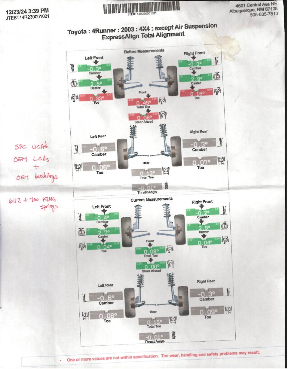

This is a slightly different question and it pertains to bushing noises I've been hearing for some time. I also have SPC UCAs and is that where my noises are coming from? Everytime I hit a bump, I'm hearing these sounds and they're not squeaks, more like rubbing. Not tire rubbing, but bushing or rubber stretching (for lack of a better word!). Granted, my OEM LCA bushings are shot beyond redemption so part of me thinks that's what I'm actually hearing. The LCA bushings are opening/closing/stretching as I go over bumps.
If I need to pull out the long UCA mounting bolt then insert grease into that space, I'll do so but wanted to confirm before proceeding.
I've attached my printout and I'm happy with the caster. But, due to the age of the bushings, I bet she could feel a lot better!

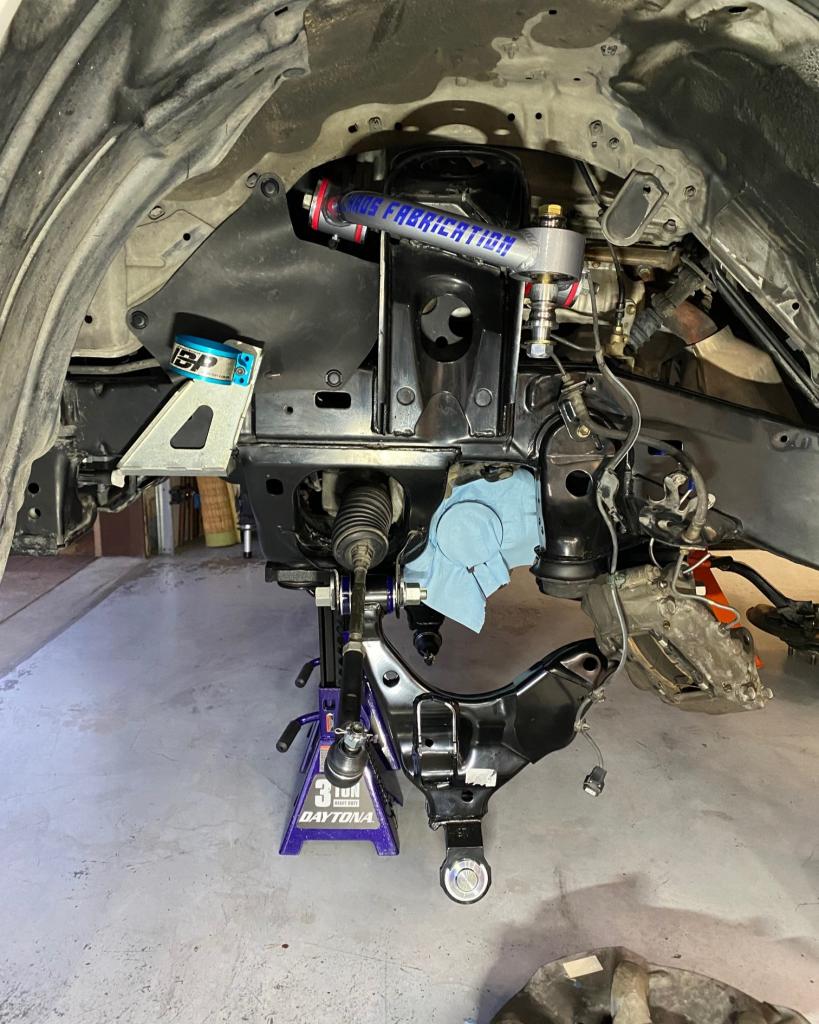

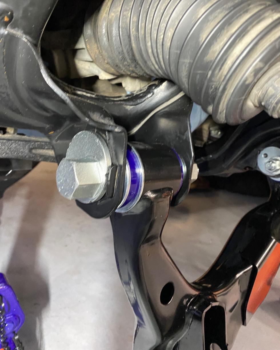

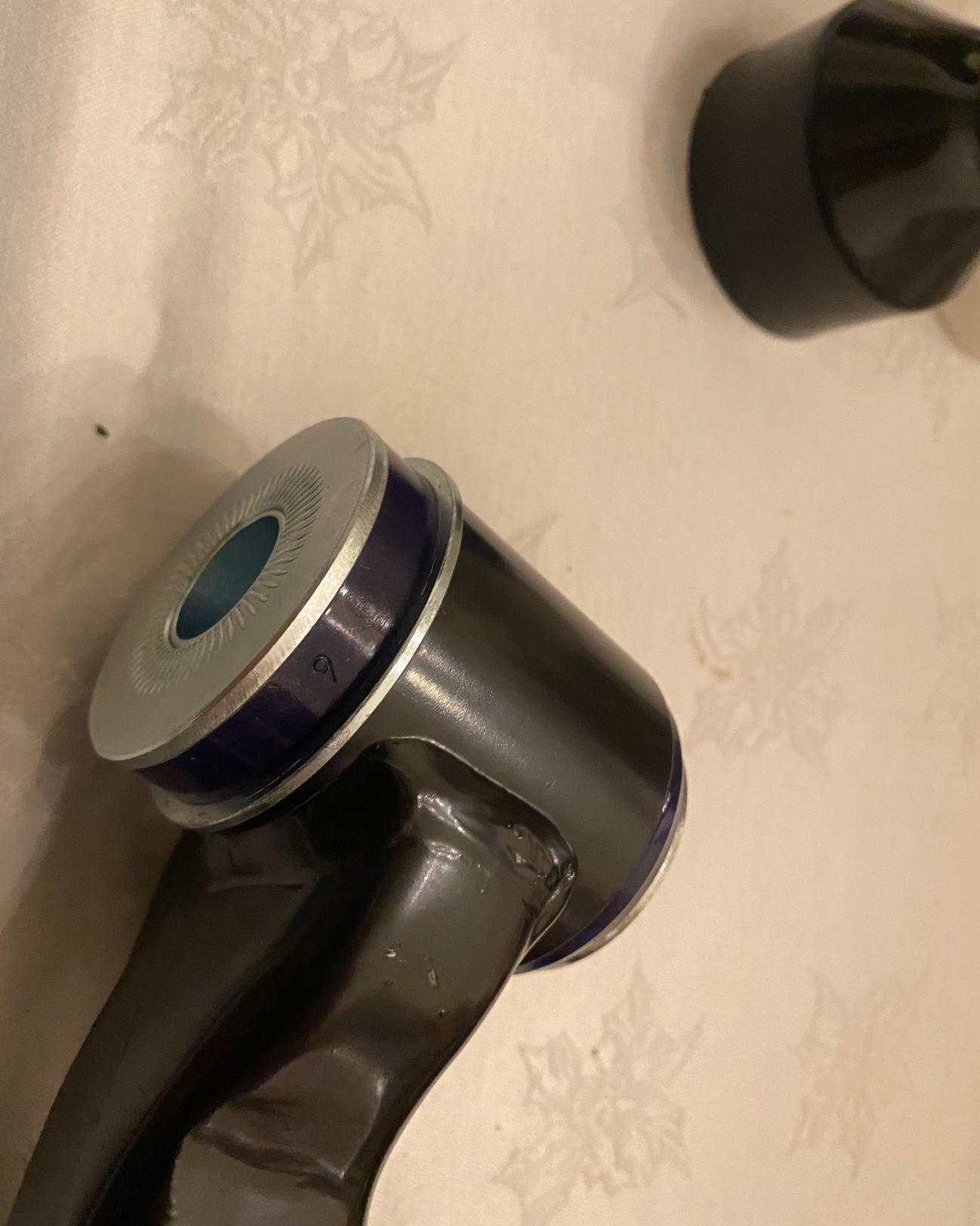

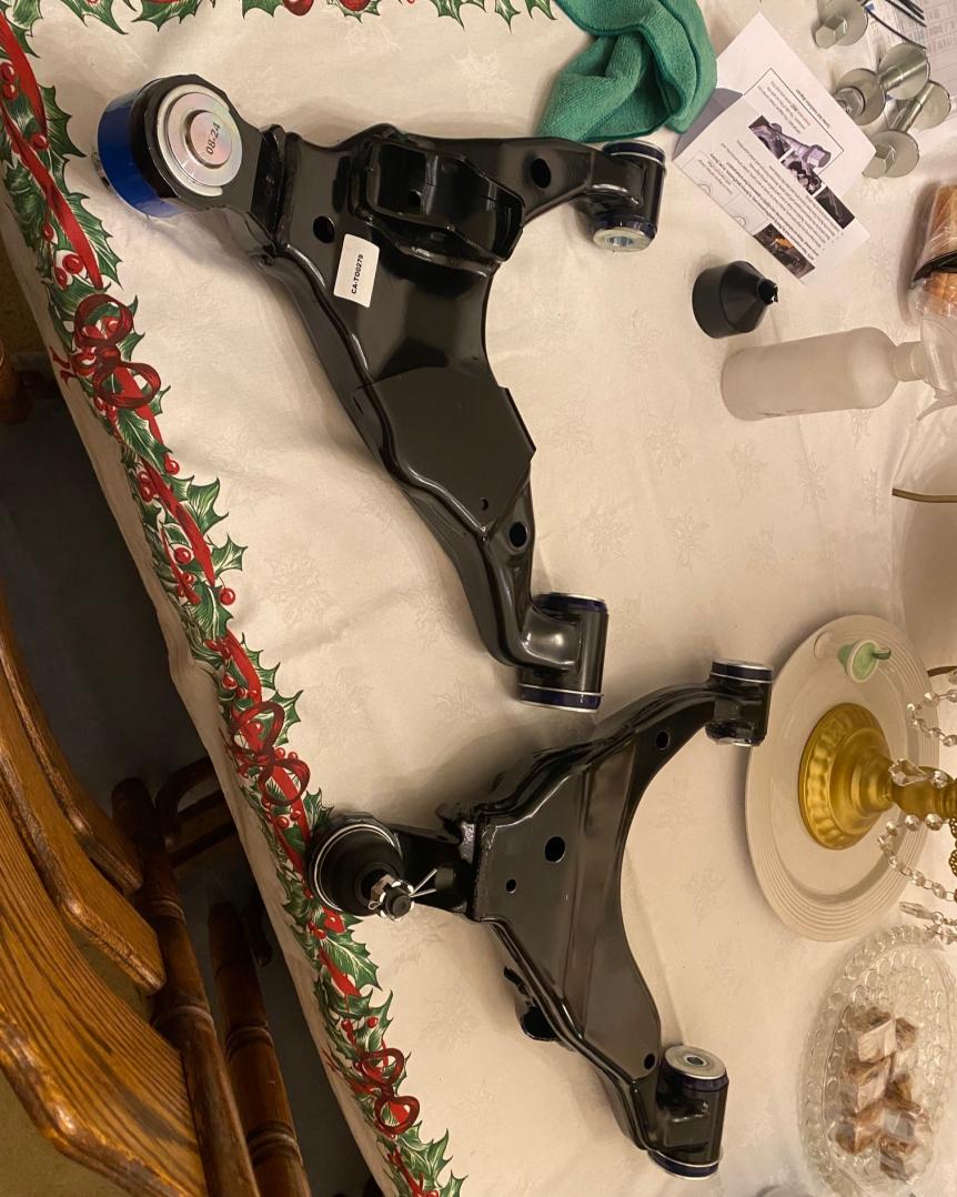

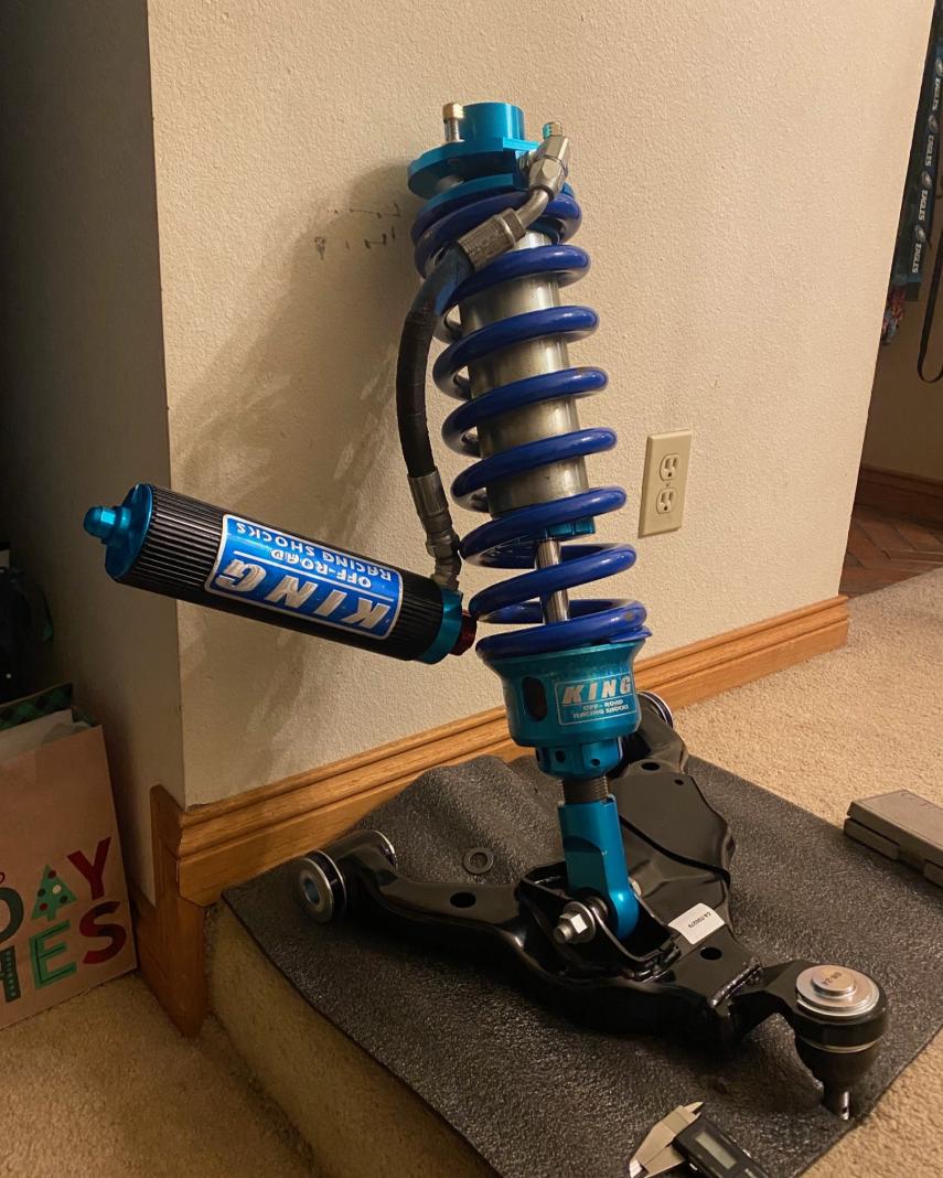

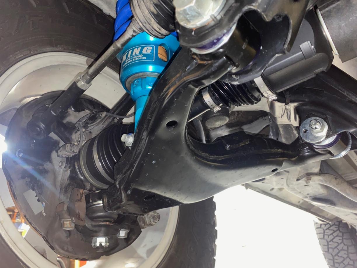

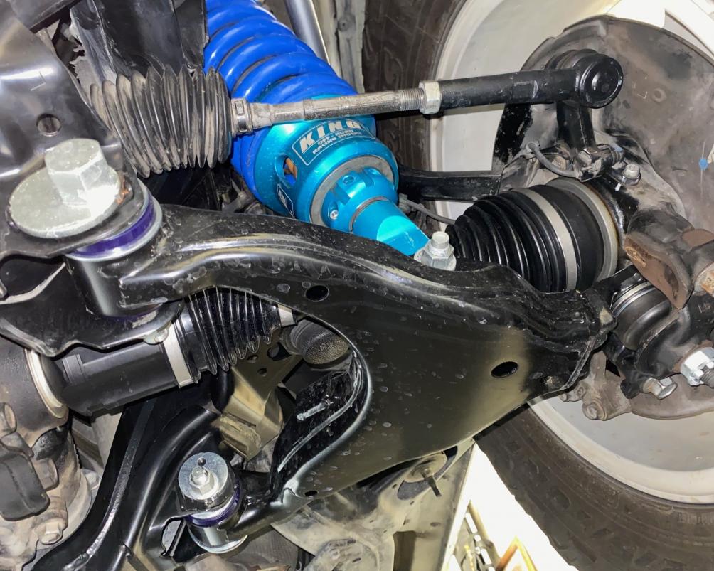

Hi y'all I figured I would do an update since I pulled the trigger on a set of these arms. So far I am very pleased with them and they have been great. They have been on my truck for about a month now maybe more. It was very nice that it comes as a kit and overall the value is there at least for me. New OEM arm assemblies would be about 800 without new cam hardware. I like that the super pro hardware is beefier than stock as well. We will have to see how they last in the future but if your looking for a set of arms and want a easy install this is the way! The ball joints they come with seem of good quality and look beefy and the bushes themselves also seem to be of really good quality. I watched a couple videos on their design of how the bushings are and I have to say I think superpro has the best design so far for a poly LCA bushing. I really loved that the washers on the bushings are a captured fit / stuck onto the inner sleeve which makes installation a breeze. Previously on my 3rd gen 4runner I replaced my OEM bushings with some white lines and it was an absolute pain in the butt getting the arms mounted back up. The washers for the white line have to be pushed in between the LCA bushing and frame when your putting the arm back on. It took me and a friend at least 3 hours or so just to get those arms mounted up. This time it was like 5 minutes per side. I also like the way they designed the bushing so that you aren't having a harsher ride than a rubber bushing. Usually you loose a bit of comfort switching to poly bushings but I have poly bushings on my TC uppers and lowers and I don't feel any loss in comfort. Quite happy with mine.
For anyone curious, during this job I did a whole front end refresh. New front shocks, TC uppers, new lowers (obvi), new OEM outer tie rods, new OEM 5th gen 2024 updated axles, all new cv axle seals (hub and diff side). She is very happy now.

You now have a nice front end set-up that articulates about as well as current design allows. The biggest problem with OE LCA are the bushes, IMO, they don't allow free travel of the arm like poly bushes do. Also, replacing the cam style adjust hardware with non-adjust and setting front/rear to the same position is best, IMO.
