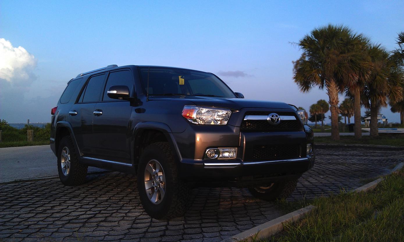

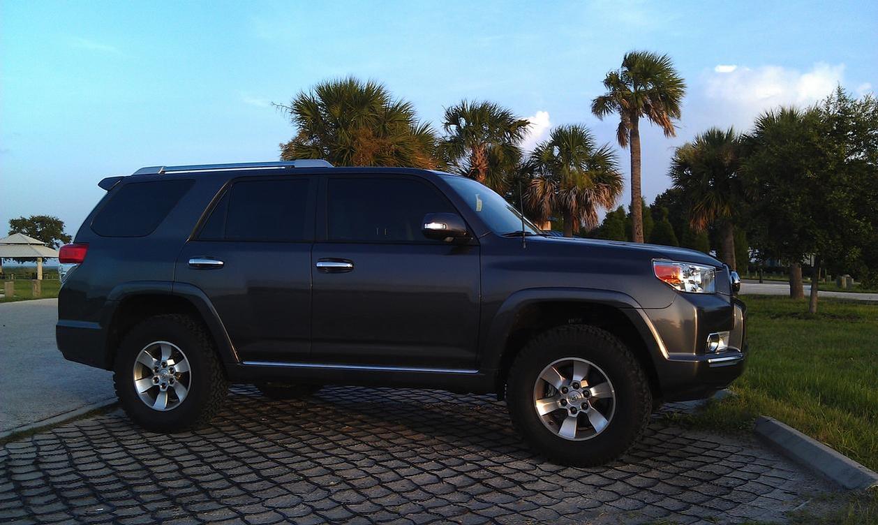

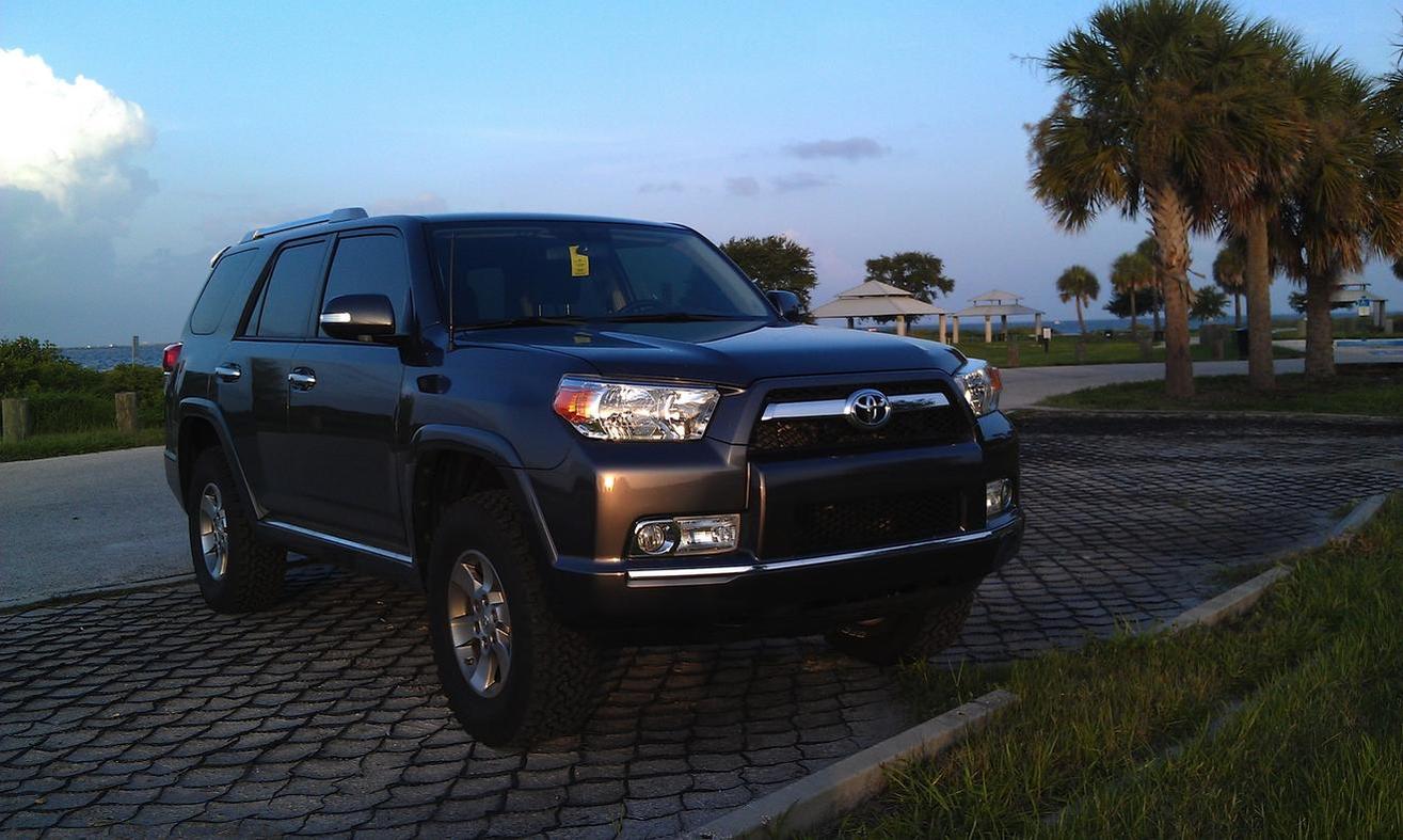

Bilsteins X4 w/front at 1.75 and stock rear springs, no rear spacer.
