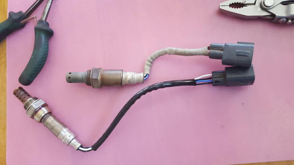

Hey fellas,
My GF and I swapped out both of her exhaust manifolds with the Dorman manifolds from Amazon, along with both Upstream O2 sensors (AFR). Figured, while we were in there, might as well do the O2 sensors. She bought Denso 234-4261 O2 sensors.
This is one of those relationship testing events. She did a lot of the work while I went to my job and cussed a LOT! She re-installed both manifolds and put all the nuts on them while I was at work. I'm not sure which part she hated the most - working with the tiny EGR connection at the rear of the manifolds or re-installing the lower factory skid plates. It was so satisfying to hear someone else cussing and throwing tools around for a change :eyebrows:

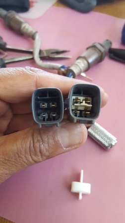

Trouble is, the 234-4261 sensors plug didn't mate up to the factory plug on the engine. Apparently, this is a hit/miss deal based on the Amazon reviews. The wire colors matched with the Toyota sensors - Black, Black, White, Blue. Some folks simply lop off the connector and swap them using butt splices. I took the more elegant solution, de-pinned both connectors and swapped. I took pics and made a note of which color wire goes into which port in the connector. It's really hard to mess this up but apparently I did!
Now she gets P0031 and P0051 - A/F sensor heater (bank 1 & 2) range check (low current).

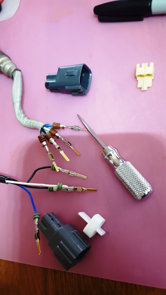

So, can someone tell me how do I match the above colors from the EWD to the Black, Black, Blue & White?
Using a DVM and a propane torch, this is what I determined:
Black wires are the heater wires. Resistance value changes based on how much I heat up the sensor tip. DVM is on Ohm setting
Blue wire is Positive voltage - DVM on DC volts
White wire is Neg voltage - DVM on DC volts
I'd like to use this knowledge to translate the wire colors.

This is good info, thanks. So, if this is the color of the front AFR sensors according to the EWD, any idea why do the AFR sensors on her vehicle have Black, Black, Blue and White color wires? Her sensors are the original Toyota AFR sensors.
The black, blue, and white are and have been standard for AFR/Oxygen sensors for a while now. If you look at the diagram you'll see that the coloured wires actually stop at the AFR connector, the blue/white/black is part of the sensor itself not the vehicle harness.
I imagine this is done because of standardization and thus multiple wire colors don't have to be used for production, just wire length when making sensors.
You are using the rear 02 sensors in place of AF sensors. Completely different. Reason the plugs were different.
That's what I was thinking also... but I thought he said earlier that the numbers matched what I linked he should have been using, so I dunno...
I think both of you guys are prolly right. When she bought the sensors from Amazon, I think she bought O2 sensors and not AFR sensors. Hence, they don't fit the connectors.
We tried multiple pinout combo to no avail so we'll return to the original AFR sensors. What is troubling is that the EWD colors that BlackWorks laid out above do NOT match the AFR sensor (Toyota OEM) wire colors that we removed.
Still, no biggie, if we end up sending these back and getting the correct part that BlackWorks pointed out previously.
Removing the sensors from the manifold has been a PITA and we need a special tool like this one on Amazon https://www.amazon.com/Oxygen-Senso...1493222502&sr=8-13&keywords=o2+sensor+remover
When we dropped the manifolds previously, the sensors came with them and it was simple to remove them. But now that the manifolds are on the engine, dealing with the AFR sensors is a PITA.
