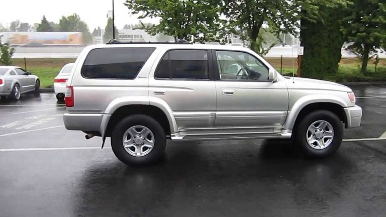

There is a difference between the wide painted SR5
as you said "sport" flares and the limited flares. The SR5's just go over the fenders but the Limited has side cladding that goes on the doors that is molded with the fenders. Both fender flares attatch with clips that go through square holes cut into the fenders and doors respectively although you may be able to attatch them in some other way.

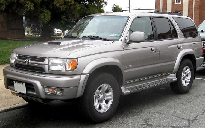

There is also a slight difference in the bottom shape of the flare itself. The sport flares would be much easier to install on one without the larger flares than the limited flares. As said above, they were meant to accommodate the bottom door cladding.

It was also an option on the 01-02 SR5's. Not sure about the 00's.
And to add, the options on the SR5's were the same flares as the Sports, not the Limiteds.
For op, Limited vs Sport flares
