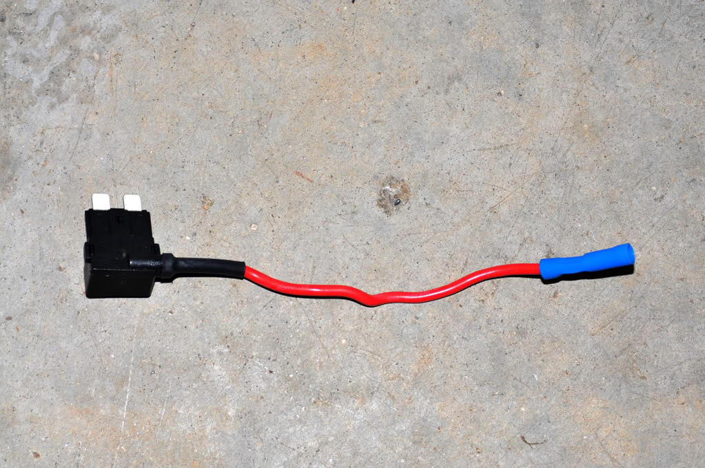

Is this what you are planning on using, or another type?
Just make sure you read the instructions carefully and those fuse taps work great.

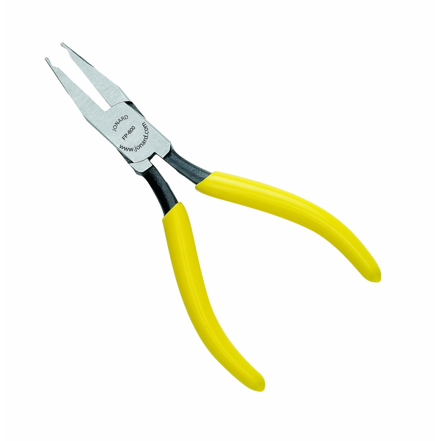

Now if I can just figure out how to pull those itsy-bitsy-teenie-weenie fuse wannabes
Anyone know of a tool or trick to make getting them out easier?
Anyone know of one of these fuse tap kits that are designed for low-profile fuses?
There's a fuse puller in the underhood fuse box.
That is OK for emergency use or in a pinch. I'm in the market for a full size puller that will work with all our fuses that I can add to my toolkit. My old one is like a pair of needle nose pliers but won't grab the low profile fuses. Time to wander the isles at Amazon
