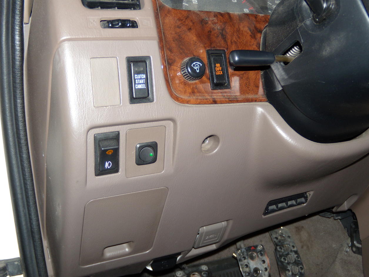

I'm running out of spots to put switches. I still need to put switches in for the Andy Mod and one for an auxiliary fan.
The one spot that I do have open is much bigger than the switch that's going to go there.
Also, why did Toyota put the seat warmer switches here. They should be somewhere near the center console so the passenger can control it themselves.
I'm open to any ideas and suggestions.

actually its pretty easy to cut a spot out for a switch just tape up the spot and use a small cutting wheel to cut out a new one.
Here's a picture of two switches in the larger panel.
- Matt
Nice. That looks pretty good. Did you have to cut out slots in that plastic insert?
Also, where did you get those switches with the green light? The switch I picked up at Toyota today just has a printed fog light logo on it.

I never have understood why the passenger can't control their own heater. Never did make sense to me. Probably just convenience for Toyota to place it in those slots to left of the driver. You could probably splice in a jumper and run that over to the center console-but then where would it fit over there? You could perhaps run the seat heaters switches to each side of the console-below the arm rest at the expense of the storage space inside. Then you would free up those two switch holes.
Aftermarket radio or stock? If you go after market then go single din size and free up the pocket below the radio for adding several switches. extensive pics in my Facebook link.
Several manufacturers make those size of switches-I saw some at the Jeep and Truck Fest show at the Merchandise Mart a couple of weekends back. It is fairly easy to drill out a hole in the switch cover plates like mine: I used the small green lighted round switch (from Hella) for my rock lights and a Toyota factory switch for my Hella driving 500s.

I wish I had a rear locker! Unfortunately, it's an '01 and that's a center diff lock switch.
I have the stock radio. It's the one with a cassette and 6 CD player.
I was thinking of doing the center console mod and putting the seat warmer switches in the slots if I can find a reasonably priced center console with those switch inserts.

The large spot that you have open can fit 2 of those rocker switches if you trim the sides of them. That way you wouldn't have to cut up the large switch cover.

I cut out some rectangular openings in the plastic cover to fit the switches. The plastic cover is a few dollars at the dealership so it's easy to replace if you need to.
Here's a link for the switches:
https://www.surpluscenter.com/item.asp?item=11-3237&catname=electric

There are no slots on the 99+ console to put stuff, the 96-98 console had 4 spots, and i took the switch covers off of them cause i knew they would come in handy one day. They are the size of the seat heater switches.
