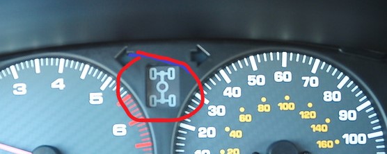

What should dash show in H4/AWD?
4 What lights should come on the dashboard when the 4WD button is pushed? Are there separate lights to recognise the button-push and confirm that the system is engaged?
Does anyone know whether the wheel icons on the dash or the circle in the middle of them should be lit up when the button on the shifter for H4/AWD (4HI unlocked) is pressed?
When I follow the manual and the instructions in this thread to shift into H4/AWD at speed, the circle in the middle flashes orange for about 30 seconds then turns off. I hear a click in the transmission but don't really feel any kind of difference in steering.
If I depress the button, the same thing happens, but the light doesn't stay on.
My mechanic swears that 4H is engaging, but I'm not so sure.
If I use the shifter to go into H4L (4HI unlocked), the circle stays lit orange, and I can absolutely tell it's engaged properly.
It seems weird that nothing indicates that the H4/AWD is properly engaged, so I'm wondering if the four tire graphics should be lit in orange or green and I simply have a bulb out. My dash overall seems a bit dim compared to newer vehicles I've had, so I'm hoping that a bulb is the issue and that the 4H works, given that winter is coming.
I've done about as much research on this as I can and appreciate any input.

In unlocked 4H mode, the wheels should be green with no center orange light on. When you go into H4L (center diff locked), that is when the center orange light will illuminate indicating the center diff has been locked and you are in “true” part time 4WD. The reason you don’t feel any difference with 4H unlocked is because it’s essentially just AWD since the center diff is unlocked allowing slippage between the front and rear diffs. This is what allows unlocked 4WD to be used on dry pavement.
