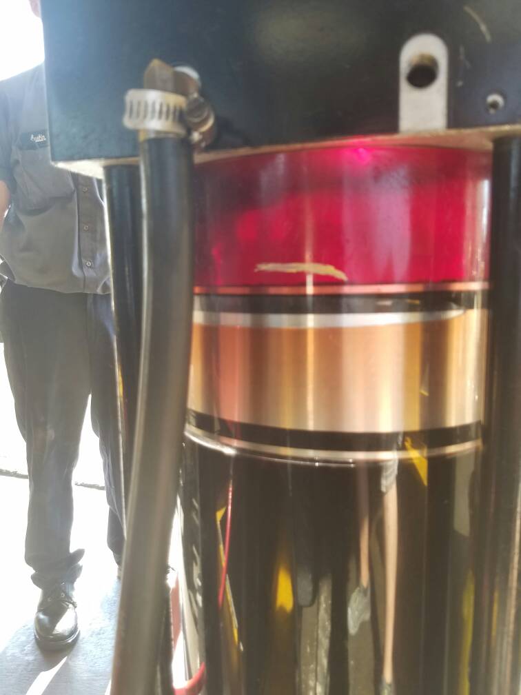

So yesterday I decided to have a transmission flush done. They use this cool tool that looks like a giant shock without the shaft, but has a cylinder that separates the old fluid from the new. Hose comes out of the top and bottom. They then pull the Trans lines on the radiator and they hook them up to the cylinder. You start your truck and the pump in the Trans pulls the new fluid in and pushes the old fluid into the cylinder. It's all controlled by your Trans, no electronics, and it ran 14 liters through. Here's a pic.. New on top, old on bottom.
The old fluid literally looked like mud!!! O.o anyways, no more surging, failing to shift, random downshifts, taking forever to shift, anything. It literally hasn't shifted so good since the day I bought it 80k ago! It used to take a long time to shift onto second and it was retarded soft about it. Now it hits gears firm and immediately. It also felt like it was dragging when getting on it before, now it just goes. If the Trans doesn't fail in the next month I'm going to pull the pan and put a new filter in it too. Might look into a shift kit of some sort as well. Anything to help it spin these heavy ass tires.

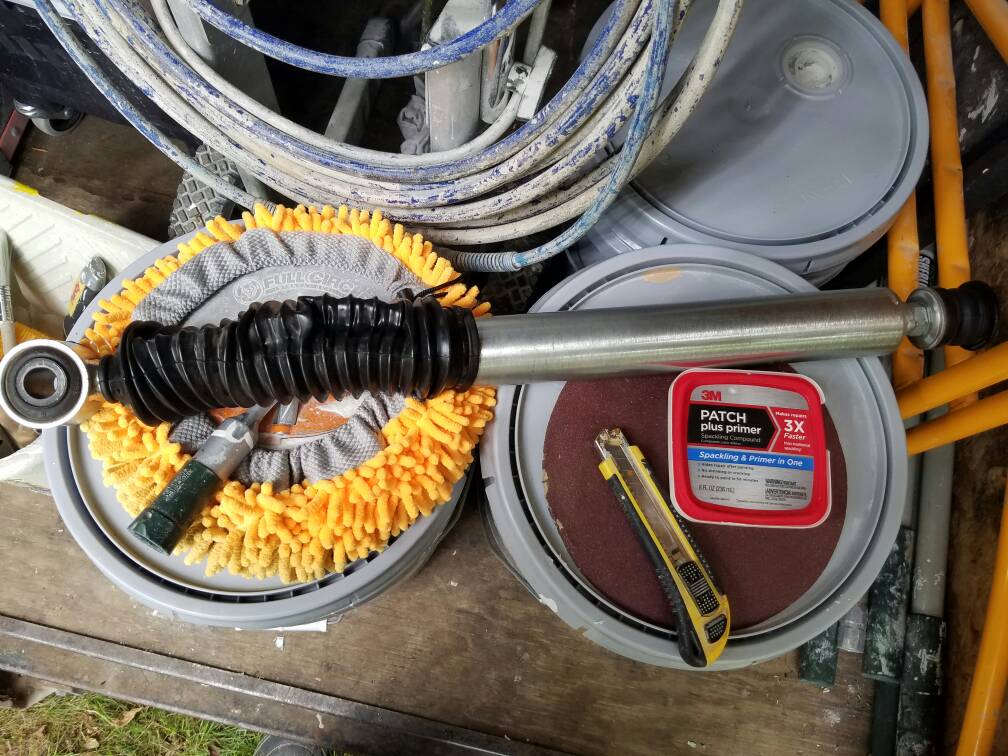

I also got my shock from [MENTION=117408]Oneluv13T4R[/MENTION] to replace my broken one. Thanks bud! Wish I was anywhere near Cali to come play with you guys out there!

So this has me wondering why did your ATF turn so yucky? I'm guessing you overheated the ATF few times or maybe the clutch discs (I think they're called) are coming apart. So, perhaps do a few more cycles of ATF cleaning in the next 12 months or so?
In my case, I simply drain whatever comes out during every oil change and then put in the same amount of new ATF. It's not a true flush/fill but gets the entire amount changed out over time. I tow a lot so I'm always on top of the ATF swap routine.
Well if it's never been changed before, 220k miles, towing, heavy tires, trail riding locked in 1st or 2nd gear lots of city driving, then I'm going it is just so worn out. If it's clutches etc going bad, I assume I'll find out soon. Lol
