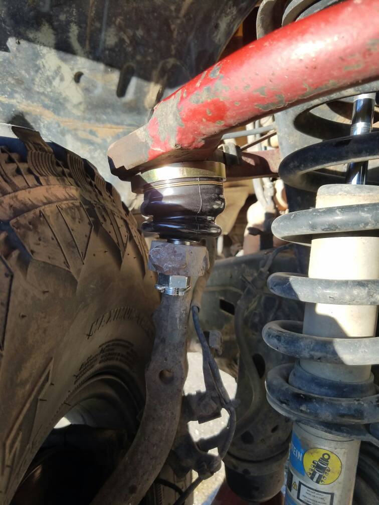

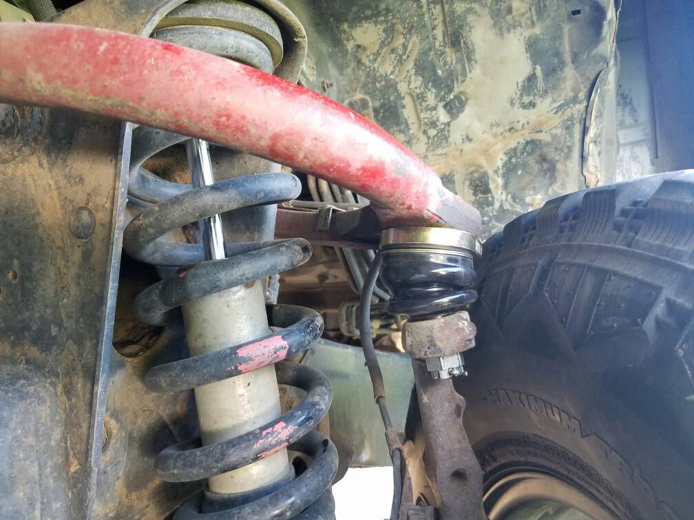

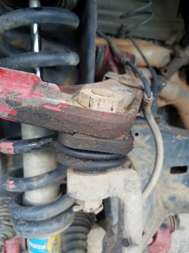

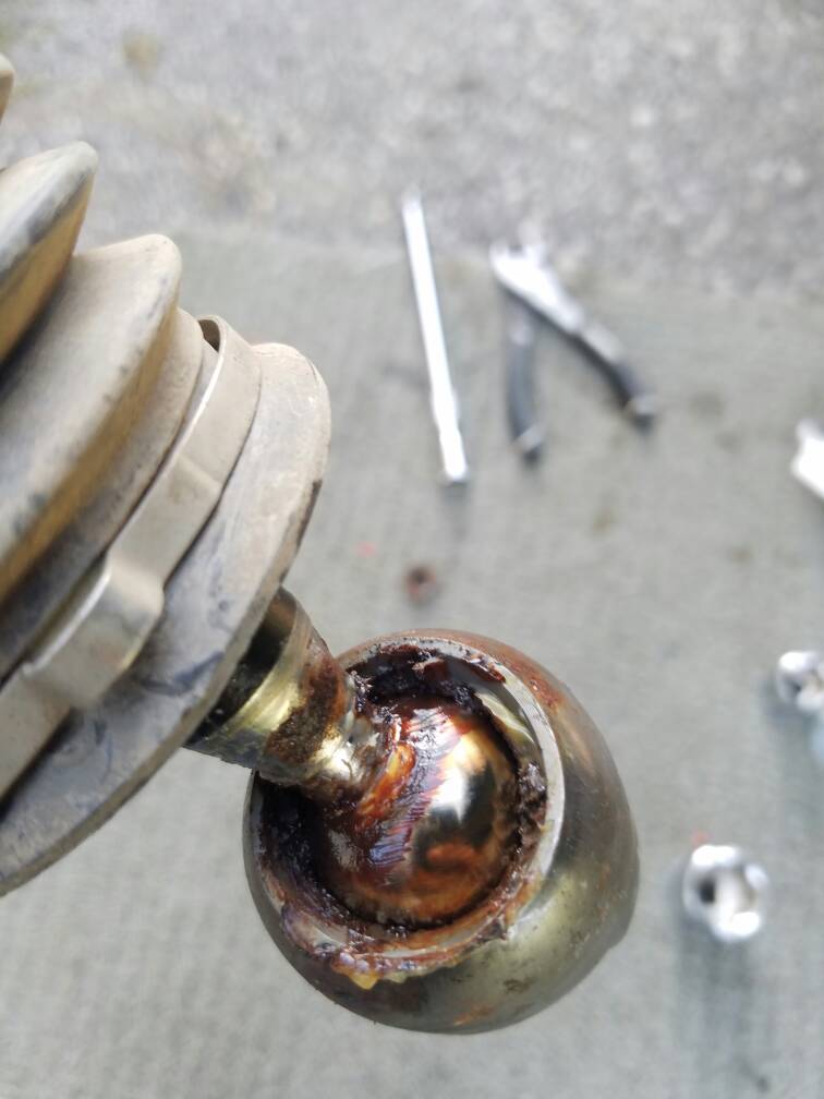

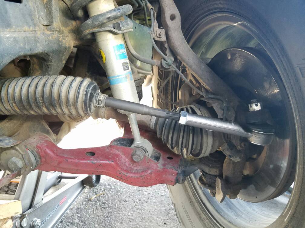

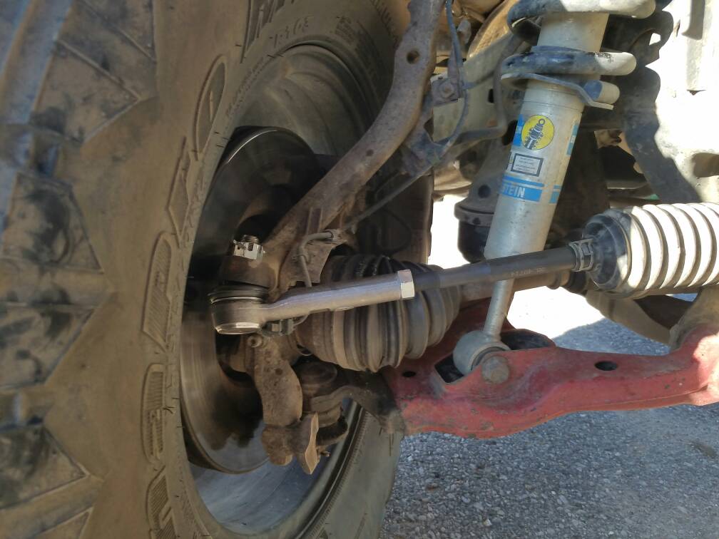

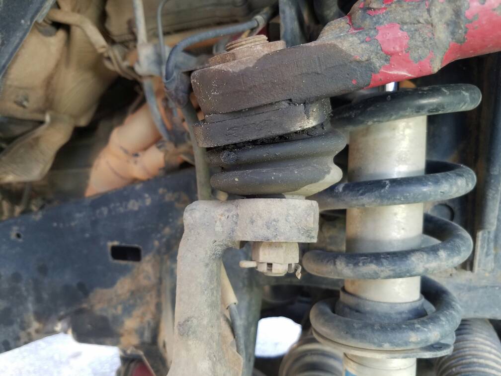

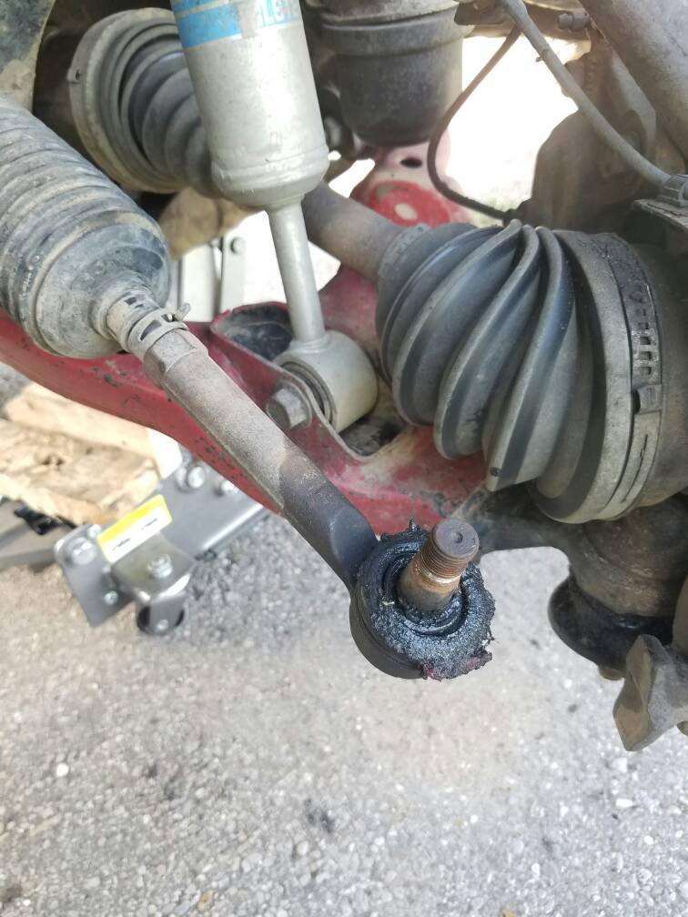

Installed new inner and outer tie rods today, also spc warrantied the upper ball joints and gave me the new design. Installed those as well and turned them up for 4*+ of caster. Alignment tomorrow.

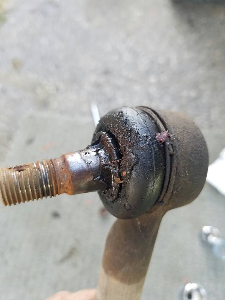

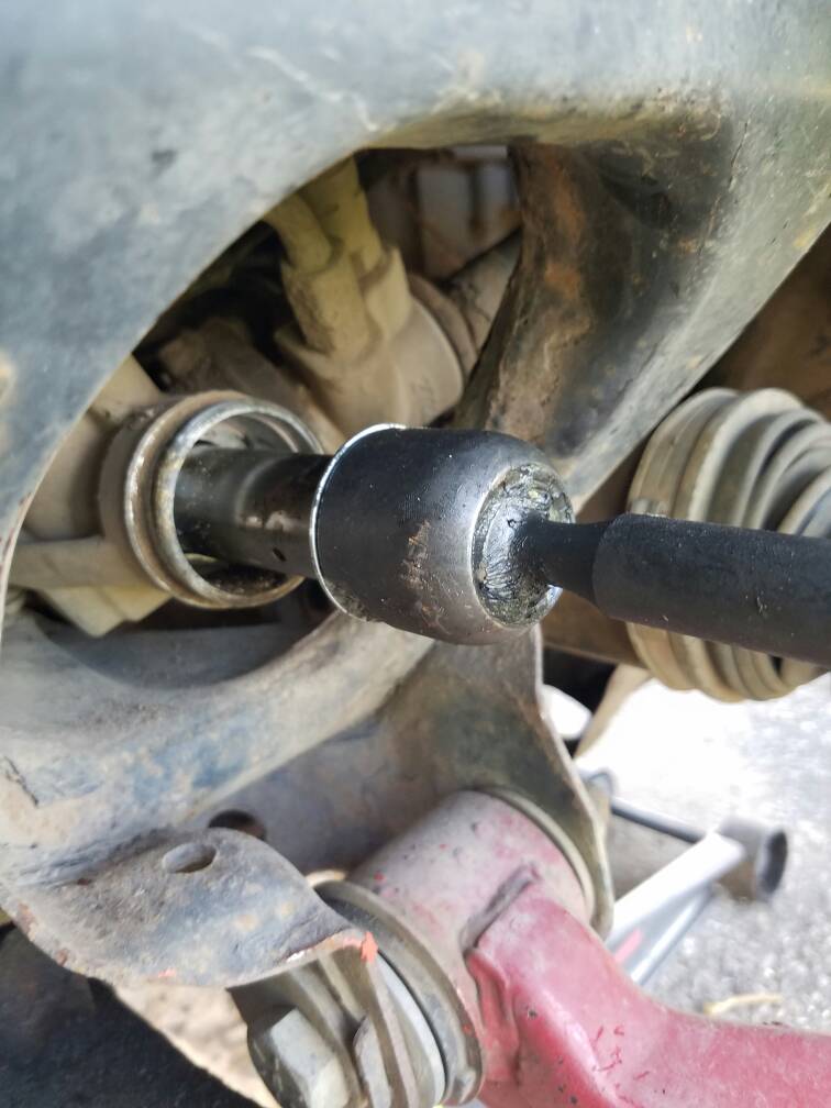

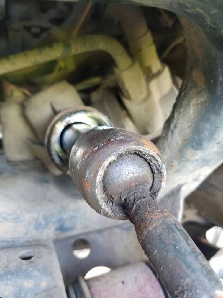

Tie rods on drivers side were so bad I'd consider them dangerous... There was a solid inch of play in the system and once off they flopped around all loose. Inner side was completely dry and the ball was all pitted. Not a great situation... Passenger side was bad but not dangerous I'd say.
drivers side
Passenger side

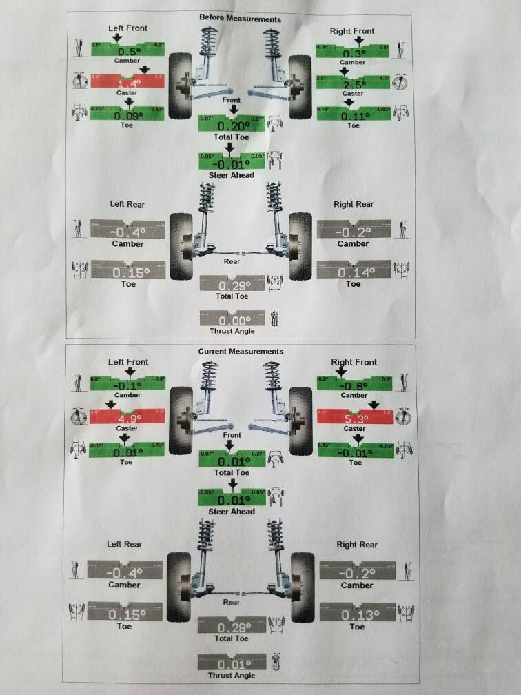

Interesting day so far.... Stupid alignment shop tried telling me they could only get 1.1* of caster and everything was in spec. I called bullshit, especially since I have the balljoints set at the 4* setting already! Left there and am now struggling to find a shop with an opening...
Guy said it's in spec, yet it pulls all over the road, pulls to the right when hitting the gas, to the left when hitting brakes, and is visually toe'd out.... Wtf man.

New shop was able to do my alignment without issue. Old numbers are the shop this morning that apparently are worthless, new shop and final specs on bottom. They noted that my passenger uca bushings are worn and allowing some movement... So I guess that's next on the list.

with that much positive caster does it seem to wander all over the road?
