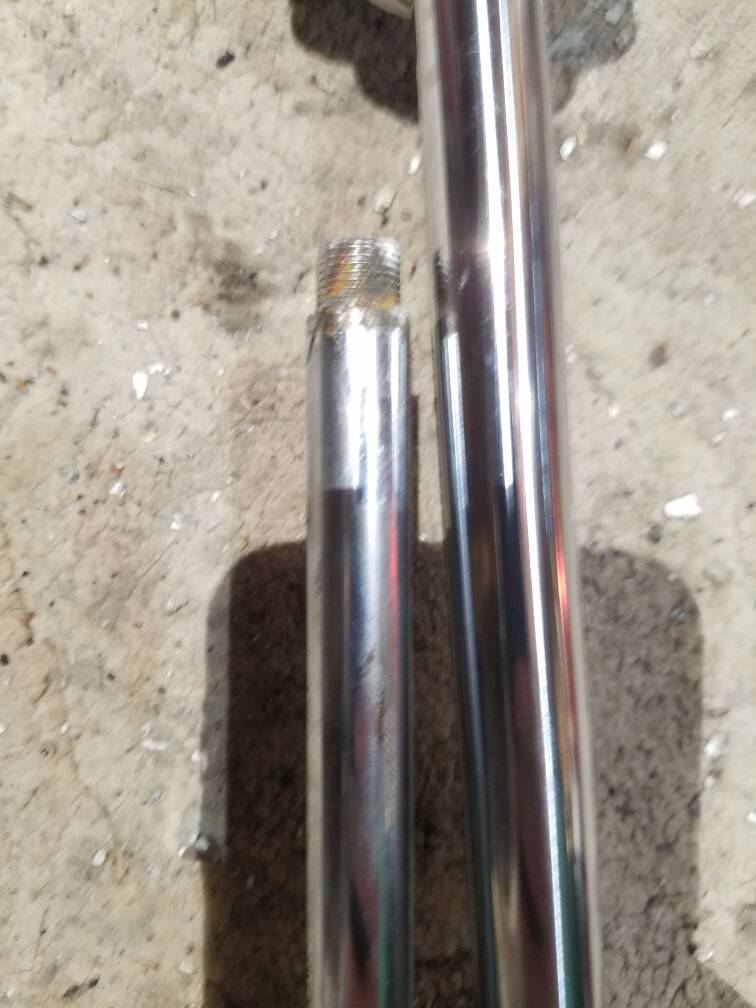

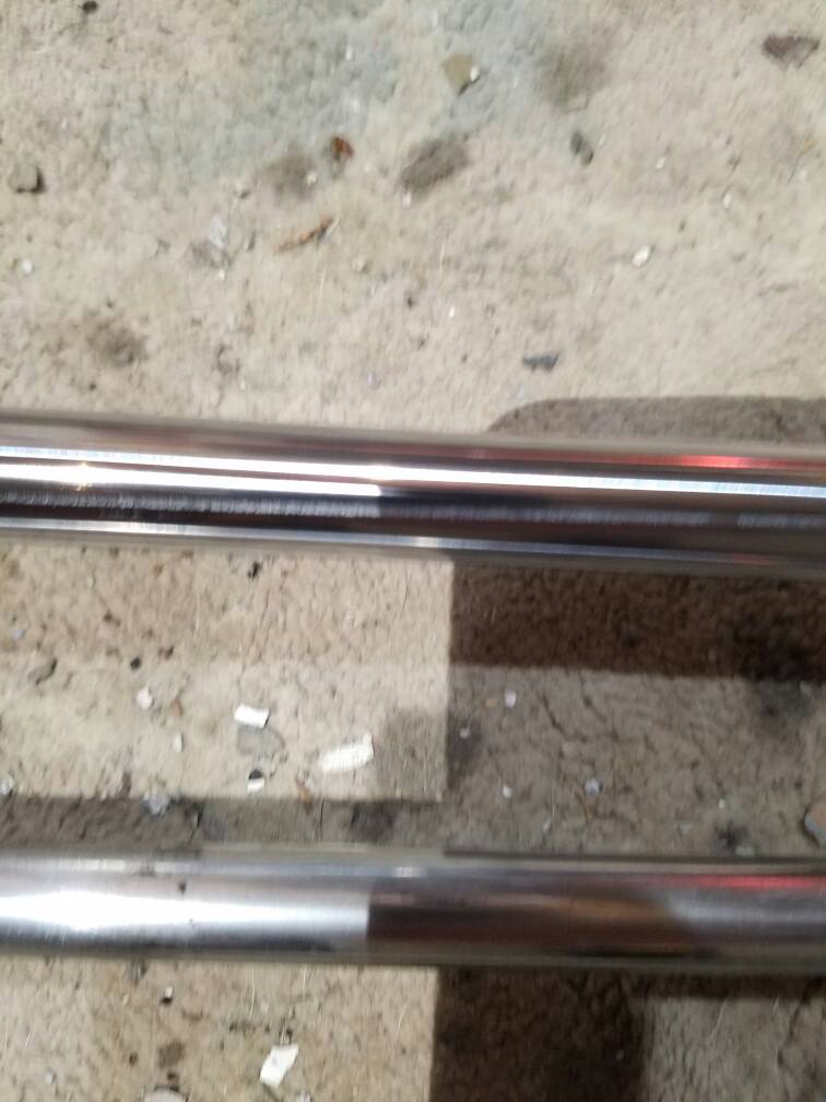

Well, the other rear bilstein bit the dust. Truck felt weird and I looked under at the axle and the passenger side shock has broke exactly like the drivers side did. Pulled right out of the threads... Stupid Bilsteins!

Dude, you over extended the shocks is my guess!!!

They've been leaking for almost a year. My guess is it ran out of fluid and seized up like the other side.
But yes, I'm sure they've been over extended a ton! Lol

How many miles did you get out of them? Feel like they did their job well despite breaking now?

I've hated them since month 4. To stiff, can't keep up at all, and although I have around 60k on them, I'll never buy another bilstein product. Blew a front out before too.

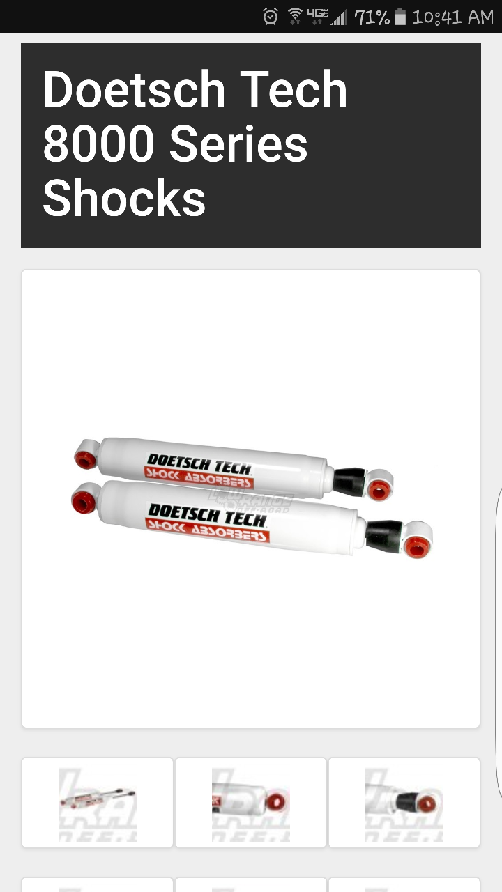

What are you planning on replacing the Bilsteins with?

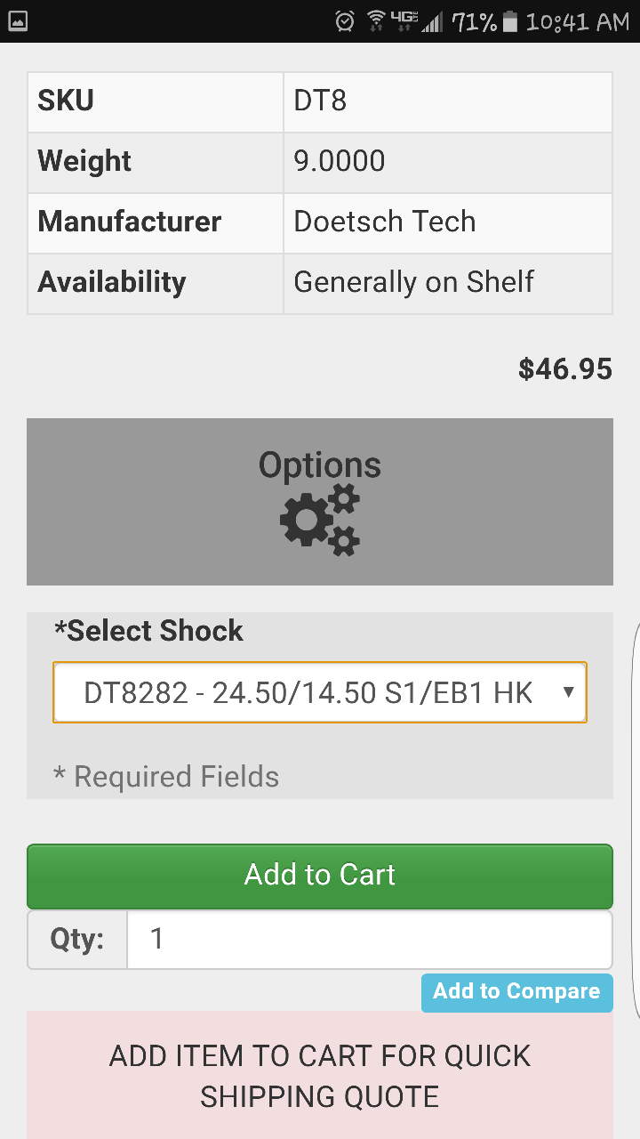

Ok, settled on some rear shocks. Did a ton of researching, still can't afford Fox or Kings, so I'm going with these. http://www.lowrangeoffroad.com/doetsch-tech-shocks-8000.html they are 24.5" extended and 14.5" compressed, have a built in bumpstop, and are firm to control hard bumps and such, which is a leading cause of my Bilsteins failing and inability to keep up. I plan on adding superbumps after I get these installed and adding a spacer as needed to make sure the bumps stop at the stopping point of the shocks, or just before.
I wanted to get longer shocks, but can't until I can afford metal tech long travel coils. The 10" of travel on the ones I ordered should be more than sufficient for now.

These are the 8000's, which are valved much firmer for prerunner applications, the 3000's are soft. I read many reviews and the only bad ones was that they are to firm, but every single review like that was guys using them on a Jeep Wrangler, which is shorter and much lighter. I'm not going with the kit specific to the 4runner either, I found the shock with 10" of travel, which is all I can use until I get longer coils. I'm hoping they will handle and hold up better than the Bilcraps!

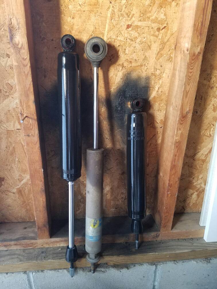

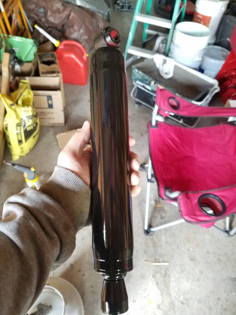

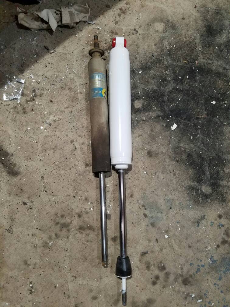

Got my new shocks! Massive compared to the bilstein. Painting then black and putting a couple coats of engine enamel clear over them.

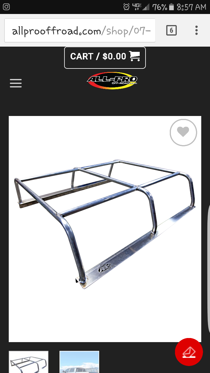

Well, hopefully an addition, if financing plays nice... I need a bigger truck, and a truck with a bed too. I love my 4runner and it won't go unless there's just no other way. If I get the Tundra I'll be looking at building a rack like allpro sells,
But I would build it myself and make it even with the roof top, then build a rack over the top to hold ladders, sheets of sheathing/drywall, whatever comes up, as well as anything I'd like for offroading. I'd also get 17" rims and step down to 38-39" tires instead of the 40x15.5x20 setup it currently has. Lol

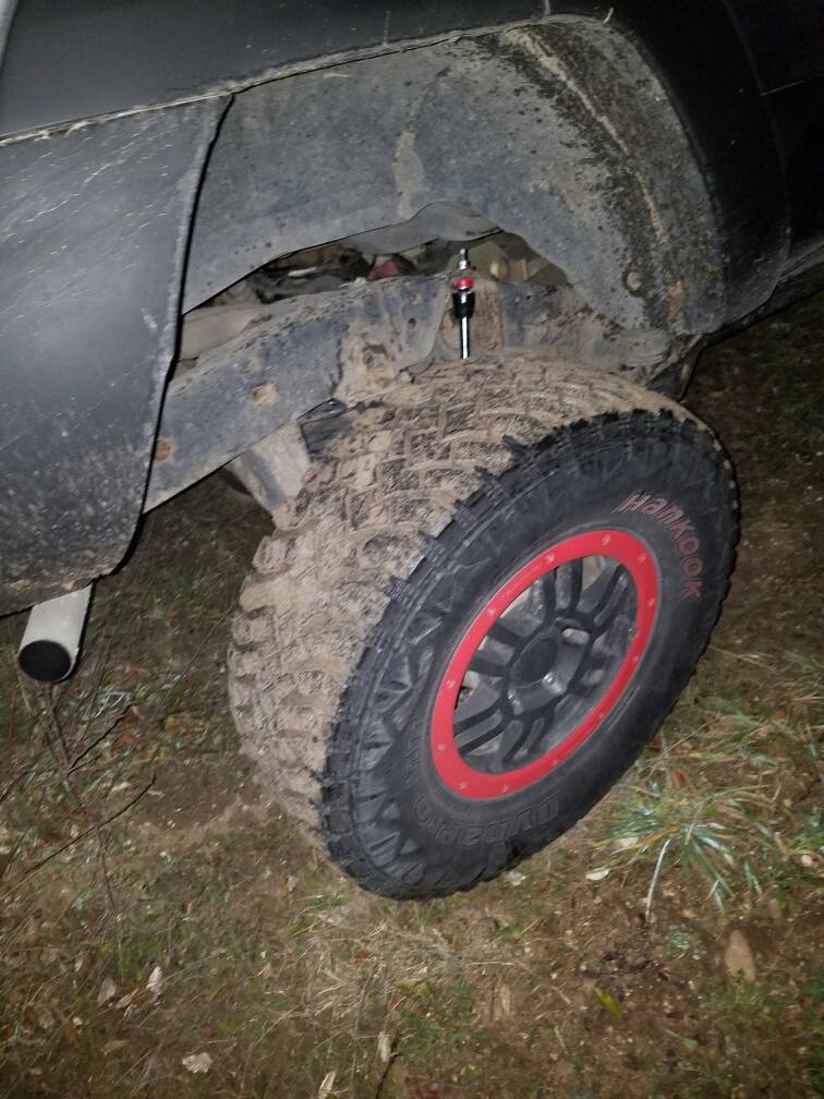

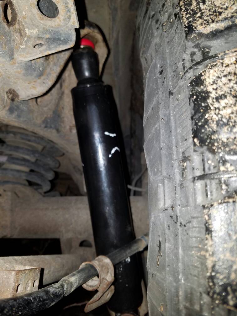

Installed! Flexed it in neighbors yard... scratched them a little installing, sooooooo will have to do some touchups. Will give them a test over the next few days.
