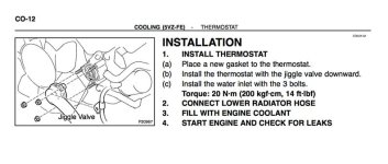

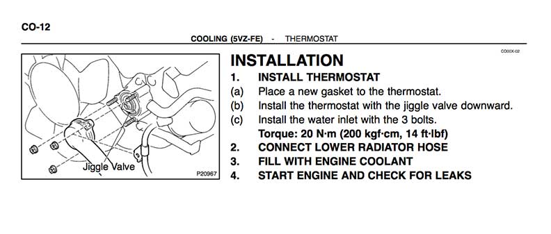

Well I'll be danged… Haynes disagrees with the FSM! See attachment.
FSM simple says "Install the thermostat with the jiggle valve downward".
I pretty sure I put mine in the 12 o'clock position and run around 200°-205° in most situations I have monitored it. I always thought that was a slightly on the high side as I'd heard lower T's reported here.
Hmmm… Opinions….?
Edit: A little investigation reveals this is a common debate; 12 or 6 o'clock. That said the purpose Jiggle valve is it vents the air trapped inside the cooling system when filling or topping up the system with coolant and hence ensures the 'full coolant no air trap' condition in radiator and water jackets. This would make me think 12 o'clock better as air rises… The couple of threads I found most folks place it at 12 o'clock…YMMV
