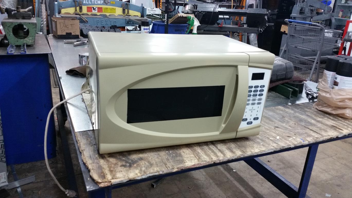

It's snowing, so I'll have to wait on painting outside. Painted the microwave and it looks sweet

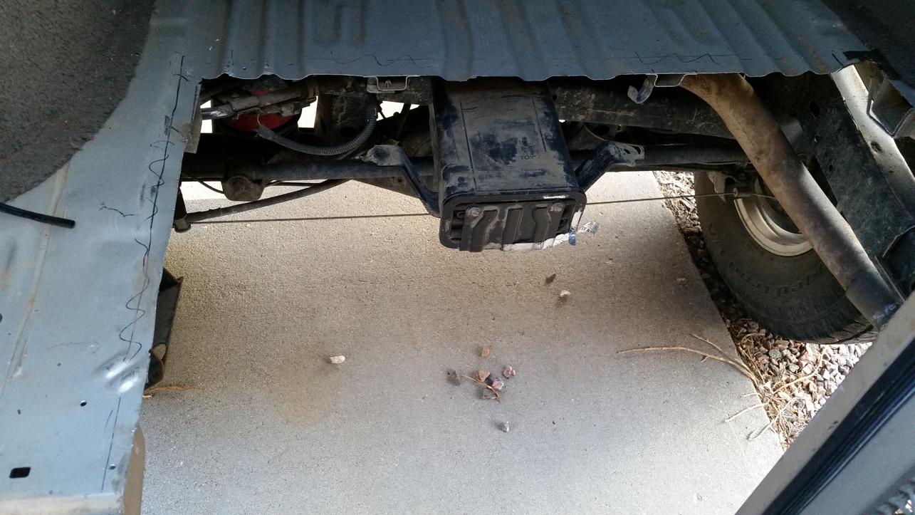

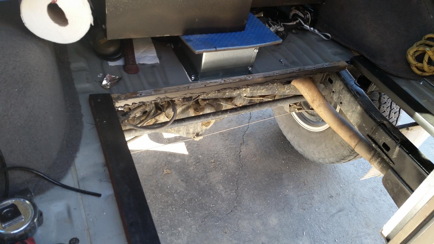

The next move is the vapor canister. I want to put in a larger floor. not sure how gravity effects the pitch of the lines. I don't think they will ever have liquid in them. But I think I need to keep it pitched towards the fuel tank.
That was fun. Turned the vapor canister 180 degrees and put it inside the truck. Then I cut an opening in the floor and put a sheet metal box over it. I extended all the lines but one with a weird coupling I couldn't replicate or extend.
Then I surrounded the opening with square tubing to conceal all the metal screws. It also allowed me to silicone the perimeter and undercoat without the floor in. It also keeps the floor removable for working on the suspension without crawling.

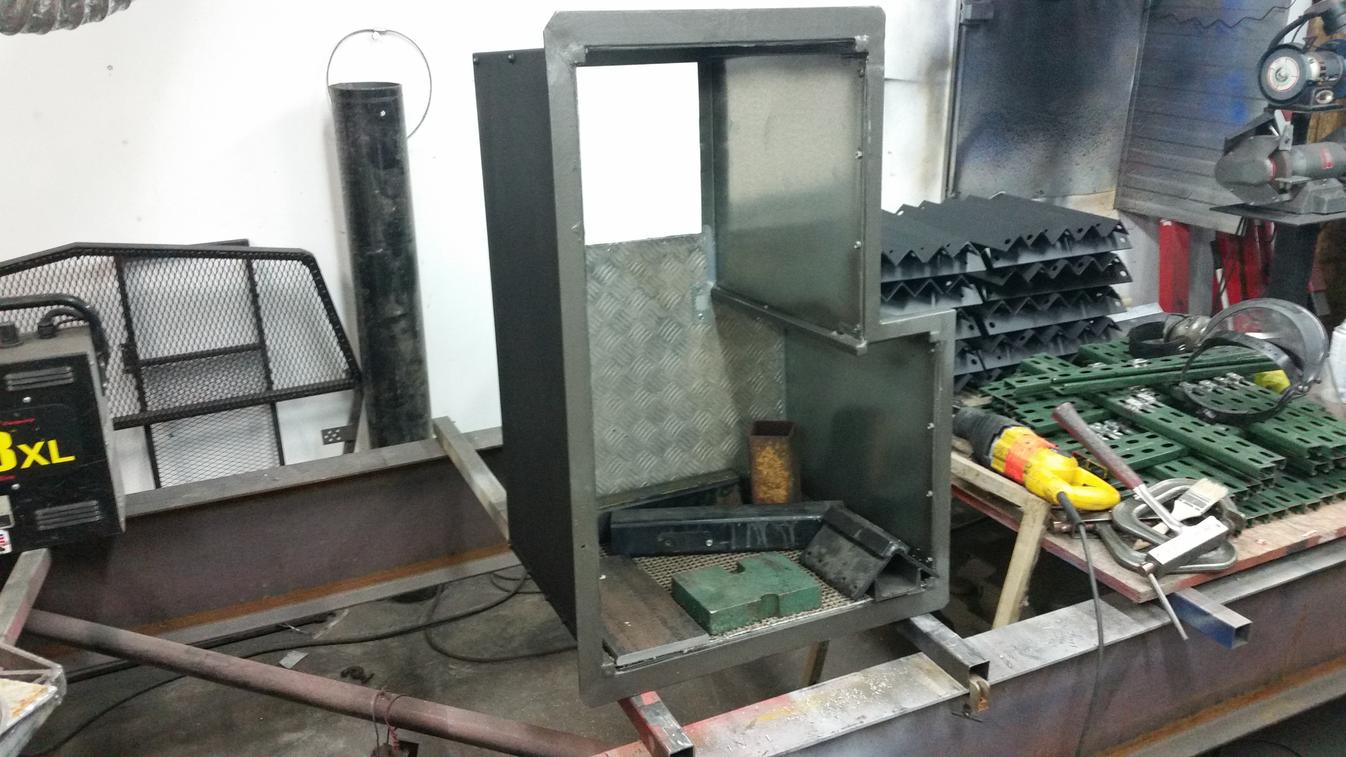

It starts. Just built the rough upper frame of the raised roof. The top deck will be aluminum diamondplate. Should give nice headroom for the flat screen tv...

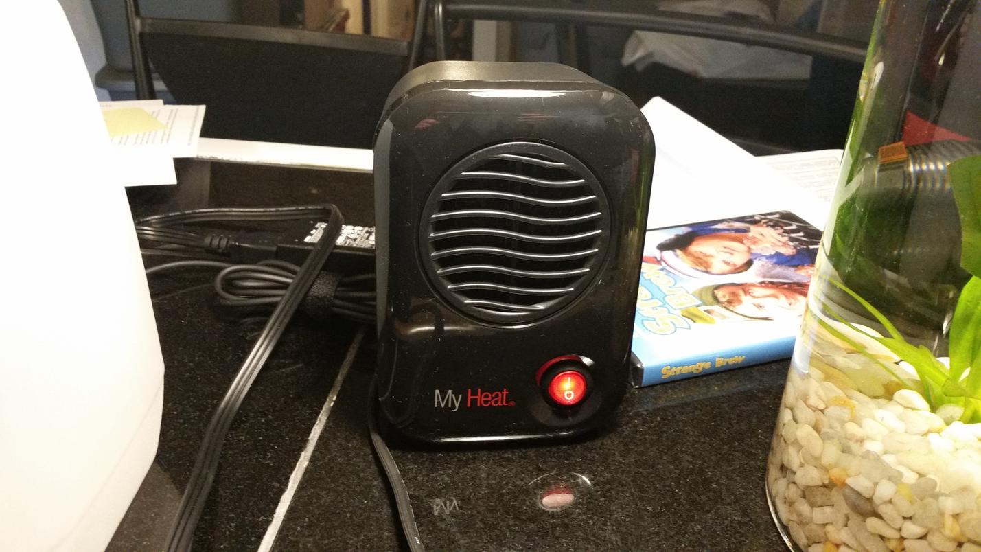

Just bought this tiny heater that only uses 200 watts. Got it for $15 online and it puts out decent heat. I'm mounting it in the back of the truck to add heat while the generator is running. I should be able to used everything but the microwave without turning it off.

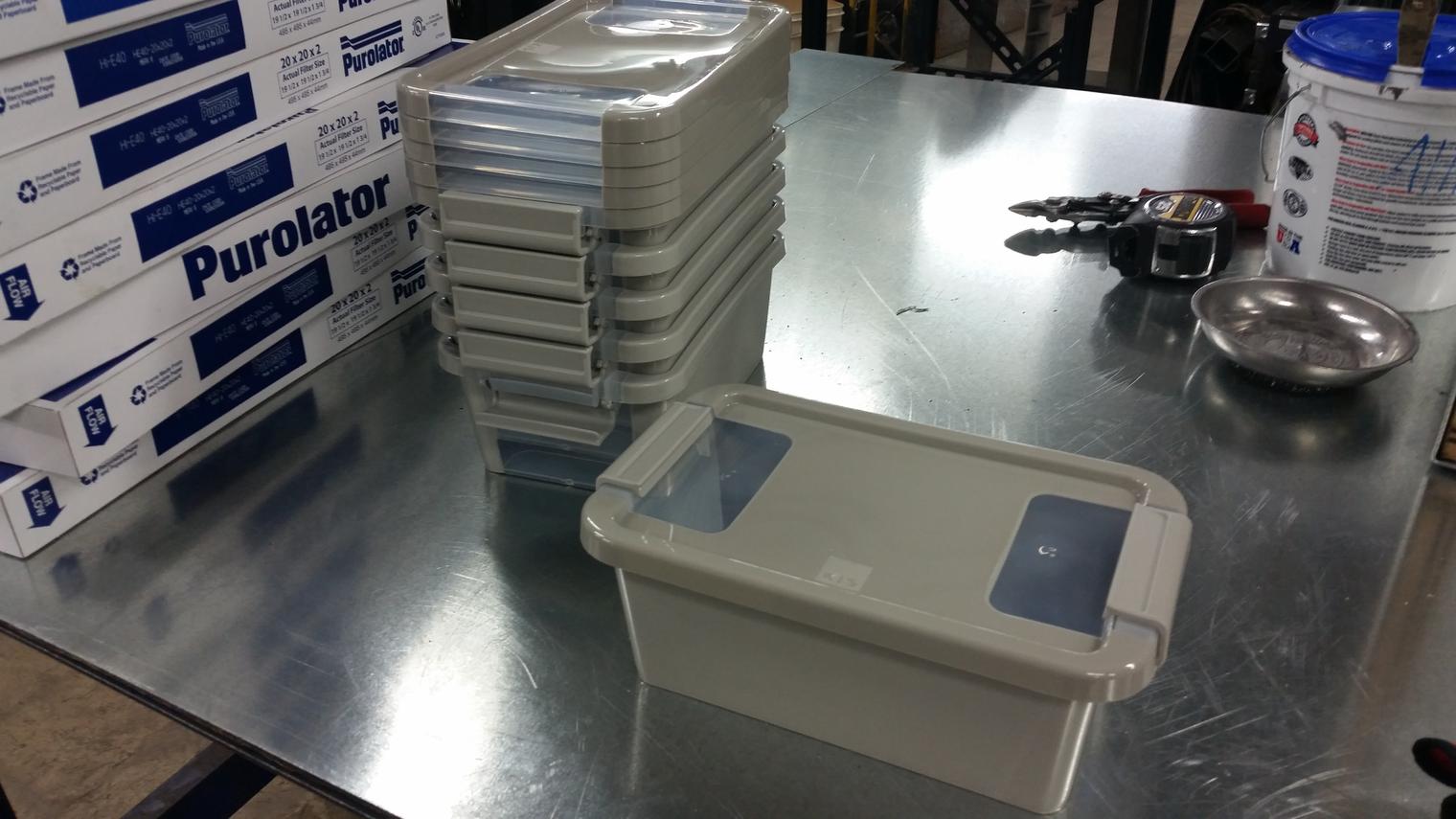

Just picked these up on clearance for. 98 cents each. Gonna put together a rack for them. They kinda match the camouflage.
