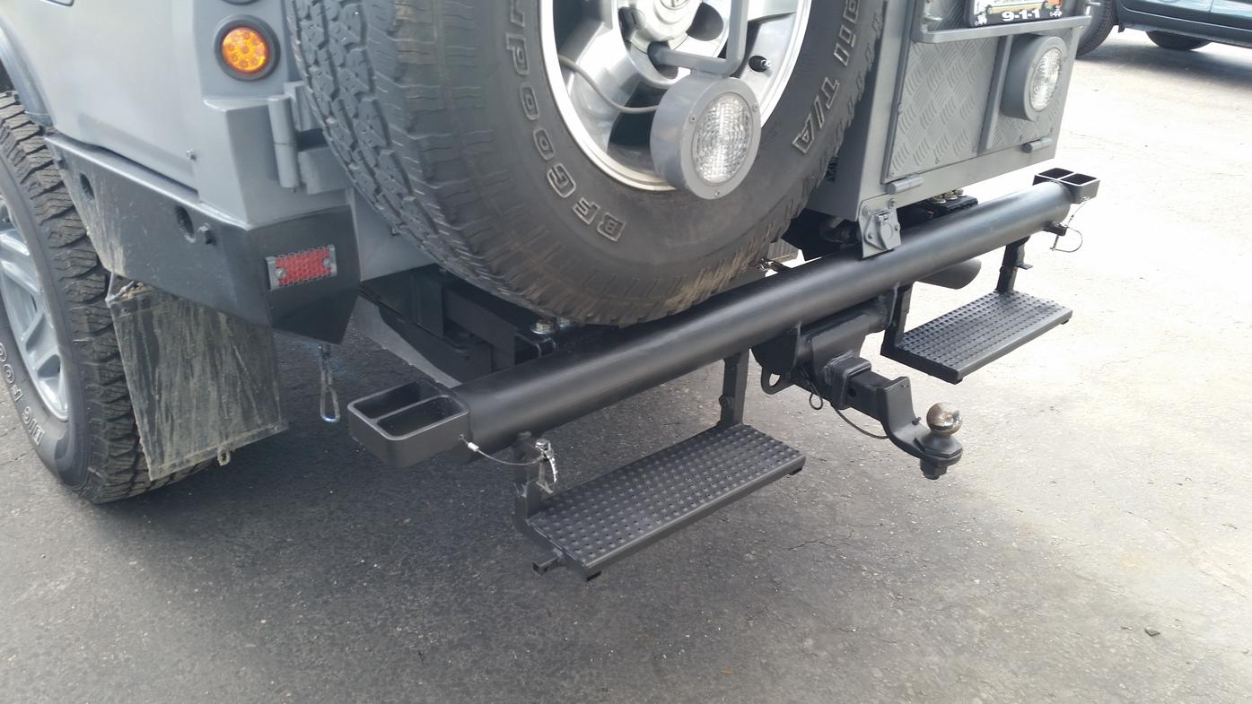

Question: On your rear bumper, what are the clevis pins for?
Just curious.
-Phil
Just curious.
-Phil[/QUOTE]
Thanks, they hold up the steps when raised up.

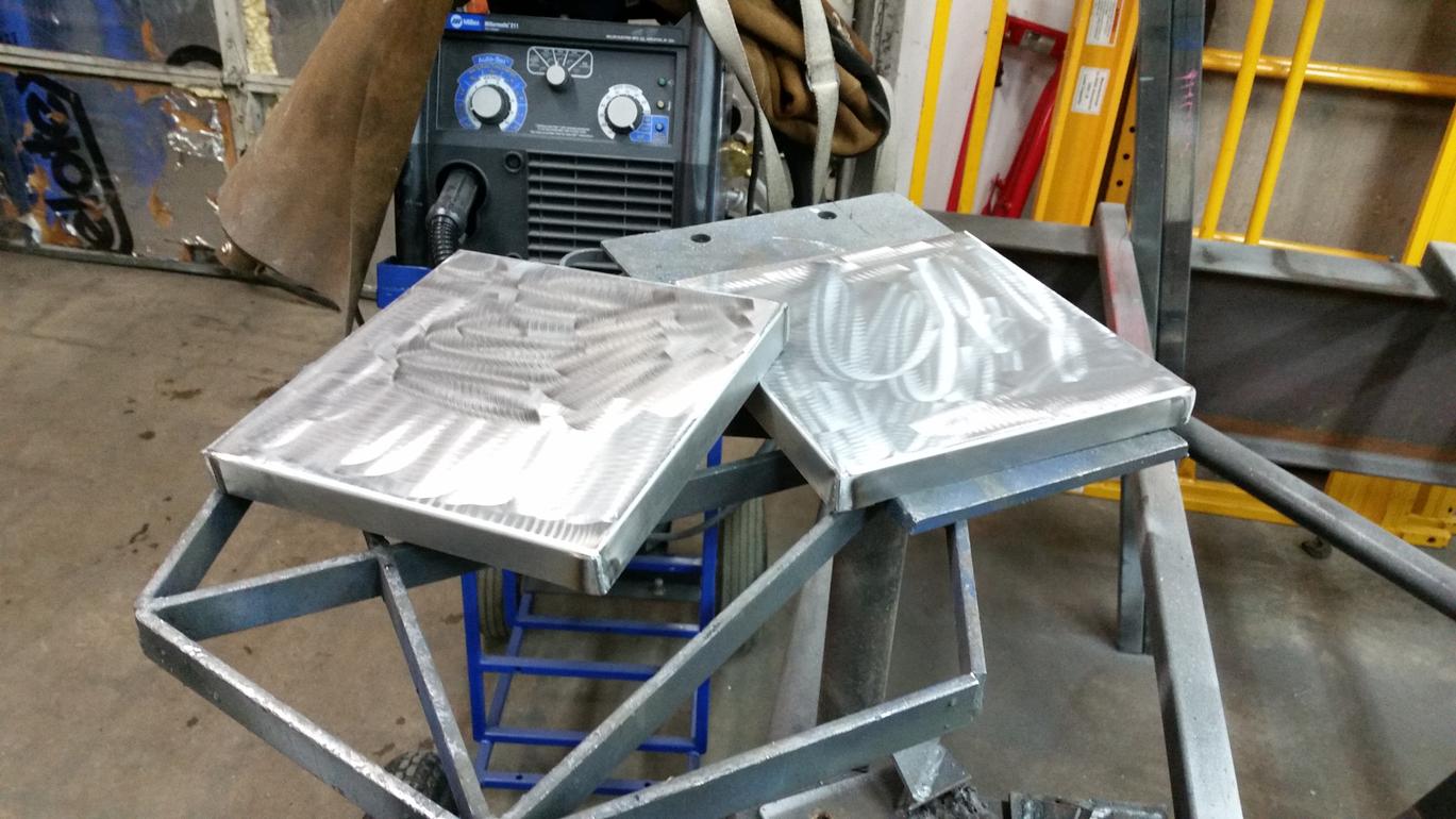

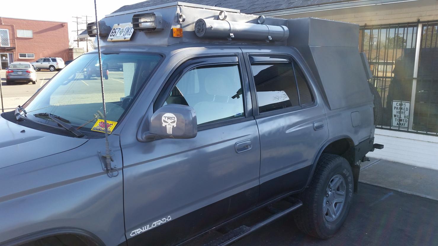

Getting back to my truck finally. I'm extending the back section and ultimately getting rid of the rear windows so I can fit the microwave above the sink and counter. Here's the roof extensions.

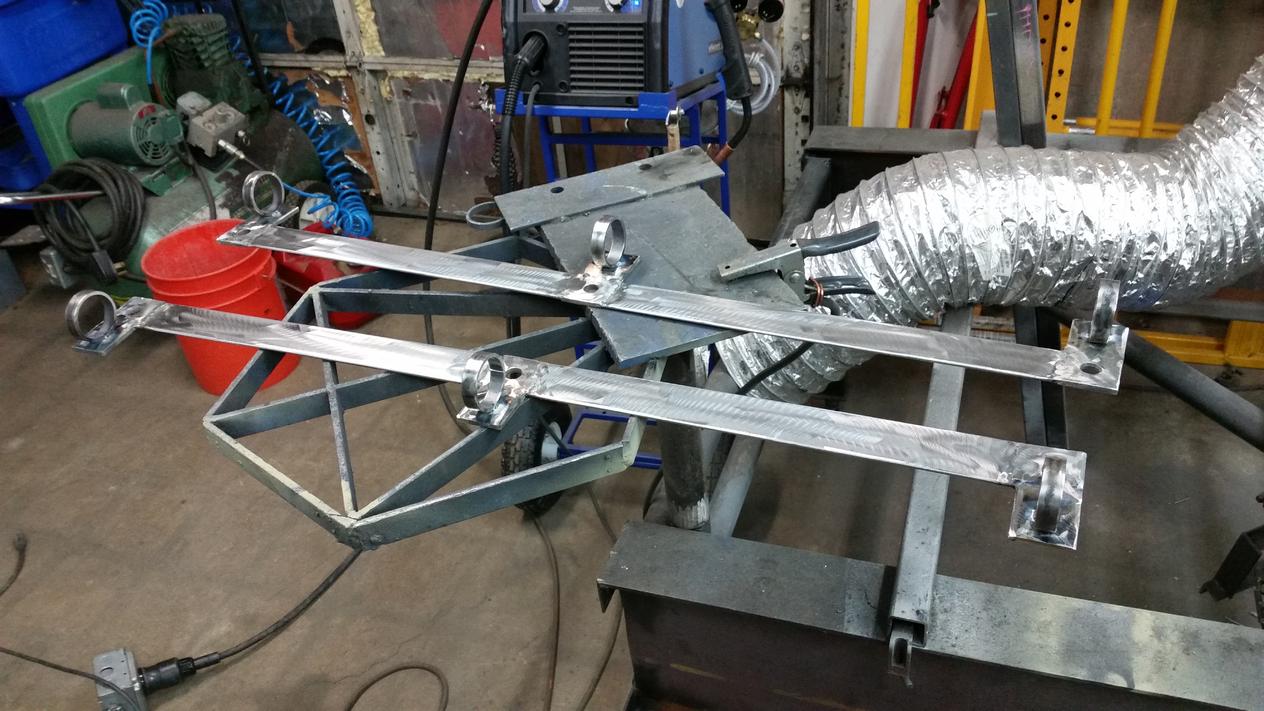

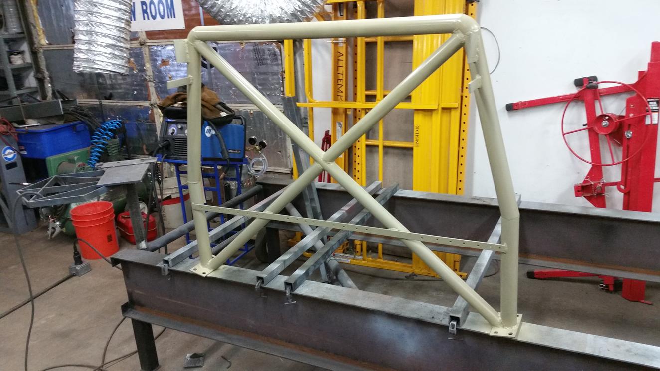

Time to start the inside. Building a roll bar next to strengthen the frame since my kids ride in the back. The electrical conduit is the pattern.

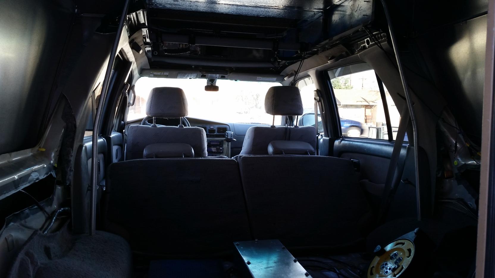

Roll bar is ready for installation as soon as the paint dries. I'm going with ultra flat khaki camouflage paint for the interior.

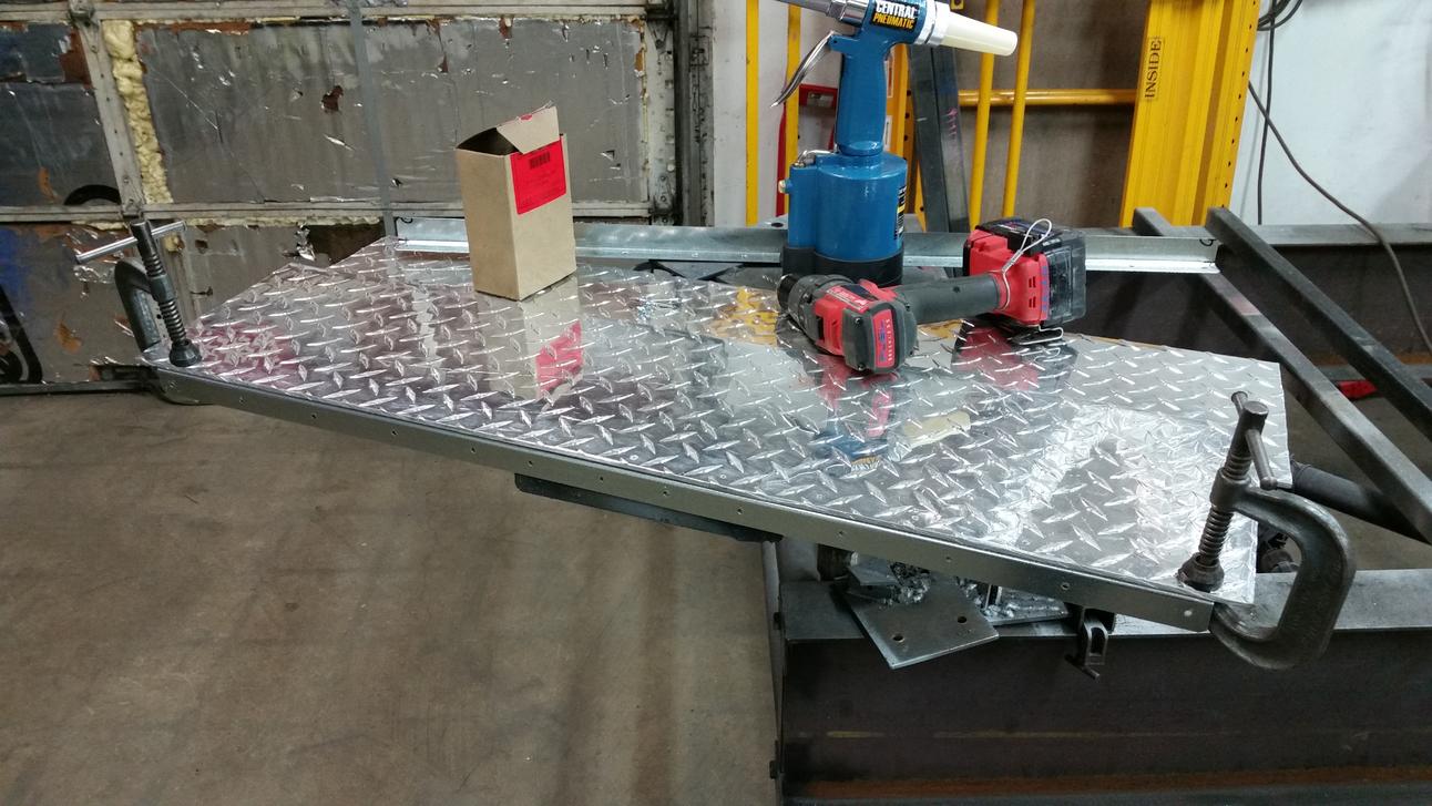

I'm putting tie downs along the sides of the new addition. I connected them with bars to hide the horizontal seam and I'm using 1/2 inch bolts to give it a heavier look. The bars are actually folded 24 Gage sheet to save weight.

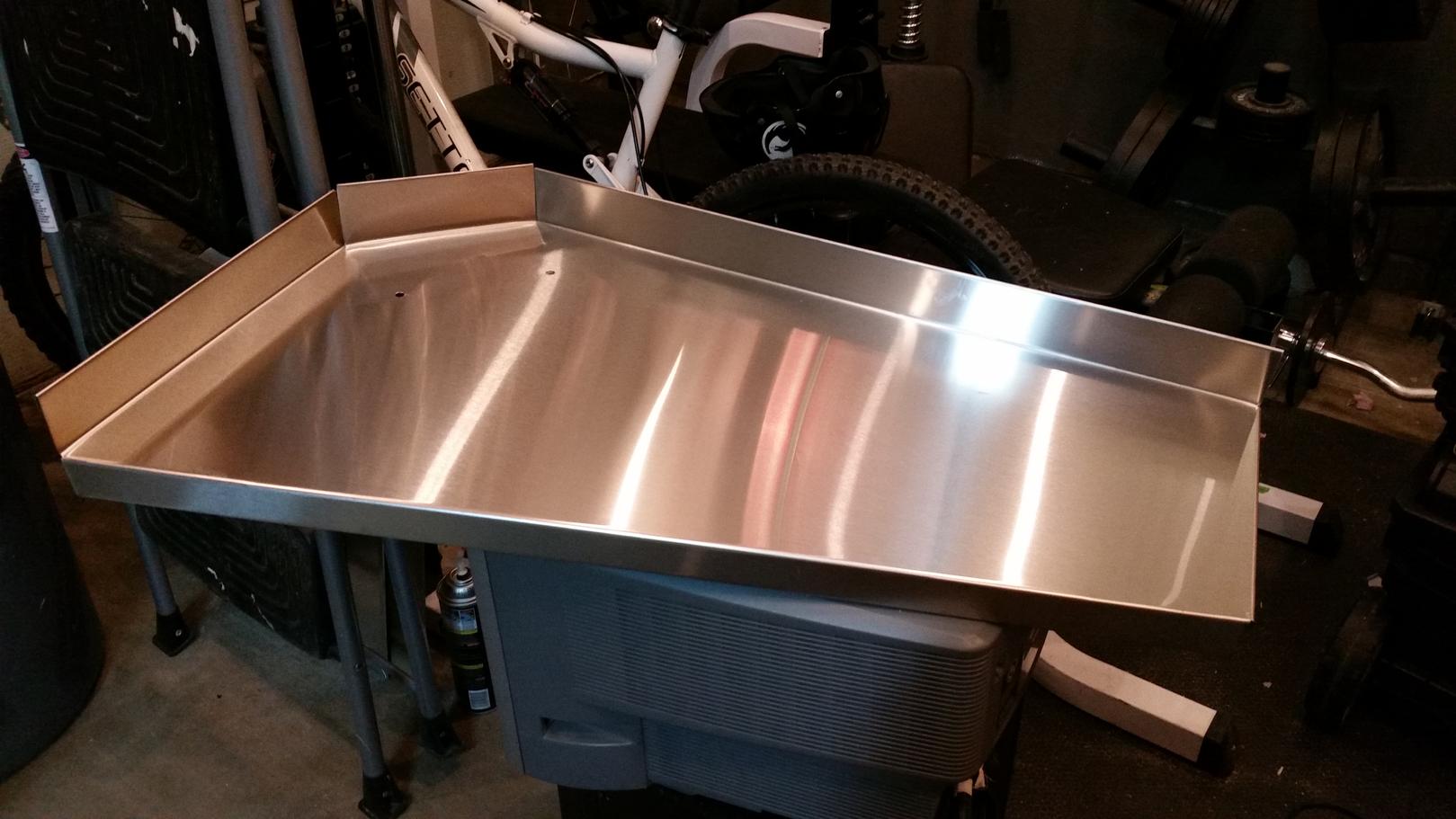

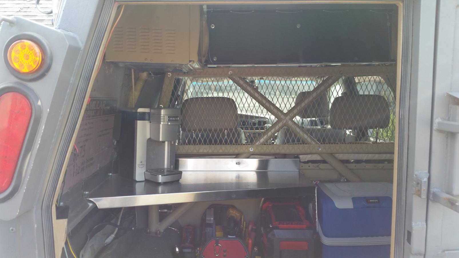

Just finished the stainless counter top. It will set it the corner along the roll cage. The two holes are to mount the coffee maker.

Got the basics mounted; microwave, coffee machine and 12 volt fridge.

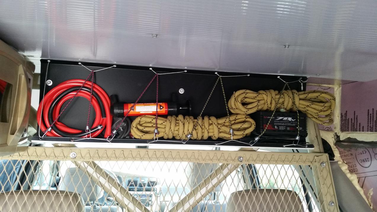

Got the bungee rack loaded. It works great and adds some extra storage while securing the back from anyone who breaks in the front.

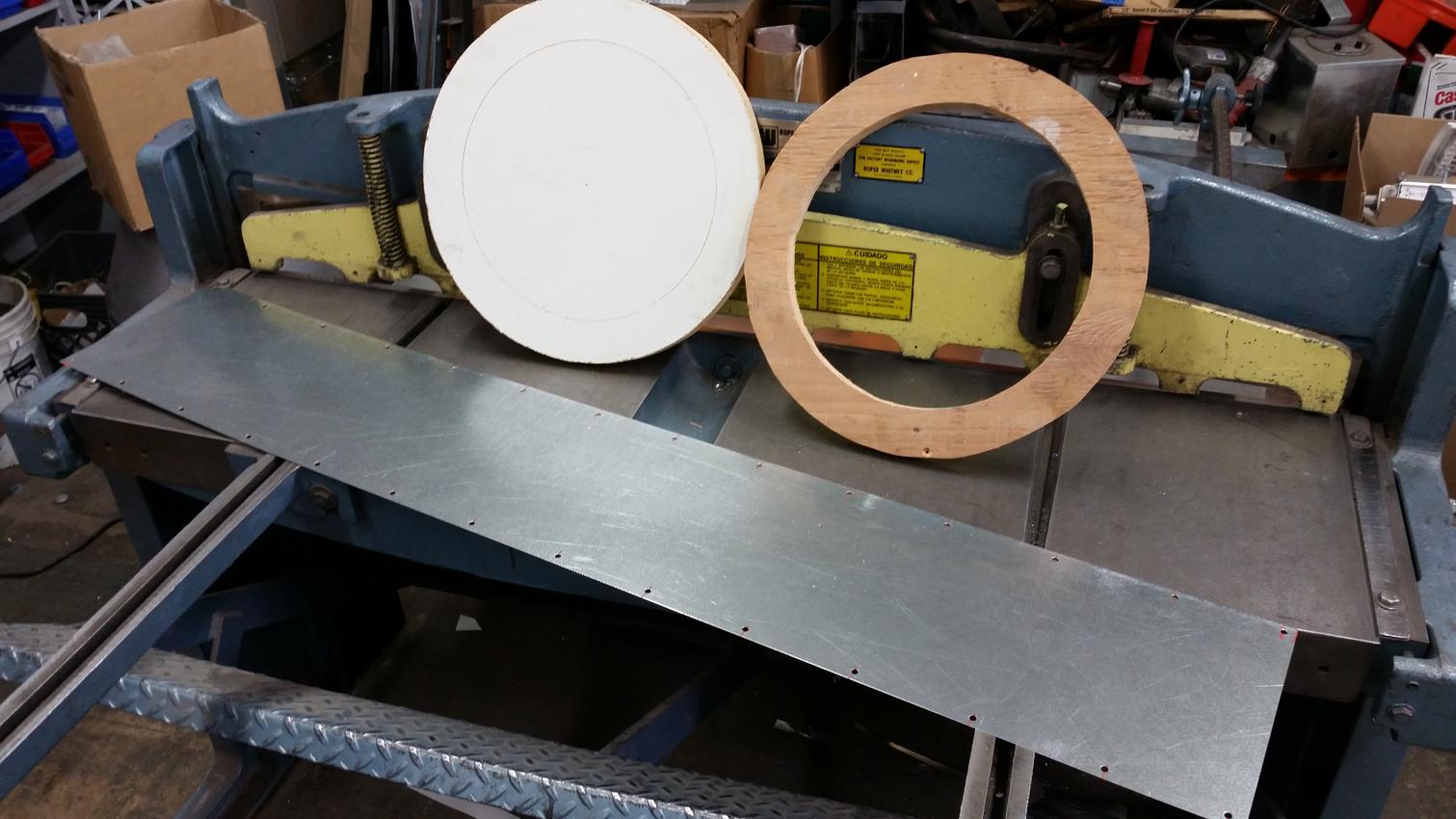

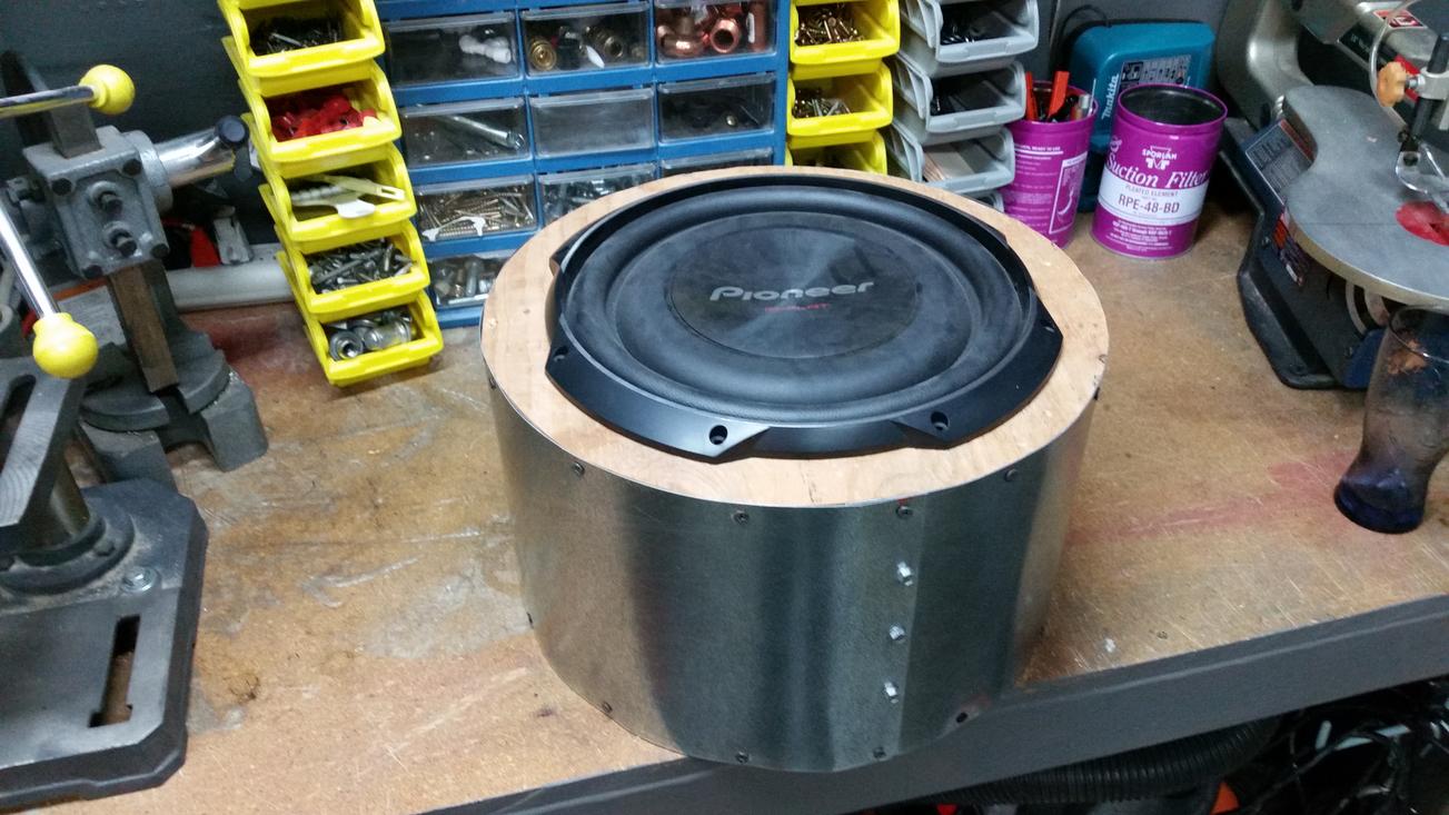

Got a light weight shallow 12 inch subwoofer box in the works. It'll be air tight and rigid without all the weight.

Finished assembly of the box. Just need to seal the cracks and mount it in back.
