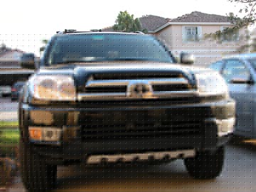

Here is how my skid plate looks...
I installed the 2006 Skid Plate on my 2005 SR5, the installation took some adjustments, but it looks good. Here is the picture.
