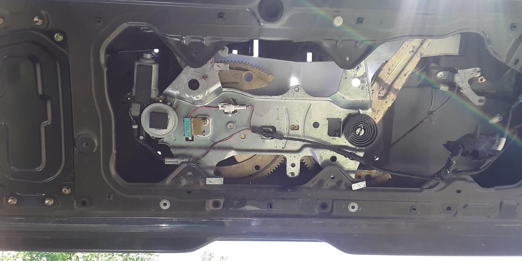

It's a little more involved than that, but it is not super hard. Plastic inner panel has to come off, followed by metal panel under that. Glass has to detached from regulator, regulator assembly needs to be removed from the lift gate. Then the motor needs to be separated from the regulator. Be careful not to let the glass free fall into the hatch, I recommend taping it up w/ clear packing tape.

Plastic pops off after you remove the pull strap bolt. Start at the lower corners and pop out the bottom. Then push it up. It lips into the window slot, so you need to push it up and out.
Remove the 2 metal plates. You can disconnect the connectors for the ECU or just let that plate hang.
No need to remove the regulator if the window is up.
Just reach up around the motor. It has 3 t25 self taping screws holding it in. A short t25 bit on a 1/4 ratchet fits fine. Look at the new motor to see where they are. Remove the 3 and the motor comes off.
Splice the pigtail for the new motor. Then assemble in reverse order.
Will help to thread a bolt into the new motor holes to create the threads before you try to install.
My wires were red/green or red/ blue, ect... I just matched the one color on the pigtail and polarity was correct.
You may need to plug the motor in and move it slightly to line up the gears. I didn’t need to.
It’s a 1 beer job. I did it all with the door open reaching up over my head. Move the glass up and down stopping in different spots to clean and grease the gears and tracks.
