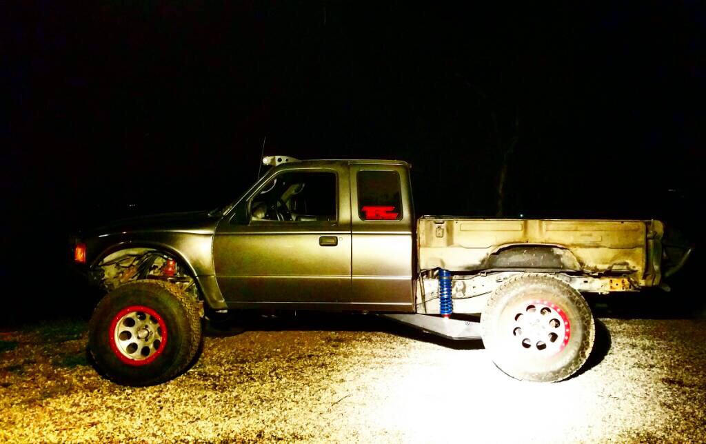

Obviously this is a 4Runner Forum, but long travel is long travel. I use to own a Ford Ranger that had a Camburg LT kit and linked in the rear every day. Would've kept it? But I needed something with 4 doors and 4wd.
As for long travel shocks I would run either king or fox. I run fox on my 4Runner and love them.
I also don't run a sway bar on my 4Runner because I have never had one on a vehicle I've owned lol
