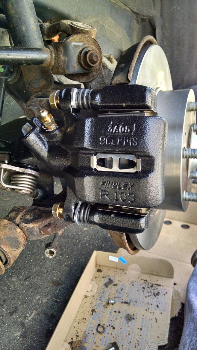

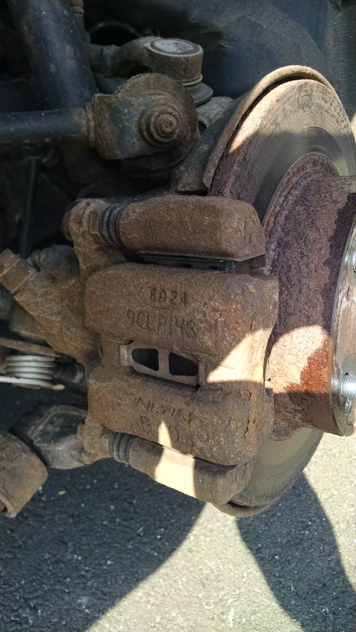

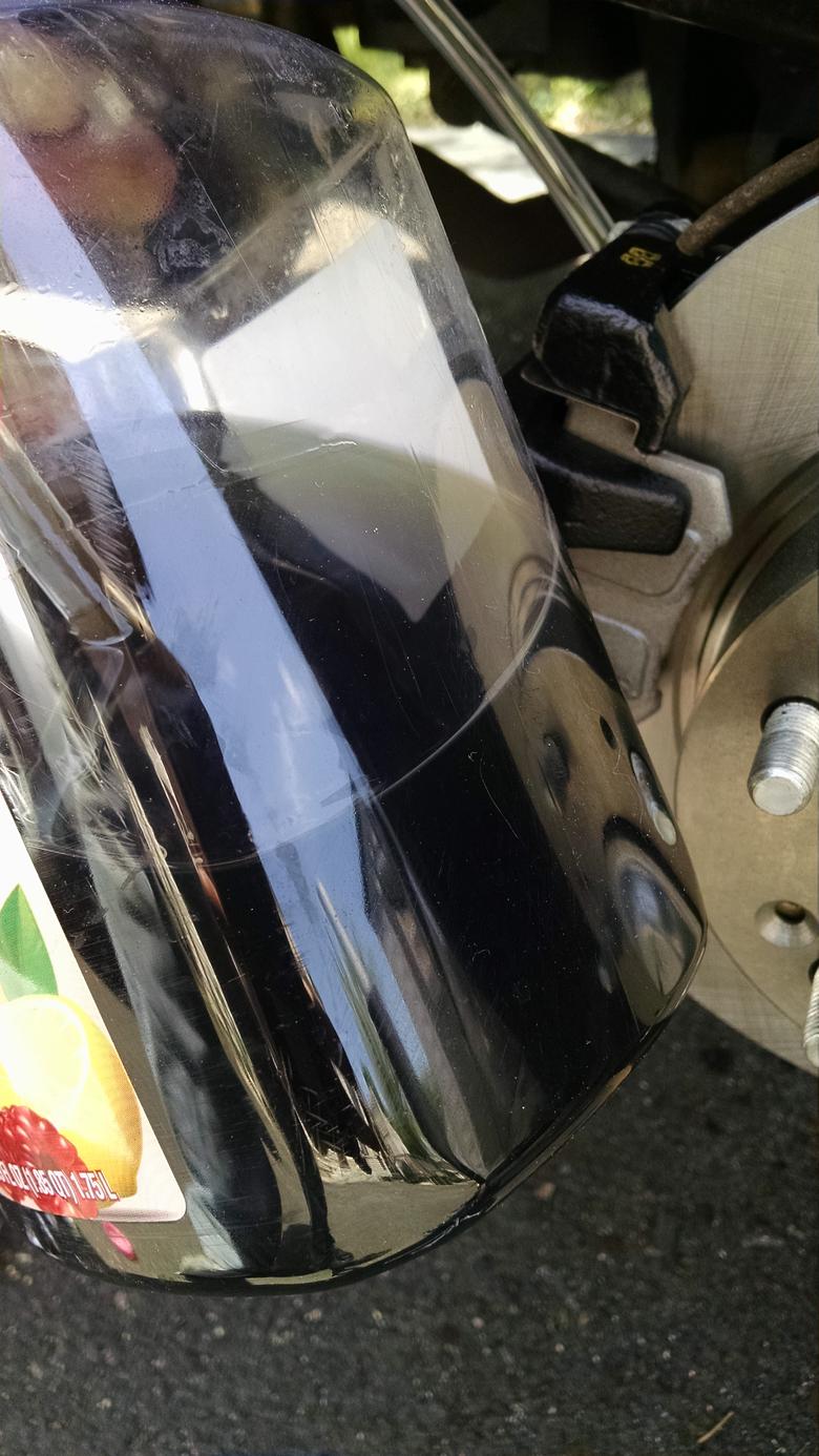

Just as a reminder to flush your brake fluid every so often. Over the weekend, I replaced a seized caliper, rotor, and brake pads on my girlfriend's honda accord. I made sure to bleed the brakes while everything was apart, and since I installed the caliper with a speedbleeder.
Here's what came out, it was black as used motor oil. I'm guessing it turned this way from excess heat from the seized calipers.

Here's a before and after shot:
