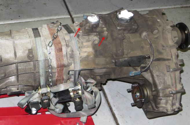

I see a lot of threads on extending diff breathers, but none about transmission and/or transfer case breather extensions.
I just yanked my 5 speed (R150F+VF2A transfer I believe) and noticed there are two breather plugs. I assume one for trans and one for tcase (not sure if the auto trans is similar?). They sit fairly close to the floorboard level, which means they would be significantly lower than extended diff breathers...
Anyone extended these before? They appear to be pressed into the housing.
I have removed the caps on this style of breather plug before, and they are nothing more than a cap crimped over a flare. Awfully tempting to just yank the caps and connect some tubing of appropriate size to re-route them higher and top them off with the same breather plug used in the diff extensions (90930-03136). Anyone tried this?

Those two breathers are just what they're for.
The Transfer case and the t-case adapter.
There should be another breather actually ON the transmission.

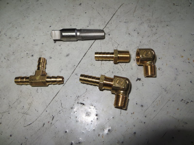

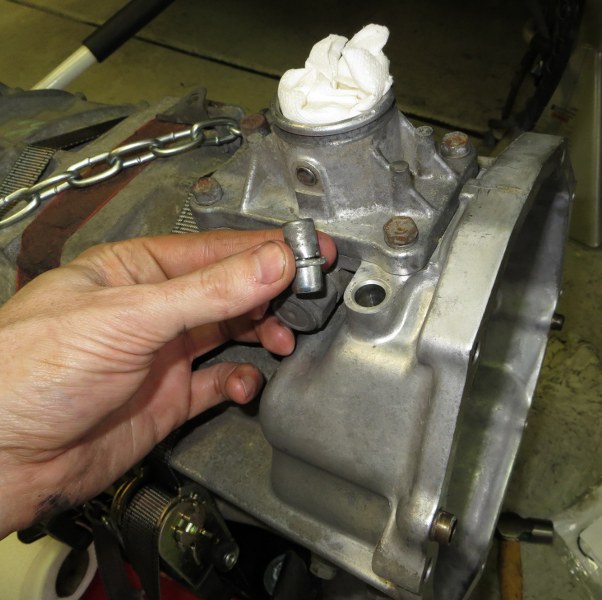

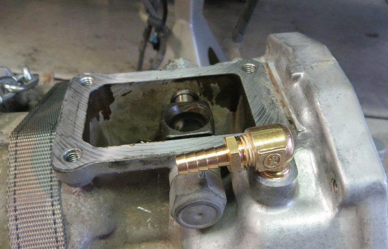

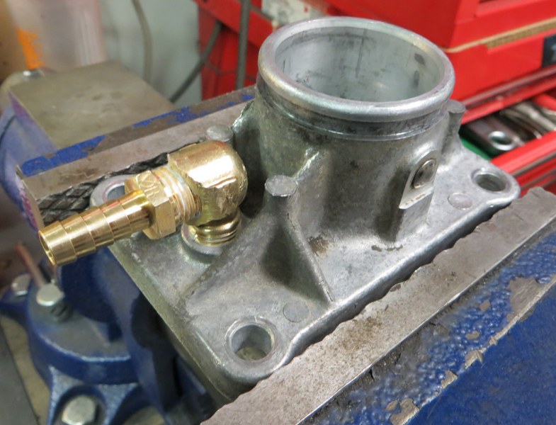

Thought someone might find these pics useful - this is what I ended up doing on my 5 speed (R150F+VF2A). Long story short I extended the transmission and transfer case adapter breathers.

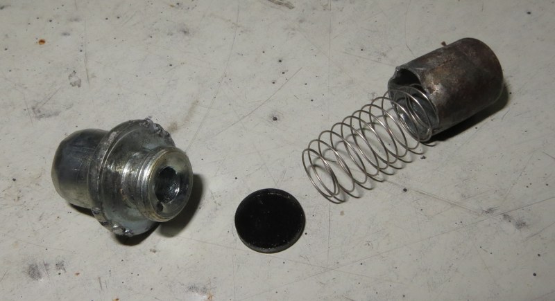

The OEM breathers are much easier to remove if you have the transfer case and shifter base removed (you can pop them out from the backside). FYI Both OEM breathers are true 1-way valves.
I tapped both breather holes 1/4 NPT and used 1/4 NPT right angle fittings to a 5/16 barb connection. I had to modify the right angle fitting on the transmission shifter plate so it would clear when I tightened it. I tied both fittings together with the 5/16" barb "T." I am keeping the small hose connected between the transfer case and transfer case adapter.
