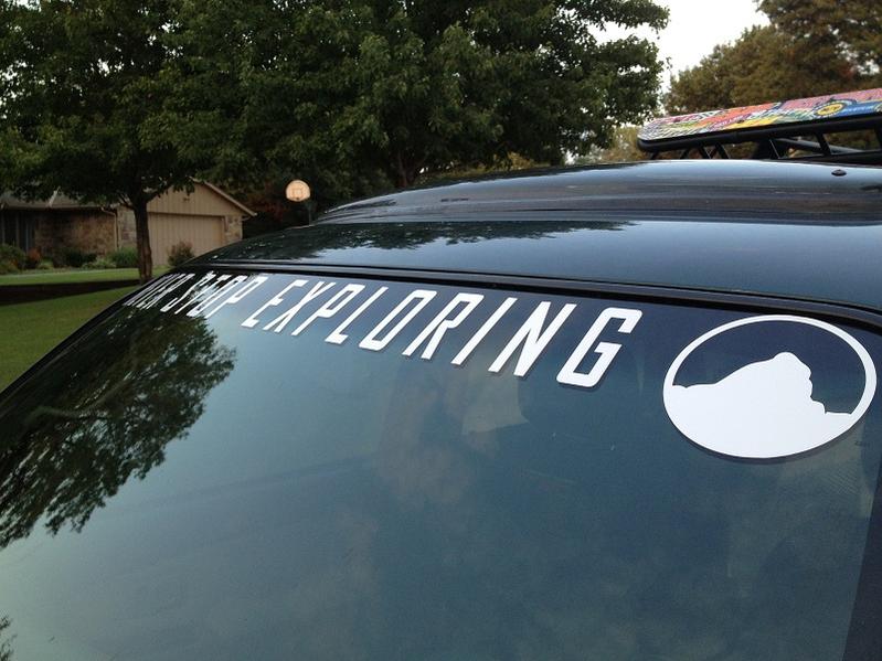

A while ago [MENTION=81047]farmerjon[/MENTION] made a decal for his truck.
Aaaaand I liked it. So I pestered him for a couple weeks until he would make me one. But bigger. I have always been a fan of windshield banner style stickers. I think you guys know what comes next.
I couldn't be happier with it. Once again, thanks Jonathon!

That turned out AWESOME!! Thanks for the recognition, I appreciate it! Lies, actually - you didn't pester me one bit, it was YOU who was patient while I designed it and took it to the shop and everything! You didn't have to do much to get me to agree to do it, I think it looks awesome, and like I said, I'm humbled that you want to run my design! It looks sick! Curious if the wipers hit it?
It looks to be just the right height, and you spaced it out and angled everything - I can't get over how great it looks!

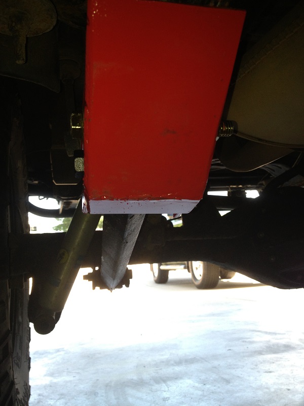

I like the angled LCA skids! A lot less surface to meet the rock... The metal holding your sockets in place is good too.

I dunno about that! But either way I'm super stoked about it. The wipers do hit it but just at the edge. I went through some rain on my way up to CO and had no problems.
Thats the goal with the skids. It helps with contact, will let it slide easier, and because of the gap between the LCA and the peak on the skid, if I hit it hopefully the peak will dent down before the whole LCA skid assembly.

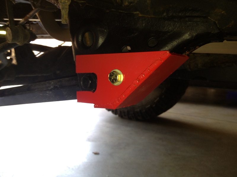

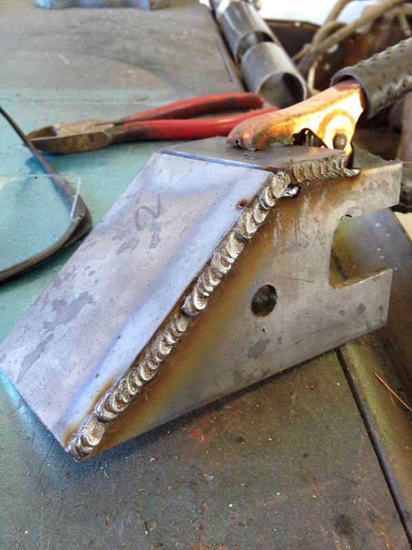

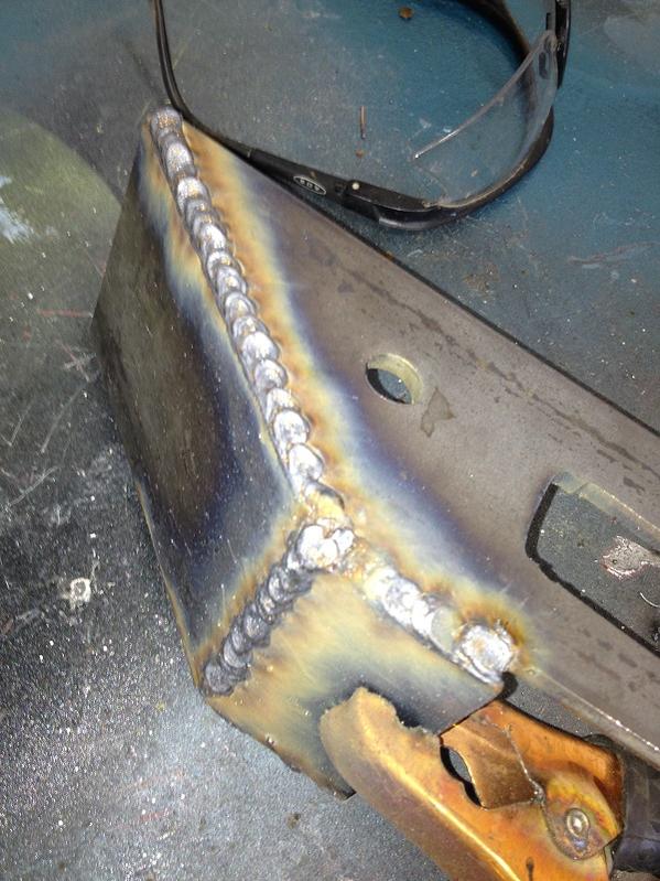

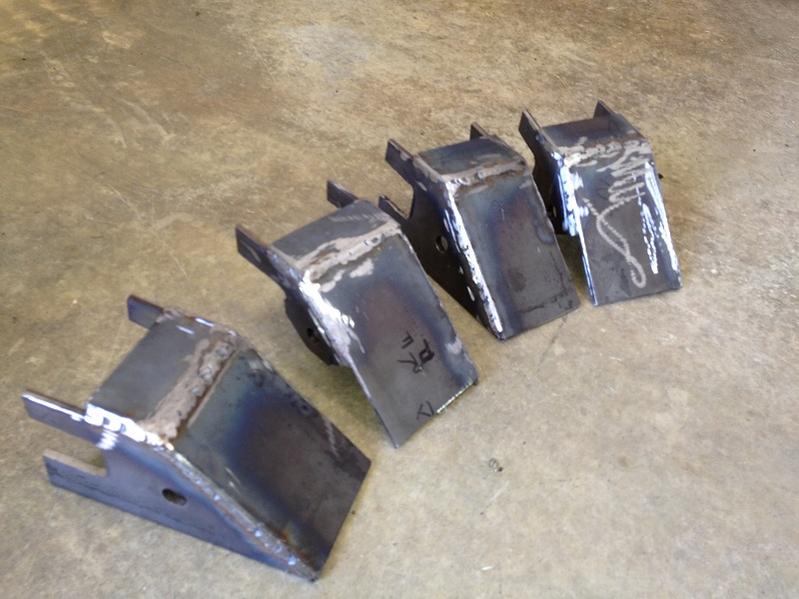

I just finished up welding, grinding, painting, and mounting my RCAM skids. Made out of 3/16 steel and mounted with 7/16 hardware.
Decent welds for not welding in 2 years
All cleaned up
Painted and mounted
All cleaned up
Painted and mounted
Welds look good bud. And love the way they come out. Those are something I am definitely looking into doing
RCAM skids look real nice! Plus the red matches your TRD sticker. All the freshman ladies on campus will love it. :behindsofa:
Thanks man. They're real simple to do if you have the tools. Worth it in the long run too
You know it!!! I need all the help I can get with the ladies

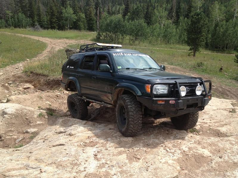

So I went wheeling last Friday at Moody Hill and Crystal Mountain. It was my first real test of the locker and I was not disappointed! Here are some pictures but the rest of the trip can be found here http://www.toyota-4runner.org/3rd-gen-t4rs/127250-fr4rs-photo-build-thread-5.html.
Some of my favs
Locker Review
I've had the locker in almost every situation except snow which will hopefully be coming soon. So I'll try to address each situation individually and add to it the more I go on.
Highway: Didn't even know it was there. Doesn't affect it at all. Merging onto on-ramps also doesn't make any problems.
Town: You can hear it clicking in turns. The tighter the turn the more it clicks. I've gotten maybe one or two loud bangs in almost 2000 miles now. I've never had it lock up in a turn no matter how much throttle I apply.
Trail: Absolute perfection! I no longer have to throttle up to get over an obstacle. Easy throttle and up we go. It also unlocks great on a trail. I can go over a rock group locked and 5 feet later make a tight turn unlocked. Also on the dirt feeder road (packed dirt with loose gravel in places) I attempted to get the locker to lock up in the corners and it wouldn't go.
In all I haven't seen a single downside to this kind of locker. If I had to do it again I would do it this way no questions at all.

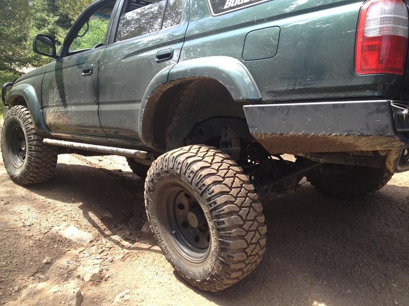

Little update here. Got two bits of damage at Kelly Flats. First is a nice scrape along the bottom of the rear diff (down to metal). This place is thick as hell so I'm not too worried but it was near the drain plug which I'd rather not bugger up. I may look into getting a diff skid such as a Budbuilt or B.A.M.F.

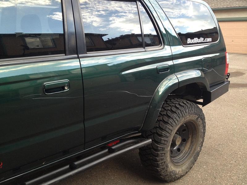

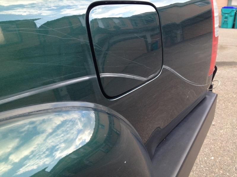

The second is a little more obvious. A branch decided to be a little meaner than I anticipated. Not sure if this will buff out.....lol

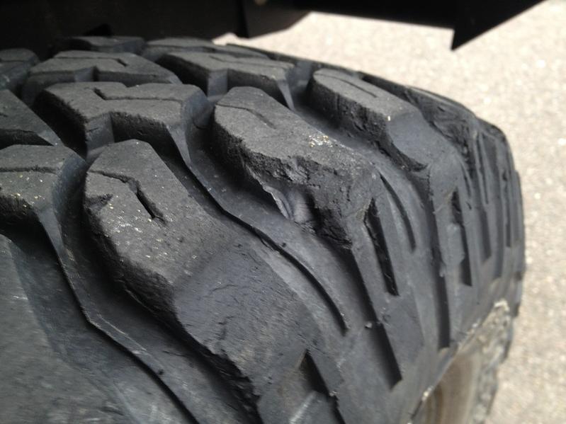

Also, I'm not as stoked with my tires as I previously was. I have maybe 6-7k on them and they're looking like this. I like the way they hook up and as far as tread depth they are doing pretty well, but not stoked about this. [MENTION=58830]JWaldz[/MENTION] have you ran into this junk yet?

Honestly buddy, any tire you use offroad in the rocks is going to do that. Some brands and patterns resist cutting and chipping better than others but i wouldn't worry or be upset about that one bit. After a couple more trips put that one on the passenger rear and vice versa to even it out a bit.
My BFGs are getting destroyed, but you gotta pay to play, right?! Ill grab you a couple photos tomorrow to show you what i mean. I am missing half a lug on one of mine.
What a mean tree, did you break the branch off afterwards?

Yea I expected them to get rough, just compared to the Duratracs [MENTION=78892]FR4R[/MENTION] is running its a decent difference. Although I guess thats the mud tire vs somewhat AT difference too. Plus back in OK at Disney its all just hard, sharp granite so I imagine that took a toll on them. Its ok though, quicker I go through these the quicker I can step to 35s:nod:
You dont want to know what I did to that branch....:loco:
Yes, mine look similar. I also have a good few chunks out of the tread but not anything extremely horrible. I think the type of terrain we drive on like the gravel roads, loose rock, rocky hill climbs and so forth will cause what we're seeing on any tire whether it's designed for this stuff or not. Considering the amount of stress we put theses tires though I'm pleased. Imagine what they would look like if you bought 150 dollar tires. Might have already punctured one by now.
