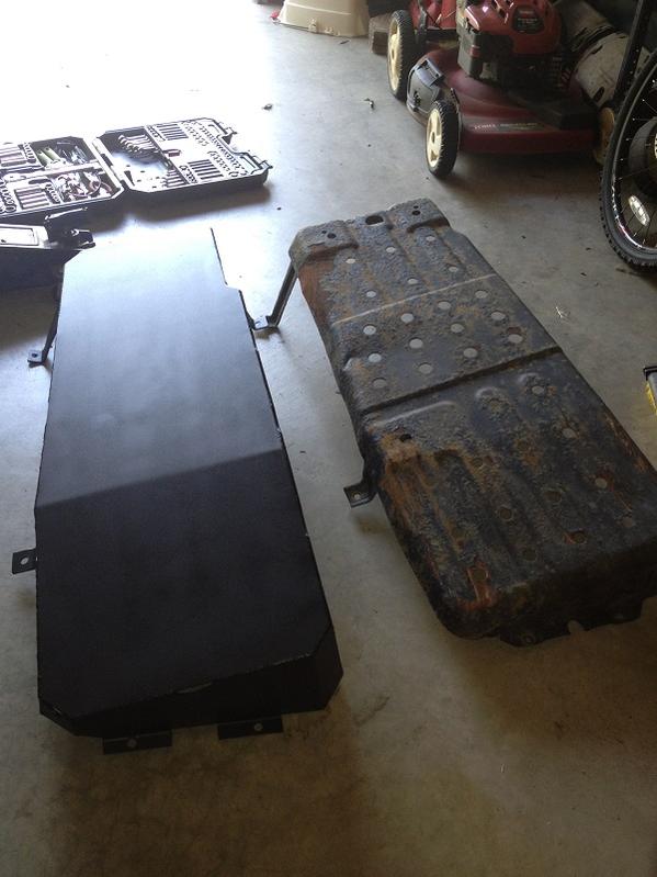

I'm actually curious about the measurements now. I imagine it will be similar to a little less. The stock skid is like paper and sits pretty close to the tank where I imagine this one will have a little gap and its much thicker. Who knows. I'm hoping it will get rid of my driveshaft issues too. I blew that zirc off the driveshaft a while ago:D

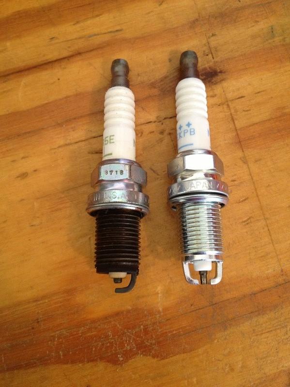

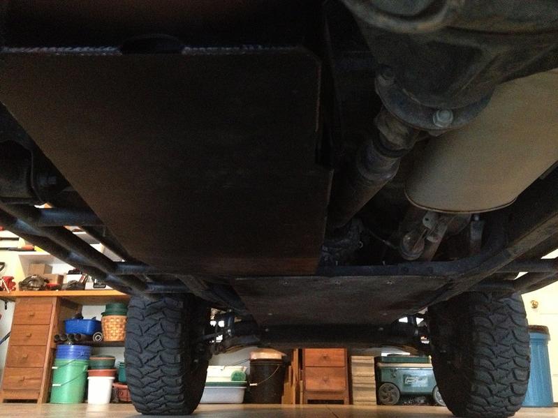

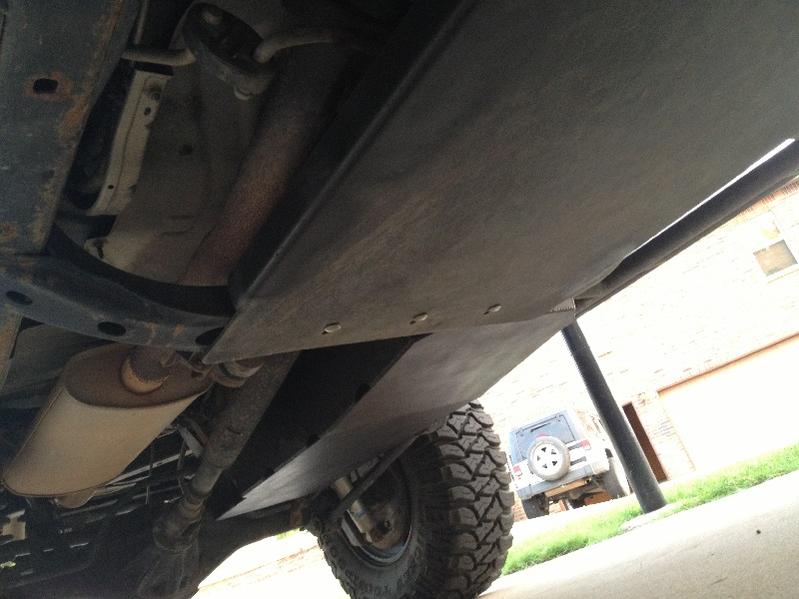

Today was rather productive. Spark plugs are changed, Any7 skid is on, and my truck is all cleaned and waxed. The plugs that were in it were single ground which goes against the sticker on the engine but they're replaced now. My skid went on pretty well. I had to pound out a section as it was cutting into the gas tank mount strap but it wasn't difficult at all. After that just some BFH work and it was on! As far as clearance goes I'm the same in the front with a better angle and I gained a half inch in the rear.
Picture time!
Plugs
Skid shots

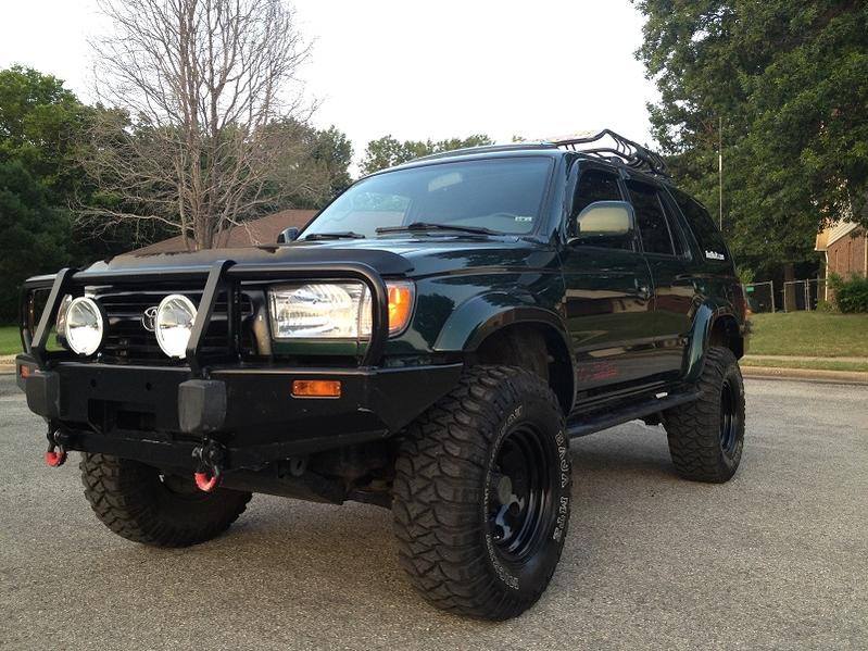

All cleaned up :biggrin2:

Extra clearance and much stronger rock protection is a WIN-WIN! Thanks for the update bud, now go try and dent it up. At least put some scratches in it.

Looking awesome and sick, as usual, Tyler! Your 4Runner looks really clean, I like the ARB! Still a bit curious as to what exactly you did to the ARB - do you perhaps have some side by side/before/after photos? I've heard of people trimming them, but I'm not sure where people do...

Thanks man. It would look better with a sticker cough cough. Ill try and do a side by side. I didn't trim as much as some but I did enough to eliminate my rubbing and improve the looks IMHO.

One thing to keep in mind. I had to trim additional material along the inside edge due to driveshaft and diff housing clearance. Granted I have a ton more axle movement than most as my suspension cycles. If you take a look at the any7 thread I started, you will see what I mean by extra Clearancing.
