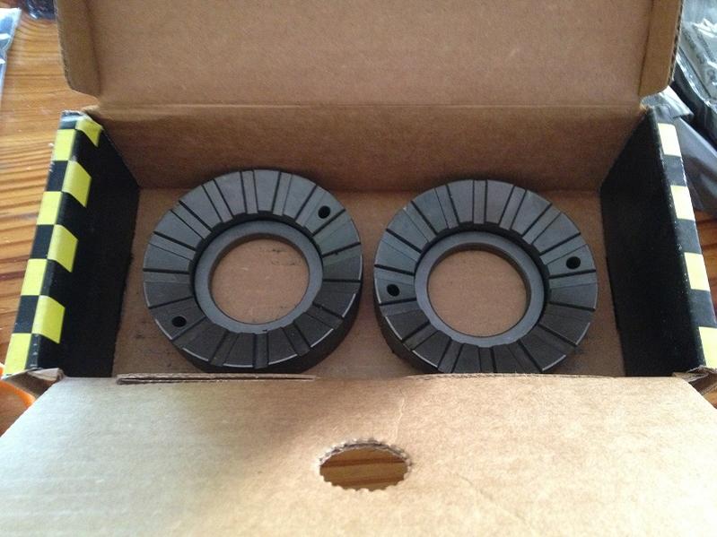

Its a locker
I know auto-lockers are a matter of opinion whether or not you like them. But I do haha. I think it's less things to break (wires/air lines, whatever), and less cash (the more important one). It should go in this month sometime. Along with new upper links, RCAM skids, and lower link skids (those of you who are into LCs probably know what I'm doing on the cheap). However I have to get to a welder to make all that so it will depend on when I get into my friends shop.

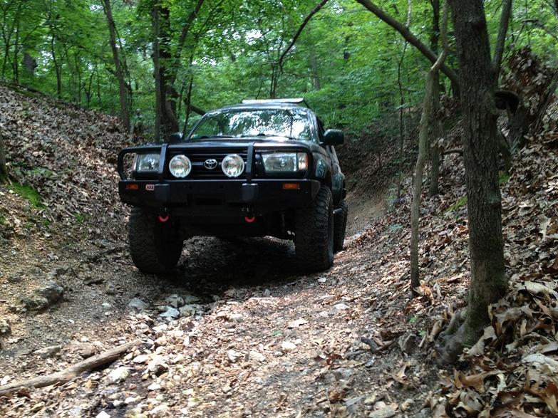

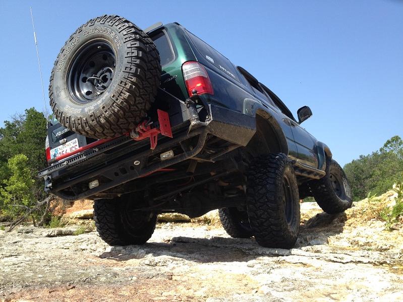

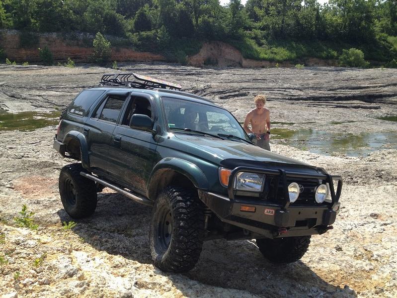

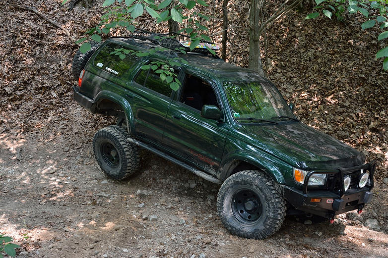

Disney 2013

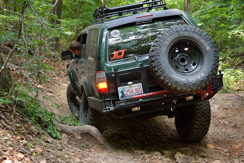

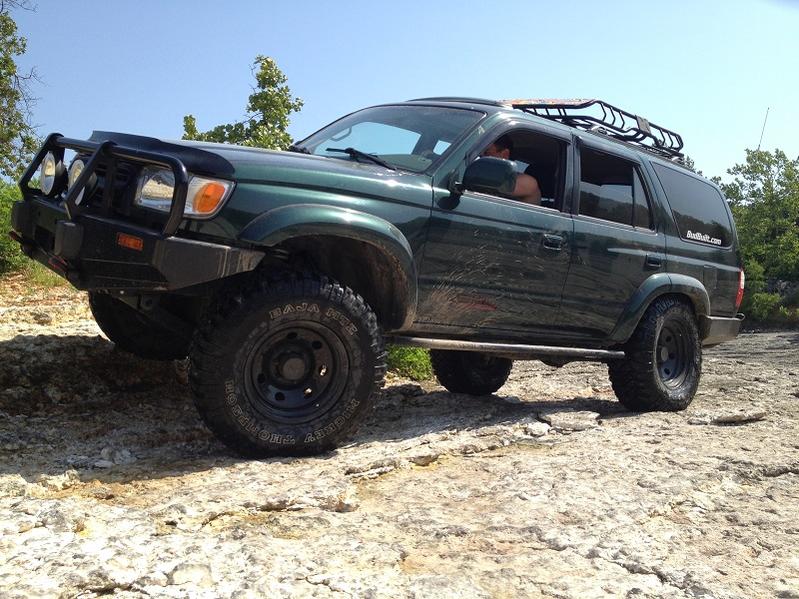

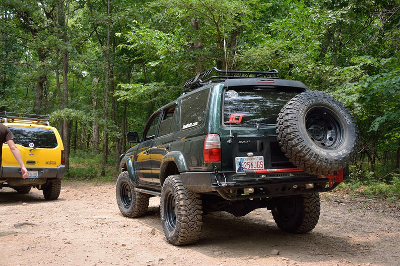

Finally got around to looking at my pictures from the disney trip. Also [MENTION=78909]alexb[/MENTION] finally did his too haha.

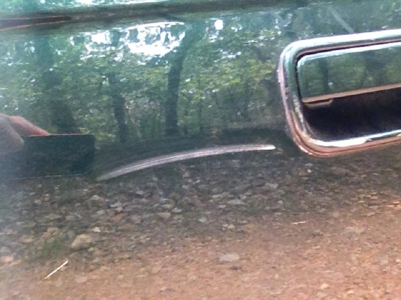

well here is when I got a little funky. What you see is actually a \_/ kinda thing. I'm straddling the bottom of it and the picture was taken from the top of one side. I tried to go up the slope the picture was taken on and couldn't get to it. It was just too loose. When I backed up I was caught next to this tree and eventually kissed it. No dent, but it didn't buff out that's for sure.
Like I said earlier some of these pictures came from Alex. You can see the whole album here http://www.toyota-4runner.org/gallery/146044-ok-summer-wheeling-trip-pics.html#post1427863

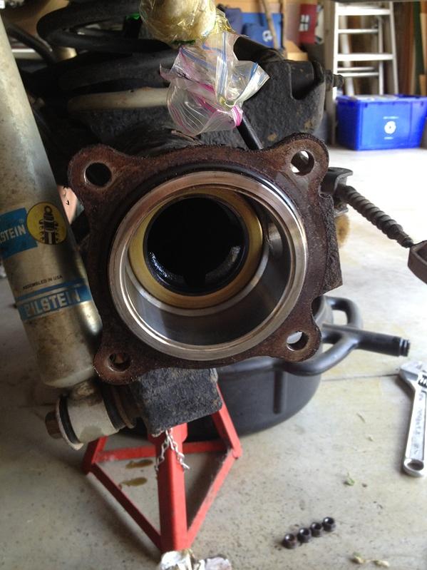

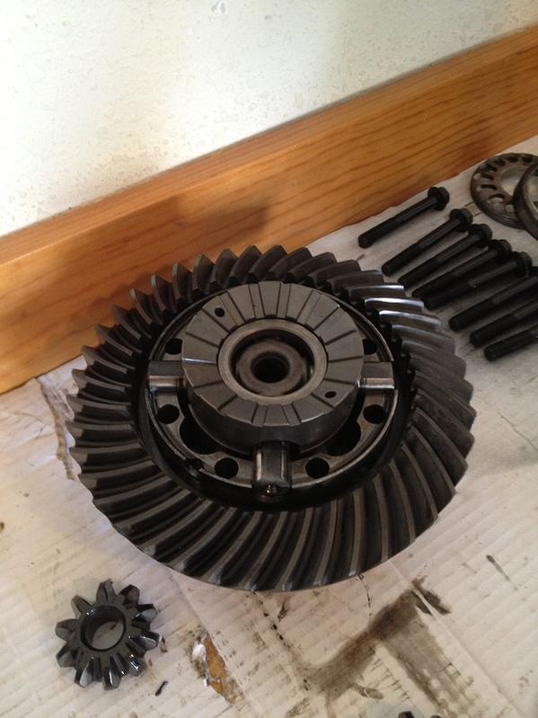

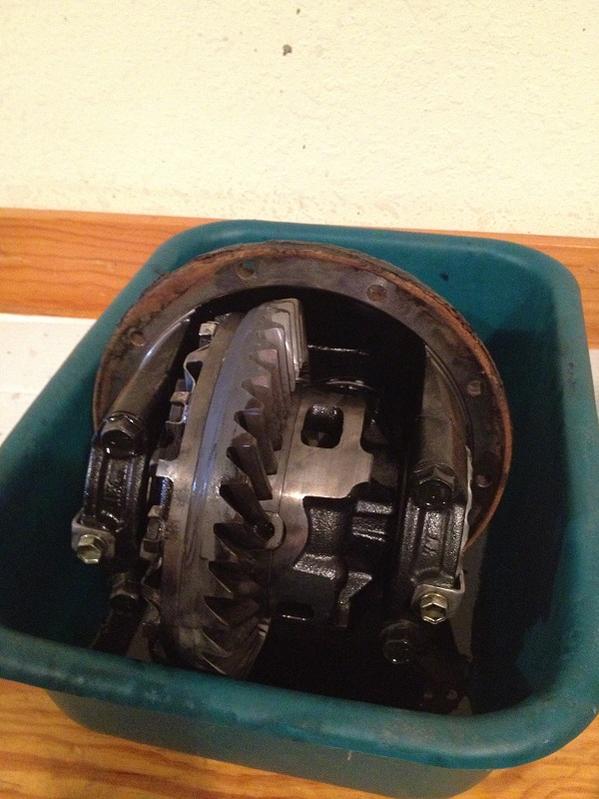

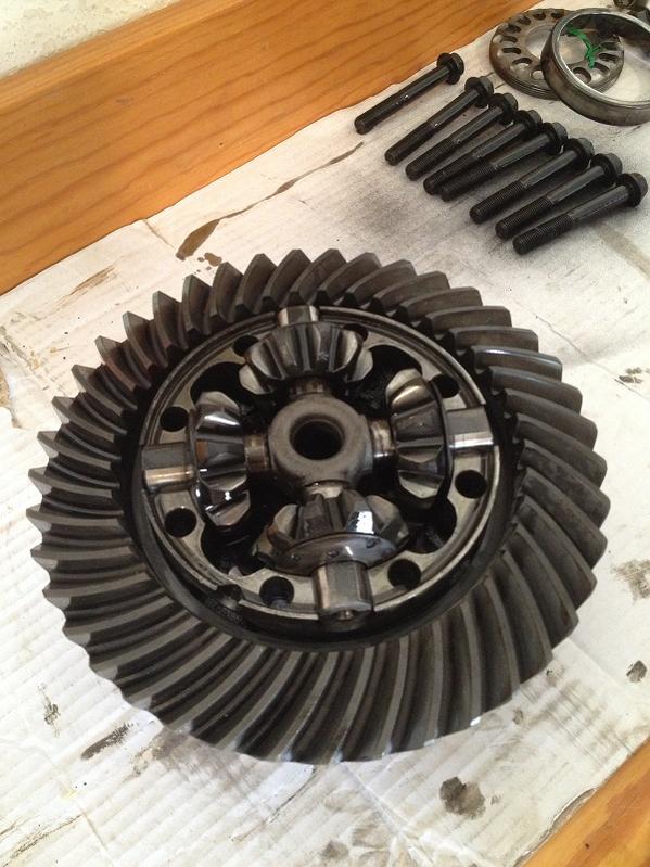

Well this is a somewhat belated post but whatever! I recently put a Lock right in the rear end. It really was a piece of cake to install (shoutout to [MENTION=88576]smkd13[/MENTION] for his badass write up). So far I love the on road handling. I have zero problems with it and its actually really quiet. I'll post a follow up when I've had it in a few more conditions.
Pictars!
Spider gears......
No spider gears :D

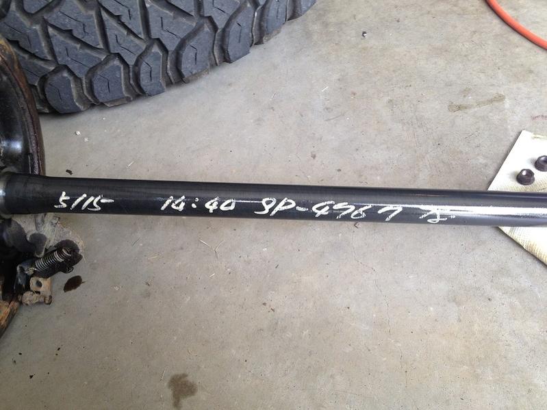

Anybody make sense of this? haha
Thanks bud. Glad it was helpful/useful.
And that is a salvage yard part. Most all salvage/junkyard mark items that way web they inventory them. I have the Same kinda marking on my core support.
No problem it was definitely worth it. Weird I wonder why it was replaced. I wasn't aware of any problems.
You wouldn't notice one but generally they will do it sometimes just to replace a bearing or what not. You never know sometimes. Oh and I had the same markings on one of my axle shafts too come to think of it. They were replaced before I bought the truck.

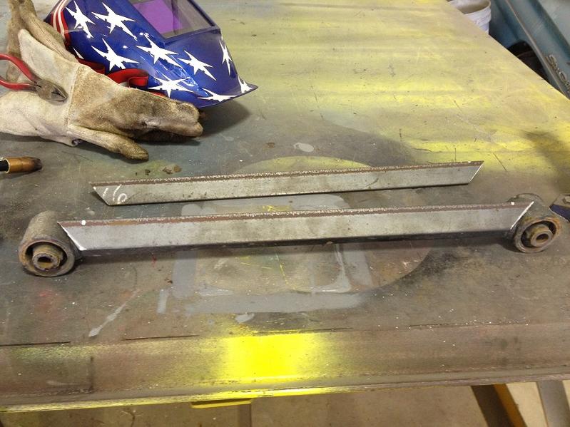

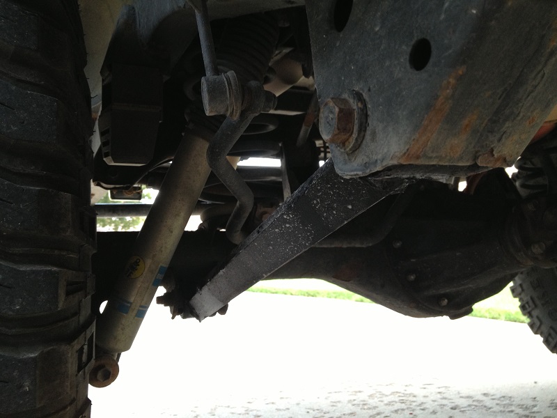

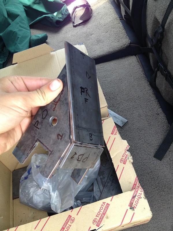

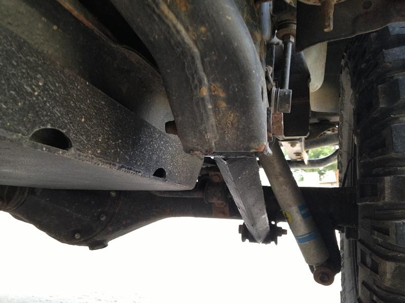

I've wanted to get some Toytec LCA skids for a while....but I'm cheap. So enter some 3/16" angle iron. I've seen this done on some Landcruisers so why not a T4R?
Cut
Mounted
Before I painted them I sprayed some lithium grease in the bottom of the angle to protect from rust. Then I sealed the gaps with caulking. If I were to do it again I would use 1" width angle iron where I used 1.25". It would leave a little less to fill in after welding.

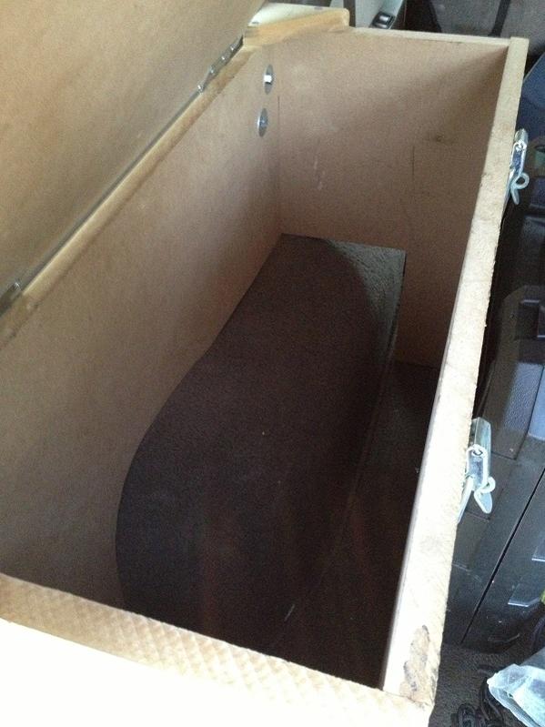

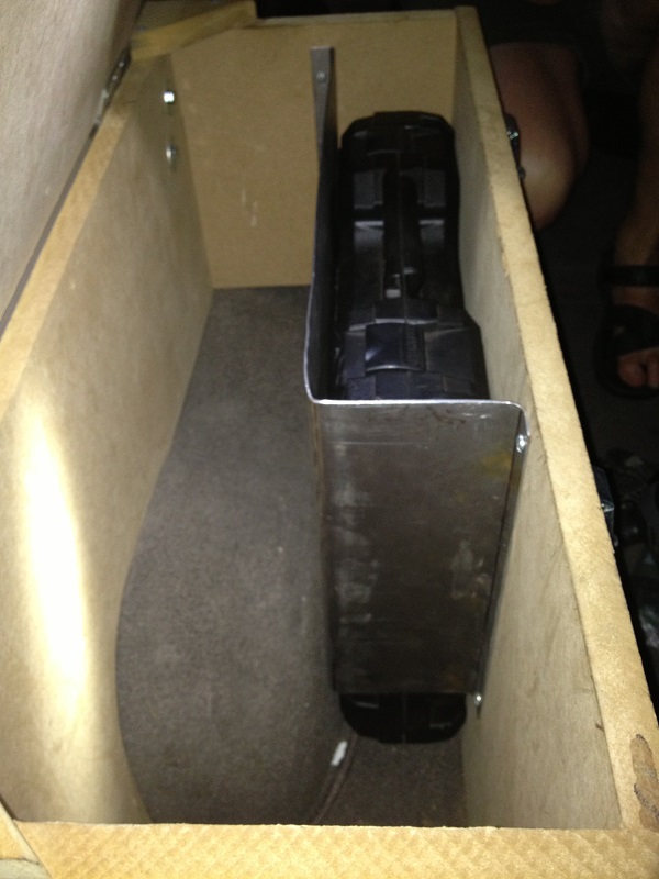

Second I dealt with my cargo box issue. I carry a craftsman 154 piece tool set in my box at all times along with a bunch of other junk. The problem is when I have to pull the tools out everything I have slides where the toolbox was. So I have to take everything out every time. Enter a piece of metal!
No good
Very good
