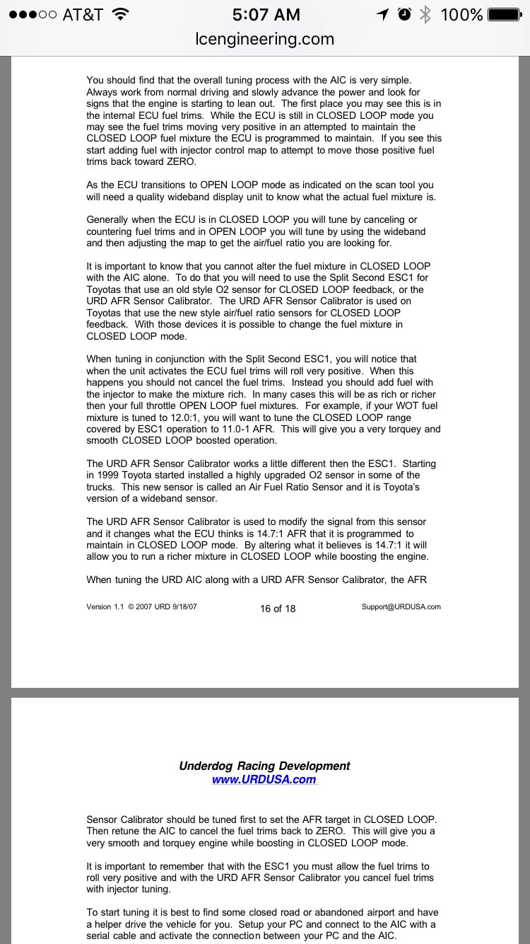

I'm loving how confusing this is continuing to be:
Like he told me, it's the "output option B" set to "overpressure" and then set to a value of 1.5 PSI or wherever you want it to start lying to the ECU. BUT it's only if your unit is tapped into the front 02 OR you have the additional AFR calibrator. This is what I was talking about when I said my unit lies proportionally opposite when it enrichens in closed loop so the main ECU does NOT pull the extra fuel via the stock 6 injectors.
Read this supplement:
http://www.lcengineering.com/LCInstructions/1063078 u-tune-aic.pdf
I think page 16 looks like this
Let us know what you think? I'm still trying to figure out the intricacies of this whole system and based on how she runs I'm confident it's working right.
