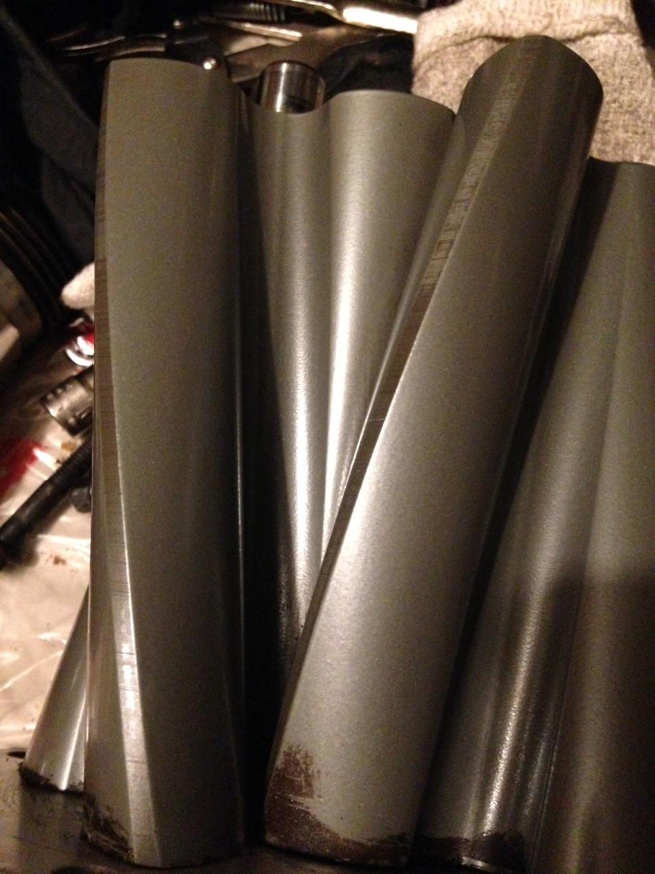

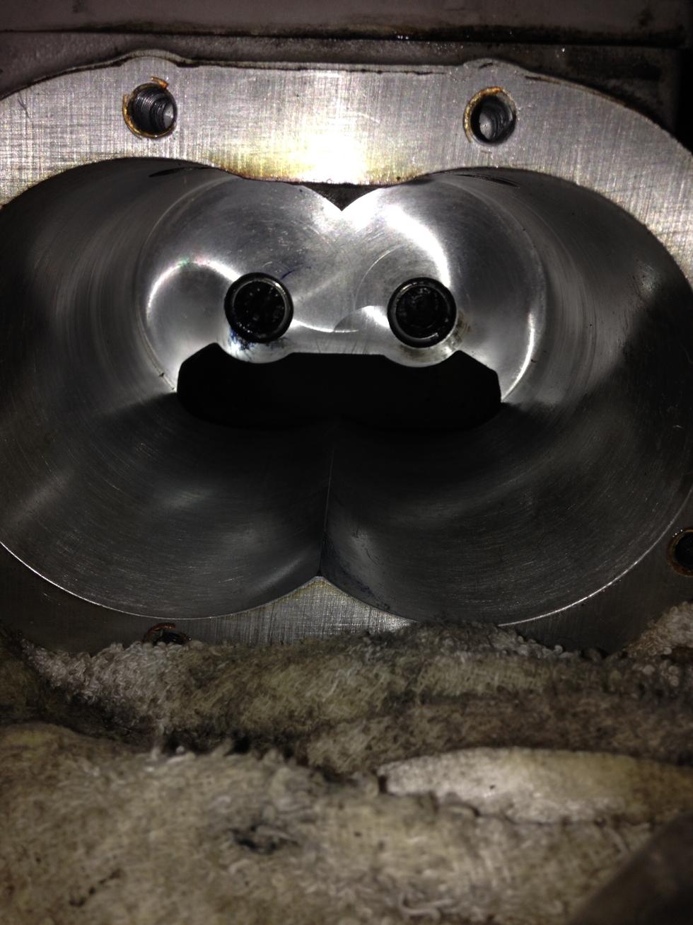

I finally got the nose cone off and what did I find in the roots?
CAT FOOD!
Freaking 20 or so pieces in the intake and crushed in the roots of the SC. That caused the darn thing to not spin, cleaned it all up and.... image.jpg
