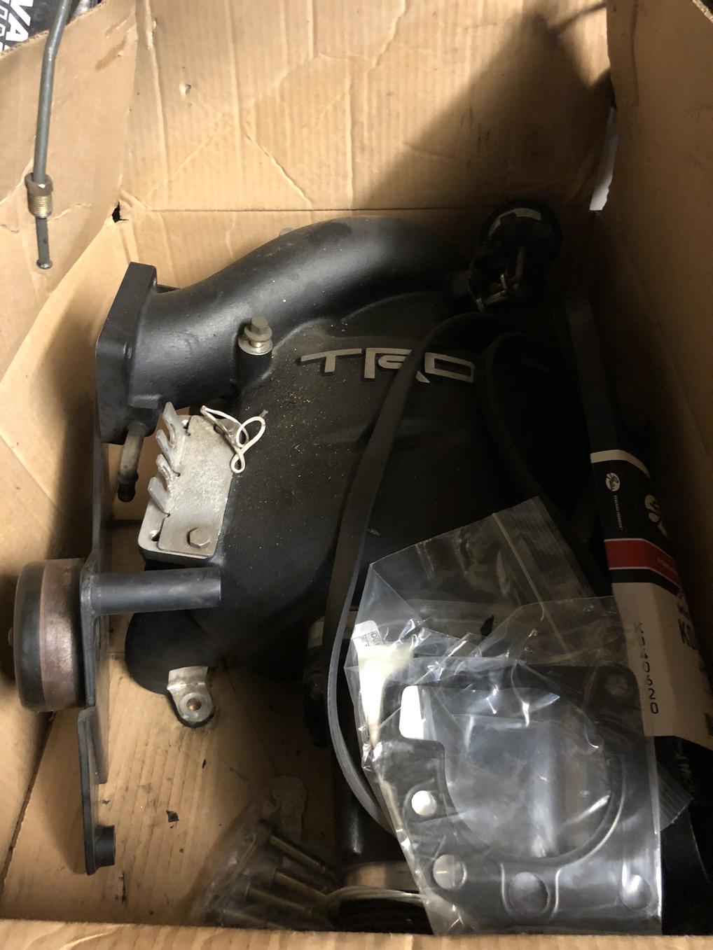

That is the old style idler pulley. Have you looked at updating to the auto tension pulley setup?
No, I'd like to get a 2.2 pulley on it and do the URD tensioner while I'm at it, but at this point I'm just going to replace the old idler. I had my buddy who works in parts at Toyota find it, only cost $25 for a new OEM one.

One of my closest friends that i would only trust working on my cars when I need help had it laying around. He took it off his T100 that was wrecked. As soon as he heard I got a 4R he said "its yours when you want it" I am trading him for some civic parts I have laying around and some cash on top.

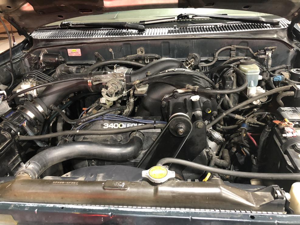

here it is...installed.
Man o man, I'm enjoying my rig a lot more. I like the acceleration. Only problem I'm having now is that it'll bog or hesitate at times. No codes but did see a miss fire in cylinder 4-6 from my torque pro app. I'm thinking it might be the left over 87 gas in tank. Going to run it low and fill up with premium and see if that changes it after a few fill ups or maybe swapping out plugs for cooler ones might help it. Any help is appreciated Overall really happy with it.
Pull the EFI fuse (not relay, fuse) in the engine bay to reset fuel trims and put some 91 or higher fuel and then give it a spin. Also on your next tune-up, replace the spark plugs with iridium plugs that are two steps colder, like the DENSO IK-22's. Will help with the misfires & hot engine temps.
Did it and no changes except now I got a P0325 code on the way to work. Might have to upgrade plugs, read somewhere else that upgrading injectors to supra ones help and replacing the thermostat with a 170 degree from URD helps too. Thought this was a install and go kind of thing, this is frustrating.
Make sure you do the “free FMU” mod, check all vac lines to make sure you didn’t miss one. I was getting the same code until I looked and saw I missed the small vac line up behind the throttle body. Also be aware the trd S/C was meant to run with the stock air box/intake. If you have any changes that let more air in then stock in will run lean.
Is that a knock sensor code? Only one reason why you'd get that, you accidentally either pinched or disturbed the knock sensor when you installed the supercharger. Go ahead and try spark plugs, but know that if that's the knock sensor code it only throws that code when the harness or sensor has gone bad.
