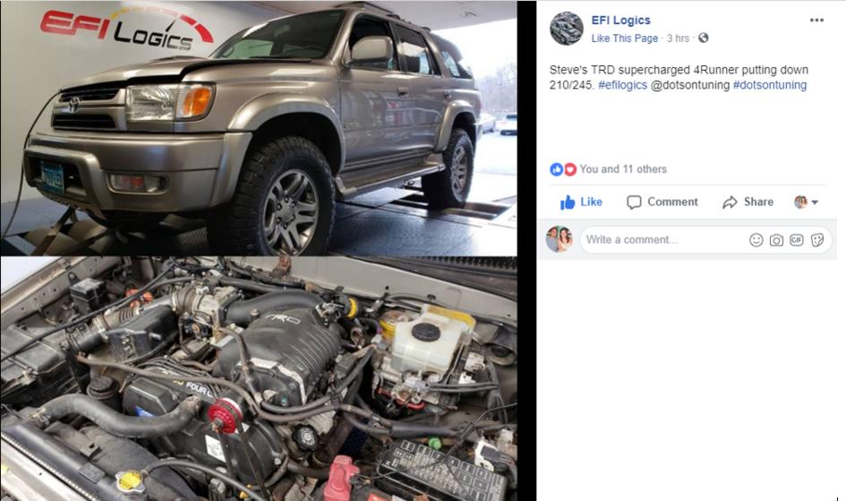

Hey guys --
Pretty stoked -- getting the 4Runner TRD SC tuned via the AEM-6 FIC at a local tuner tomorrow. It has the 2.37" pulley on it and I'm giving them the 2.2" URD pulley to put on once they get it running right w/ the 2.37". I have the dynamic tensioner so no idler pulley adjustment is needed.
Is there anything special they need to know when changing the pulley? He asked if it's one of those ones where you need a puller and the SC has to cool off overnight. I've never changed it... so I have no idea. I see a nut and it's barely been used so it isn't rusty or anything like that.

Hey guys --
Please advise --
Thanks!
-Steve
The pulley is not press fit, it's keyed and can be pulled off with a regular pulley puller. Small 3 jaw should work fine. HOWEVER, that nut is a pain to get off if it's been there a long time. You'll need to keep the belt on and use and impact hammer or drill. You cannot take it off with just a socket wrench.
I had a hell of a time getting the nut off. I was finally able to do it using a chain wrench with a rubber strap underneath it to protect the original pulley. Still damaged it a little.
That nut was the reason why I got air tools lol. I was thinking of getting some anyway, but that sucker was stuck! Plus I started flipping/dismantling 4Runners so it came in handy a lot.
