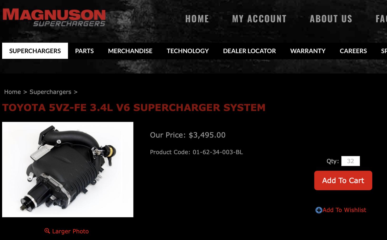

what is everyone's thoughts on the increase in price on the 3.4l superchargers from Magnuson?...went up by $500 approximately depending on who you bought it from.
I love how everything to do with the 3rd Gen Toyota 4Runner is going up in value over time. The 4runner is so ruggedly elegant that it gets better with time! When will these trucks ever depreciate in value?
I felt that at 3k for just the blower it was already overpriced. At 3500 it's definitely overpriced for the gains you'll see and additional money you would need in tuning and what not. I would of liked to see Magnuson give the supercharger a refreshed design and possibly incorporate an intercooler like all their other superchargers use. I think that would warrant a increase in price and it would make the truck run so much better.
But offering the same 20+ year old design that has known issues and asking nearly as much as a lot of 3rd gens will sell for just seems a little ridiculous to me
100% agreed, even at $2000 invest (supercharger plus piggyback ecu) its still a stretch to say its worth it or not, IMO. Granted, I haven't wired in the piggyback yet cause other stuff broke.:becky:
That's why I bought mine with it already attached! I paid about a $1500 premium over a non-supercharged 4Runner of similar options & mileage at the time.
Have you looked at the cost for the current 4Runners though? It's freakin' $6000! So compared to others systems it's a steal. I just hopped on their site again and the Tundra supercharger is $7000...

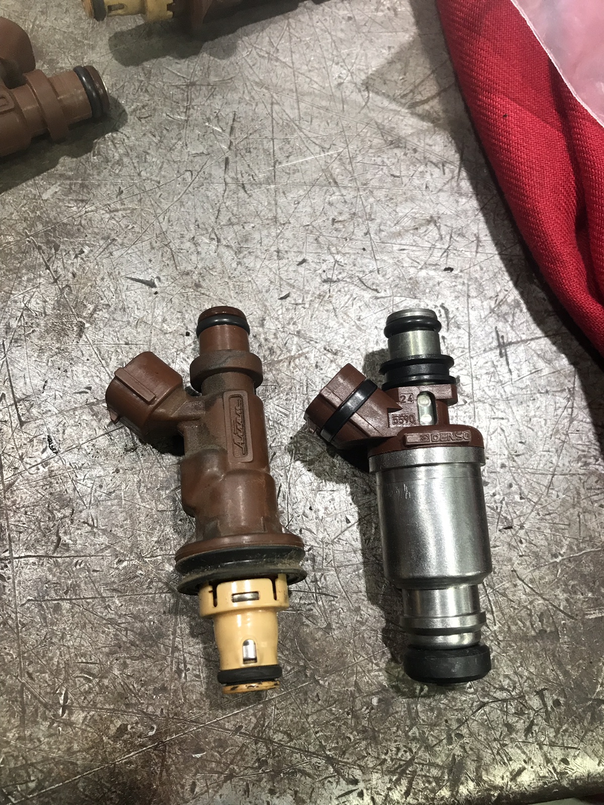

Hello there.
I recently did this and went with the 46030 set
The drivebility is amazing!
Here is what I did to make them fit

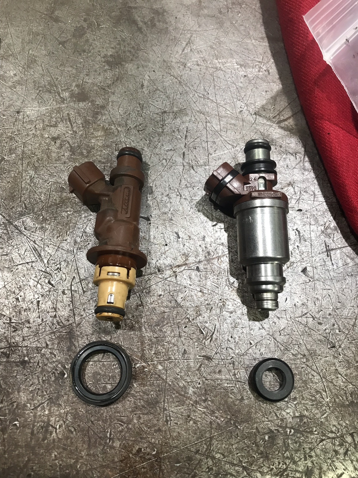

Remove the lower seal from your original injector
Swap it to the new injector on the bottom
It’s not an injector o-ring I am referring to. It’s the lower seal thing

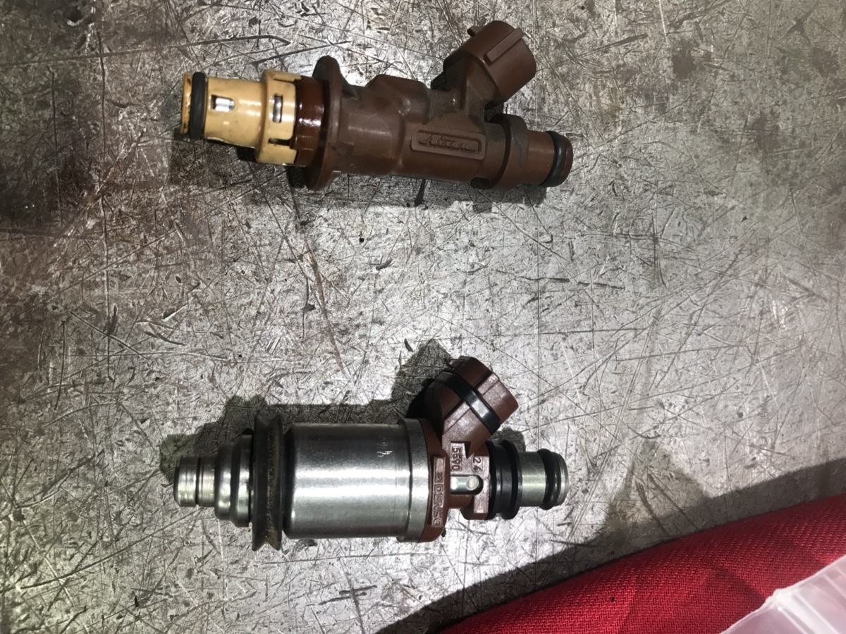

Here is each injector side by side. Original is on the left, new ones on the right
Both with seals removed

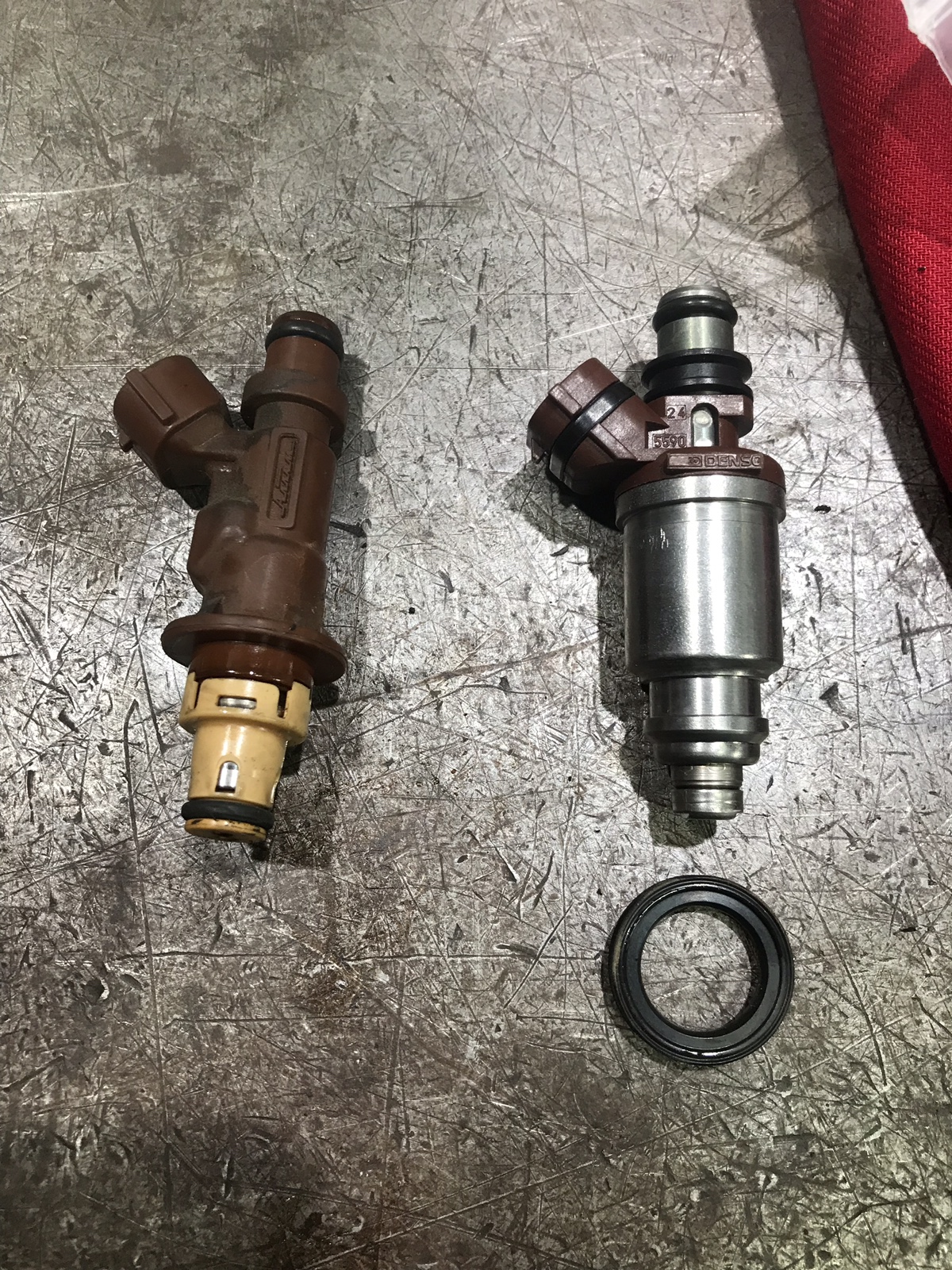

Swap the seal from the old one to the new one

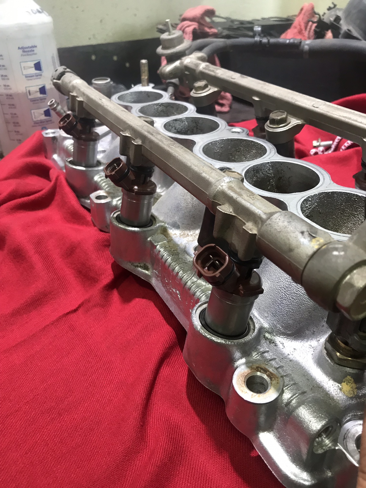

And this is what it will look like when it’s done
And they fit like a glove
