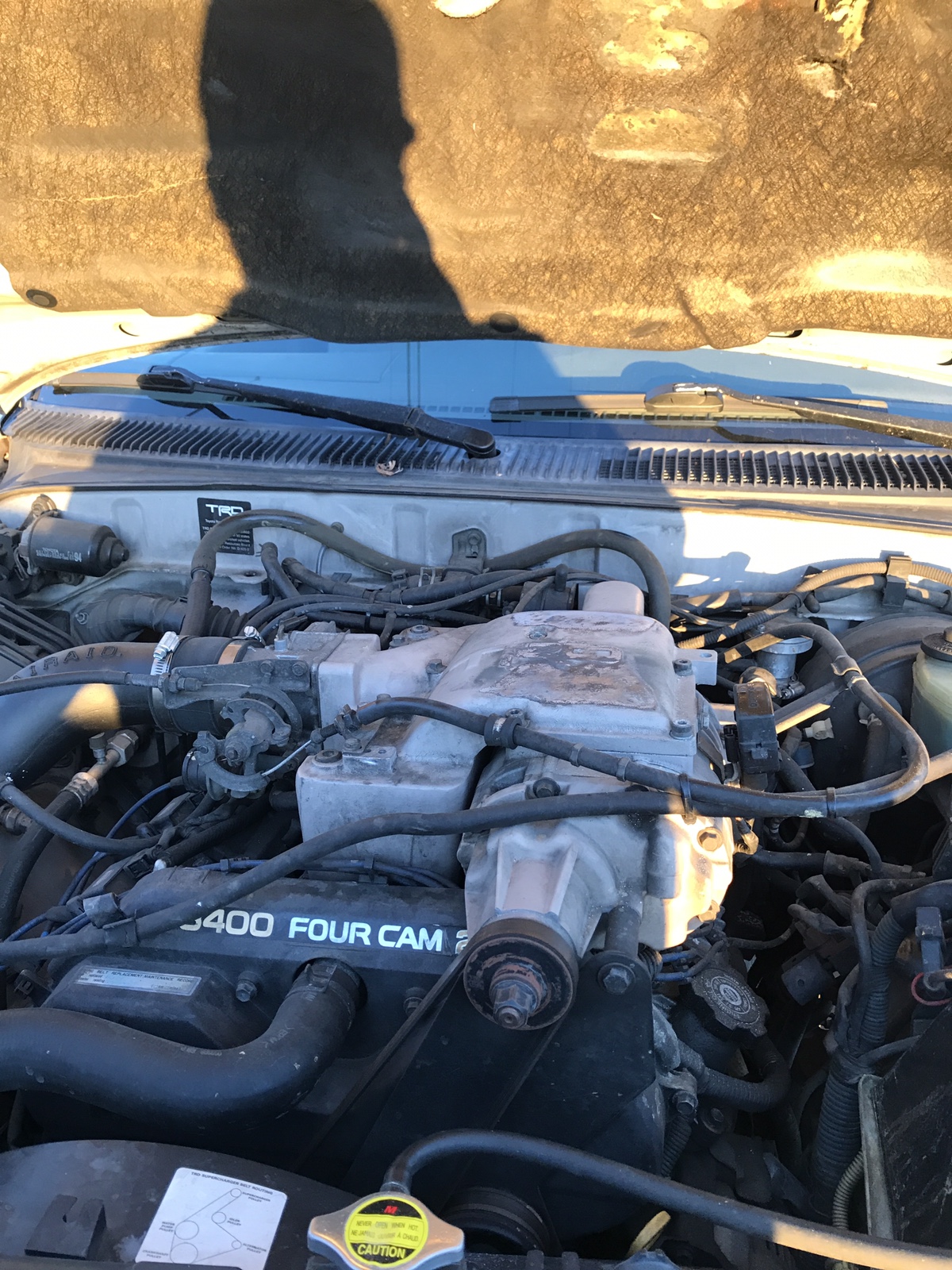

I am on the fence about buying this 4runner. The price is low enough where I can buy it and fix it. I am concerned with the portion that is circled in the picture. Is it a real concern?
Btw the supercharger was installed by the dealership at time of purchase. It got rebuilt about 4 yes ago according to the owner.
It is a common leak area. It looks like someone tried to reseal it without removing it.
Try removing it. It’s a good time to check if the little valve on the elbow is working properly.
One side is sealed and one side has an o-ring. I bought a protec oil filter #146 and the smaller o-ring fits perfectly around that area you will need
Other side uses sealant
Someone can correct me if I am wrong
