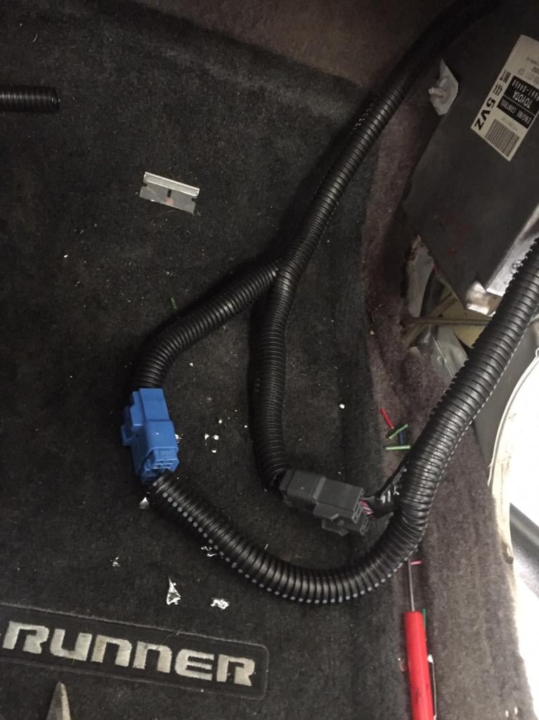

Completed the wiring harness on the URD harness kit this morning. I went this way in case I ever need to remove it, and it was easier to work on outside of the car.
Just need to clip the zip ties off and its ready to go.
Nice!! Was literally getting ready to cut my harness tonight when someone told me about this new harness extension. Will be ordering this ASAP! Did it come with good instructions on how to use the harness extender?
Soldered ten+ connections into the ECU harness while in the car... that was a tremendous pain in the ass but also a one way ticket, (with questionable penetration). Wish I knew this was available last week before I installed mine.
Wish that was available 10 years ago when I did mine

I made mine removable on my own. Digging around the junk yard I found 2 sets of mating connectors, of different colors. So plugging matching colors in makes the URD installed. Other way to remove or bypass URD unit.
This method became incredibly tricky however... 6 wires came from the harness to feed the URD (crank, cam, 02 intercept, power, ground and ignition tap) but only 3 wires came back from the URD back to the main computer (crank, cam 02 return). So going this route requires patience, planning and a good skill in the art of soldering.

No, it's just the patch harness. You have to know what pins and wires are the ones to tap based on looking at the ECU pins and connectors. An electrical wiring diagram is highly recommended for your year and trim level.
