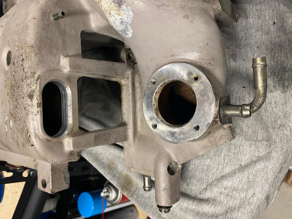

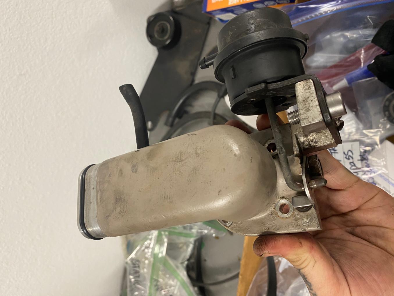

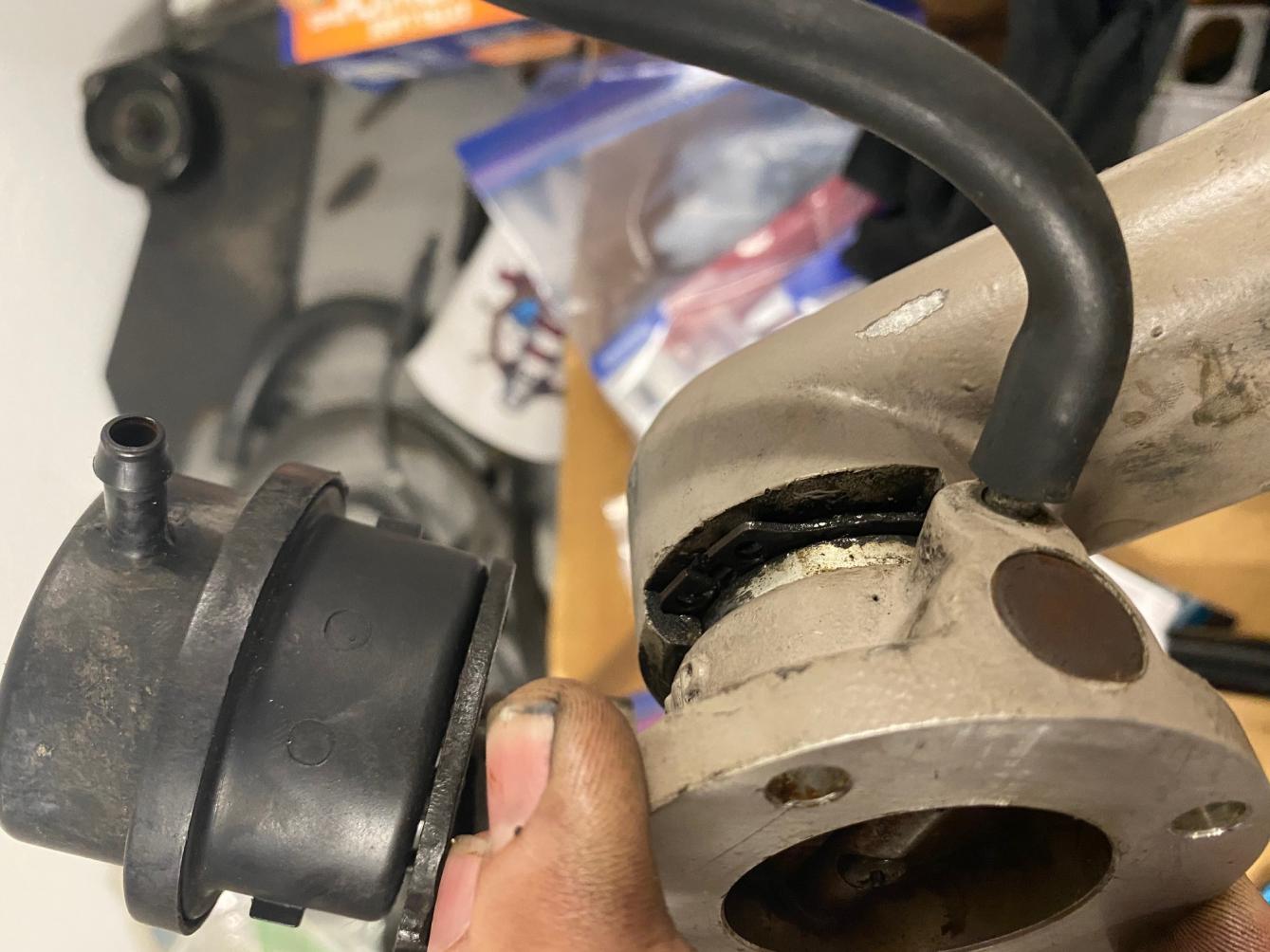

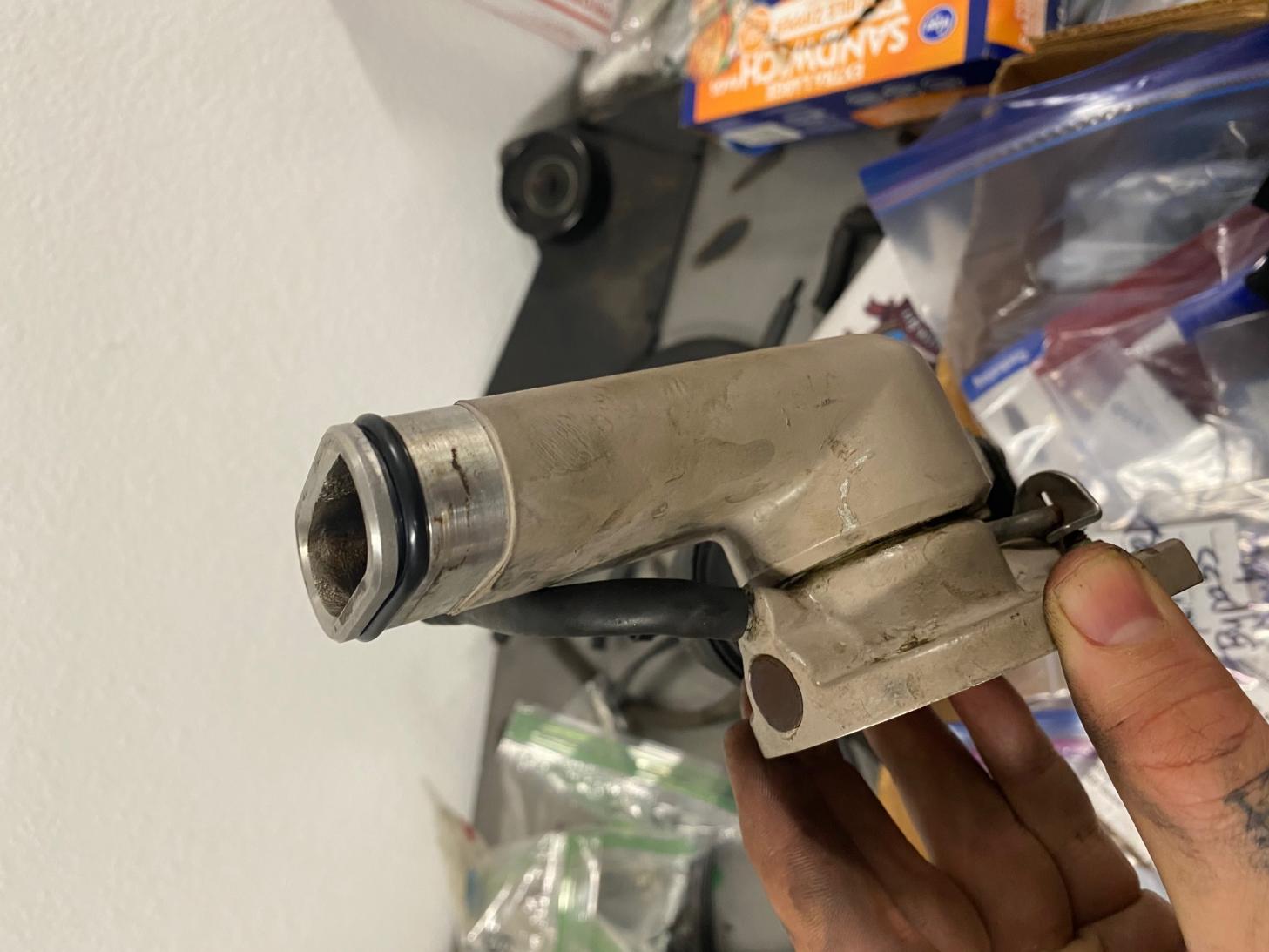

1st gen gray Supercharger question
In the midst of rebuilding this 1st gen SC. took the bypass inlet off the intake and replaced the o-ring. the rebuild kit i got came with 4 o-rings, 2 of each size. is there an o-ring under the arm to the bypass flange area? i see a snap ring and tried to use my snap ring pliers to remove it but no matter how much i spread the snap ring it wont come off and it swivels very easily. see pics. thanks in advance.
-John
