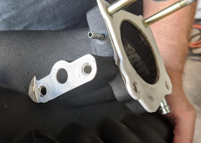

Well this is embarrassing...really embarrassing, but problem solved. Yesterday, my buddy and I removed the SC to make sure it was properly seated and that no hoses or wires were pinched beneath it. After staring at the intake-less engine for a half hour and running out of things to check, my buddy noticed the giant vacuum leak culprit. The used SC I purchased was missing the two bolts and plate that covered the 7th injector port located just downstream of the throttle body. We plugged it and it fired right up. I can't believe I missed that. I checked the hoses and gaskets 15 times and never saw it. Anyone know what parts to get to properly seal it off?

Well this is embarrassing...really embarrassing...after staring at the intake-less engine for a half hour and running out of things to check, my buddy noticed the giant vacuum leak culprit.

Glad it's solved. Just make one out of a piece of metal and cereal box (or gasket material). It's not crucial to be exact. Or contact Magnuson. They may have it.
ummmm NAILED it! (Way back a few posts ago)
Yea, you were right. Thanks for the help! Vacuum leak definitely made sense, I was too ridgid in my thinking that it had to be at a vacuum hose/port or gasket and I didn't even know the 7th injector port was there.
If looking for the part name, it's the EGR port blocking plate. 7th injector does use that same spot though. Any rigid piece of plastic or metal will work with a DIY gasket (you can buy a black square of gasket material and cut to size).
Thanks everyone for the info on the EGR port and how to seal it off.

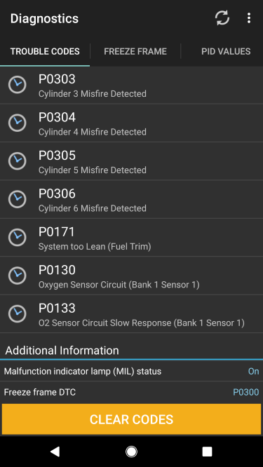

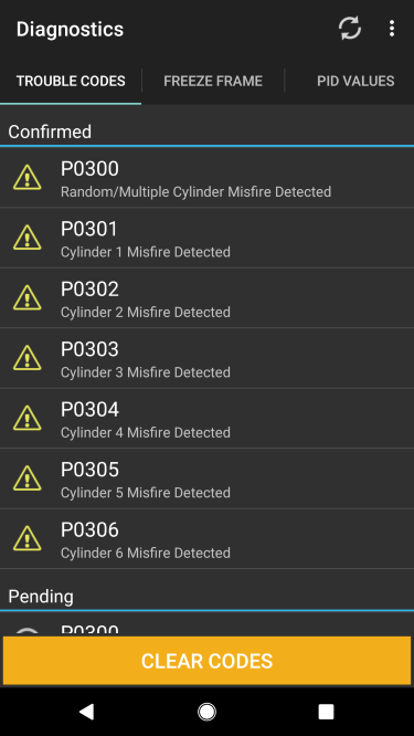

Unfortunately, I don't think I am outta the woods quite yet. We fixed the vacuum leak Saturday and drove it around a little. Idle was a little rough but not terrible and it threw the codes shown in the attached pics (the bottom pic is pending codes). At higher RPMs it seemed fine. So Sunday I cleaned the 2-step colder plugs and re-installed and cleared the codes; they were initially installed with the SC but later removed to troubleshoot. I figured this might solve the misfire codes because the plugs that I removed were pretty dirty on account of the very rich fuel mixture that it was trying to burn as we tried to figure out why the engine would not idle after SC install. Unfortunately, that didn't keep the code from popping back up Sunday when I drove it around more. I cleared the code again and drove around on the highway for 20+ minutes and no code. As soon as I got off the highway and sat at a red light, the codes returned. It's still less smooth at idle, not exactly rough, and idle RPM is ~500-700 which is lower than it ever was before.
Did I fry my O2 sensors or cat when I ran it rich with the vacuum leak? New wires and one new coil in March. When I search for others having similar issues, I only saw one person on Yotatech who was getting misfires on every cylinder, but that thread petered out. Everyone else only has a misfire on one or two cylinders. Would injector cleaner or a Seafoam treatment help? Or do I just need to run it more to burn some crud outta the exhaust?

Wowzers, that's a lot of codes Batman!
Double check all the sensors you unplugged are securely connected. Also ensure the coils are connected securely along with the spark plug wires. I agree on giving it a nice long drive, that's way too many codes popping up to try and diagnose it. You shouldn't be throwing a P0301-P0306 AND a P0300.

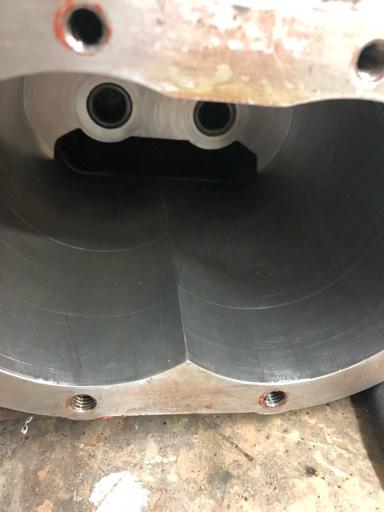

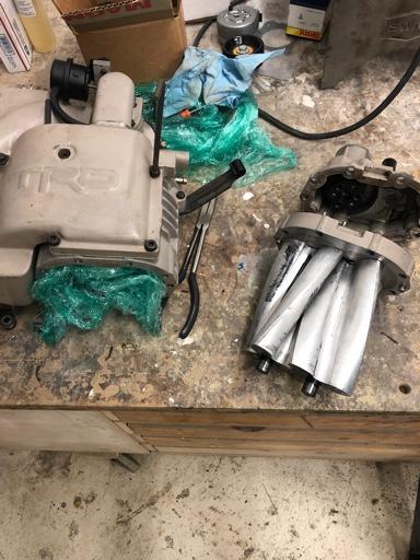

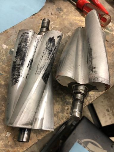

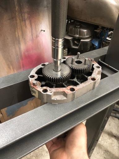

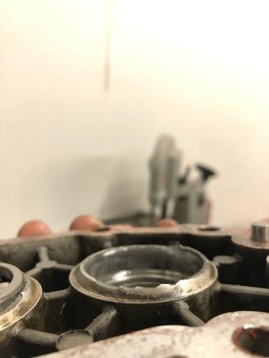

Sorry to derail the troubleshooting, but I wanted to share my current saga and a lesson on why not to press in bearings crooked.
I picked up a used 1st gen supercharger from a member of this forum a year ago for $350. He said the rotors had begun contacting each other. Him and his buddy were troubleshooting it and had even been sanding down the rotors (WTF???) but just couldn’t figure it out.
So I bought it, bought some new rotors from Jon Bond and let it sit for a year, focusing on other things for my build. Finally decided to dive into it this weekend, take the nose off, press out the rotors, then remove gears, then I’m pressing out the bearings.

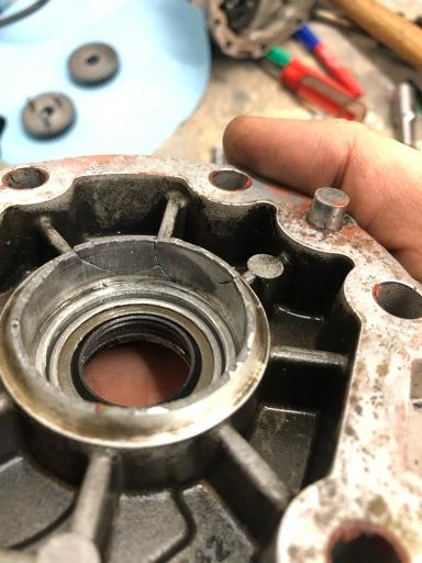

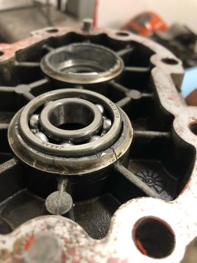

One of them is taking a lot of force, finally it pops. The other one presses out easily.
As I’m inspecting the cups I noticed jagged edges on what should be a smooth surface, and then I see massive cracks all where that stubborn bearing was pressed in.
They must have jammed the bearing in so badly sideways that it cracked the housing and caused the rotors to be unstable, contacting each other and gouging the interior wall of the supercharger.
Pretty sad worksmanship by the seller. On the one hand I’m disappointed that this wasn’t disclosed, but judging by the fact that there is sharpie all over the rotors from where they were marking and sanding, I’m guessing they never thought to check the bearings. I’m hopeful this was the only issue with the supercharger and that the gouging won’t cause much of a drop in boost.
Last thing - I called magnusson to try to source that replacement part. They had no interest in helping, referred me to a company called Supercharger Rebuilds. Those guys said they “aren’t allowed” to sell me that individual part and I would need to send it in for a stage 2 rebuild and they would replace the majority of my supercharger with gen 2 parts. The cost? $2k! Screw those guys.
Then I hit Jon Bond’s site, feeling pretty defeated, and lo and behold they sell that part for $200 and have 999 in stock! You the man Jon Bond!
Ok, I think I have the misfire royal flush fixed. First, I replaced both O2 sensors and that helped. It ran smoother and seemed to have more power but it still didn't sound right at idle and, eventually, the misfire royal flush would return.
Then, most recently, I removed, cleaned, and re-gapped the IK22 spark plugs (from 0.032 to 0.035), discovered I had installed the Teflon throttle body gasket backwards, re-installed the EGR block plate I purchased from LC Engineering using the included studs rather than bolts and used fresh Permatex gasket material, also re-gasketed the IAC actuator with Permatex, and re-torqued all of the throttle body nuts/bolts and bolts securing the SC to the intake manifold.
After 3 hours and ~130 miles of driving, zero pending or confirmed codes.
