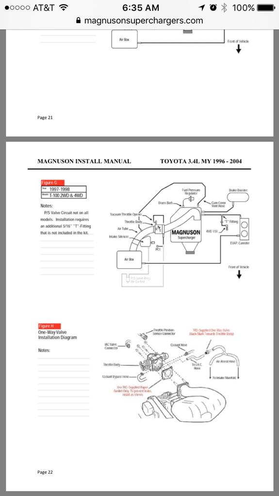

https://www.magnusonsuperchargers.c...uals/89-89-34-003_RevB_Toyota_34_Magnuson.pdf
Last page of vacuum diagrams shows it. It's grey'd out and includes a special note on the left regarding it.
It says for T100, but the early model 3.4's did use a vacuum valve. I think 96, 97 and maybe 98. I would not recommend capping it. It's designed for a reason and its only 2 connections. One goes to one of the capped ports on his now AIRRAID tube, other tee's into PCV. (One line before throttle blade, one line after throttle blade).

https://www.magnusonsuperchargers.co...4_Magnuson.pdf
I completely overlooked that vacuum hose diagram because it was for the T-100 but that's exactly how the PS vacuum lines were routed before; one before the TB and one after. I'm glad you were aware of this odd variation because I was starting to doubt myself. It will be easy to re-connect the pre-TB hose and I will have to figure out what tee I need to plug into the PCV hose.
Whoa, I totally missed that. I think my screen doesn't show that grey very well (or my eyes are going bad!). 4Runners with the power steering vacuum hoses must really be a unicorn if even TRD doesn't show them with it.
A 5/16 T fitting can be had at a hardware store (look under the plumbing section for a barbed fitting) or plastic ones at auto parts stores.
