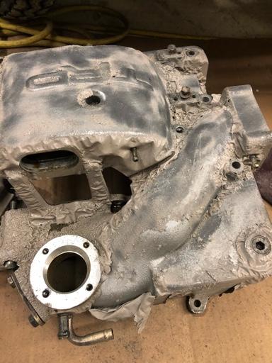

Here’s a reminder of how it looked after my first round of paint stripper
I’ve spent the last few weeks working off and on stripping that nasty beige enamel off my supercharger. 0/10 do not recommend - that paint is stubborn.

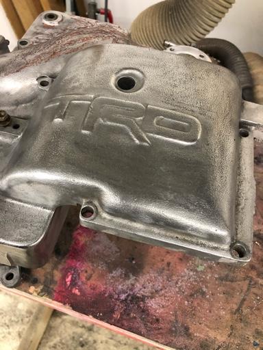

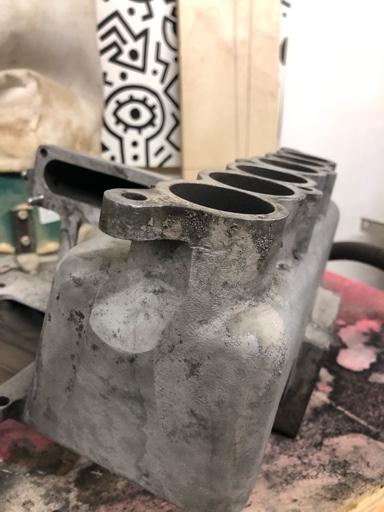

I’ve tried lots of things - 3 different kinds of paint strippers, I’ve sandblasted 100 lbs of aluminum oxide at it, various wire wheels, steel wool, you name it. It’s been an interesting experiment though I’ve poured way too many hours into it.
Here’s how it looked about midway through

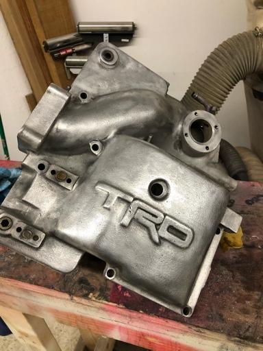

Here’s how it looks now
I don’t think I’m gonna be able to take it to a mirror finish, which is fine - it’s been a a good way to practice some different polishing techniques. I can’t get all the paint out of the crevices of the nose cone and couldn’t polish it anyway, so I’m just gonna paint it red.

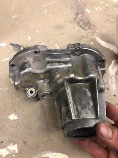

Now I’m trying to really flush out and clean the inside of the largest part a few pics back (that mounts to the intake). Since I sandblasted it I’ve had aluminum oxide particles all caked up inside and I REALLY don’t want that in my engine.
Got it pretty good today using goof off graffiti remover inside and spraying out with a hose. I feel like it needs a good soak in simple green and near boiling water to get any remnants out.

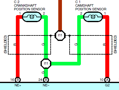

Hey [MENTION=127339]4Reak Show[/MENTION], can you recall where you grabbed the RPM signal? I also bought a 30-4900 and unwisely had a shop recently install it. All seemed fine until one day I turned the key on with the engine off and heard an odd new sound. Went to start the engine a few moments later only to find it was flooded out. Yup, I discovered that the UEGO is apparently loading down the impedance of the crank sensor ECU input and causing the injectors to fire when the engine is off.
I've yet to look to see what he tapped into (pin 24 maybe?); but have verified that with key on, engine off, wideband connected - injectors fire. Disconnect wideband, they stop.
I've reviewed schematics and it seems the only place to tap the RPM signal is at pin 16 (red wire) of E10 at the ECU. I may be mistaken; but It doesn't seem to be available at the gauge cluster. The crank sensor cable is shielded, while the AEM RPM input is not. Could that be causing an issue? Thanks in advance.
Sorry dude, I didn’t hook up to an RPM signal so I can’t help on your quest.
Maybe contact AEM?
