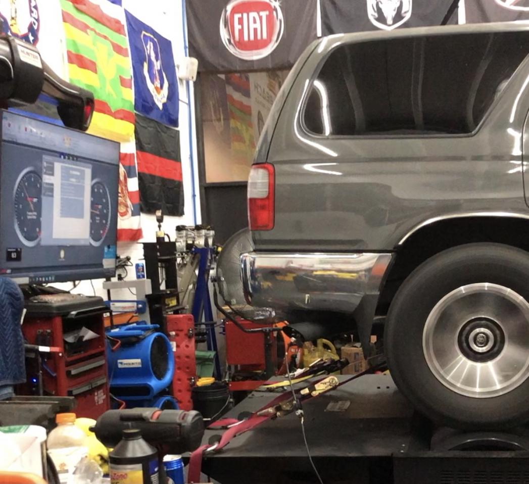

Nice! Hey a couple of dyno questions for ya as you and I are some of the rare people who have stuck a 4Runner on a dyno in the past 10 years.
Do you have an auto or a manual? I have an auto and couldn't get a good 3rd gear pull where the final drive ratio is 1:1 due to the speed governor cutting fuel at 107 MPH, around 4800 RPM. Did you encounter this issue?
Did you get a lot of pushback of "oh we don't do Toyotas" when trying to find a dyno? Shops were turning me down even for just a plain ol dyno run with no tuning sessions.
I have auto. I honestly have no clue. Just from observing nothing really significant until she went into 2nd then cut out at about 5700/5800rpm...dunno what the mph were.
Haha....yah there isn't a lot of shops on island with a dyno to begin with and most of the shops are picky about what cars they do. I got lucky and made friends...the guy who did mine mostly does Hondas but took on my project for a little more than he charges the other guys.
Any printouts of the dyno run? Always fun to see a supercharged engine torque curve.
Nah unfortunately I didn't. Was last run of the night...like 930 so told him just concentrate on the tuning.
I'll probably try dyno again later. Plan on researching headers installation, porting my cylinder heads, and trans cooler installation.

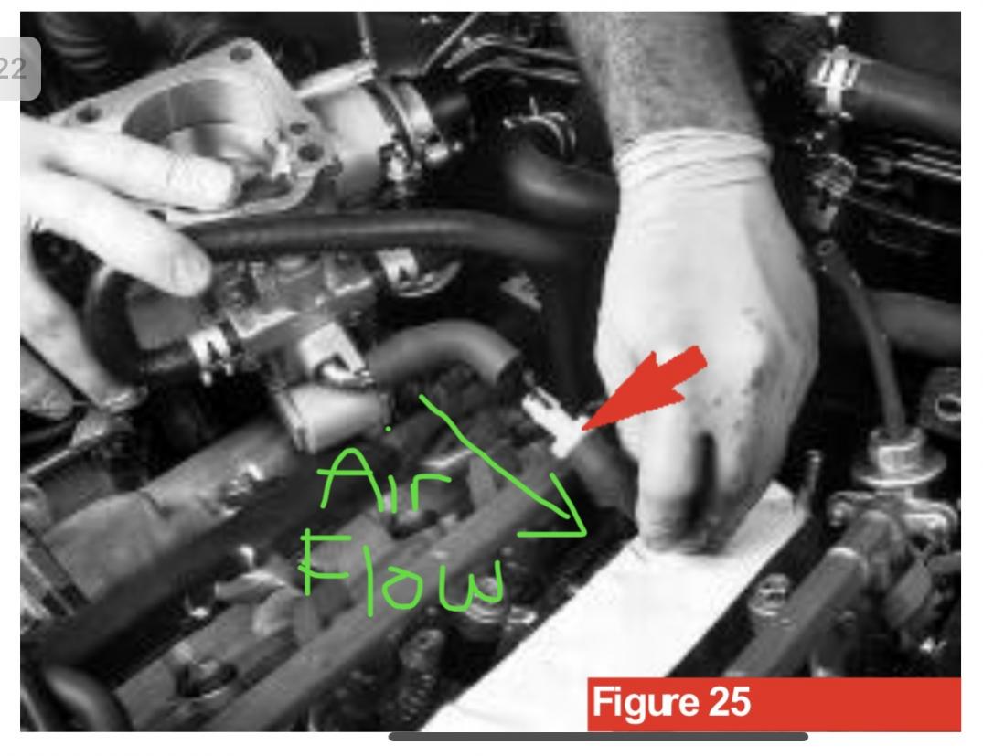

Can someone confirm this check valve direction? Is what I have pictured correct??

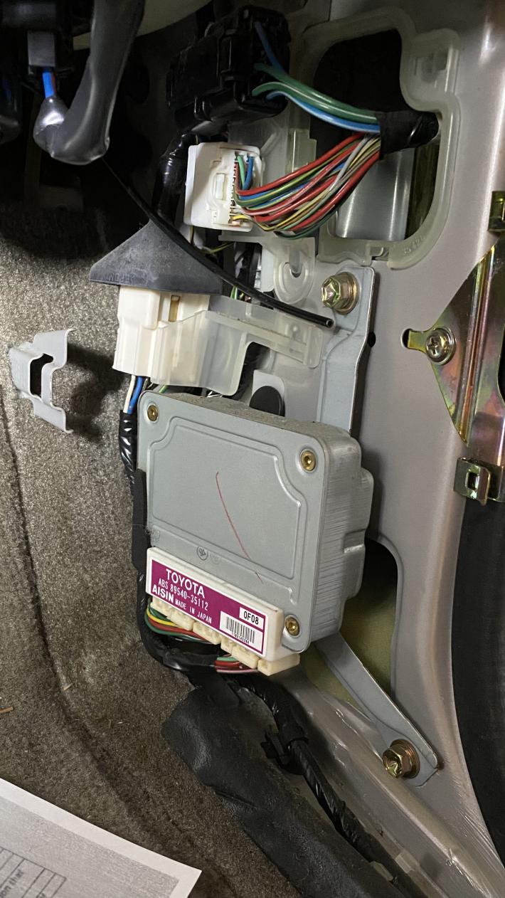

Where is everyone installing their 7th injector AIC? I was going to install in the kick panel, but there is something in the way.
